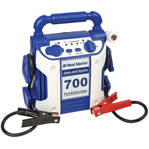

Here is my 12 Volt source, USB charger, portable dingy pump power source, emergency engine Start battery, 12 VDC battery charger, emergency light, etc.
https://www.westmarine.com/buy/west-marine--700a-jump-starter--15808504?recordNum=4
On special from time to time $49.
I carry one in my car too, no more jumper cables.
I have lent it out at the marina, more than I have used it.:biggrin:
Jim...
PS: It has a 12 vdc thingy plug in too.
PSS: With a small inverter, makes great toast too!
