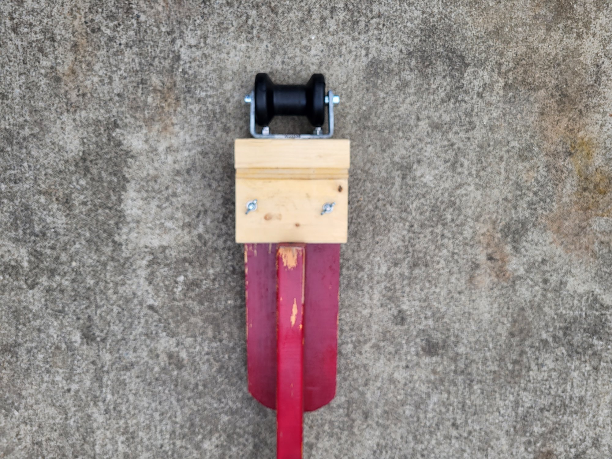

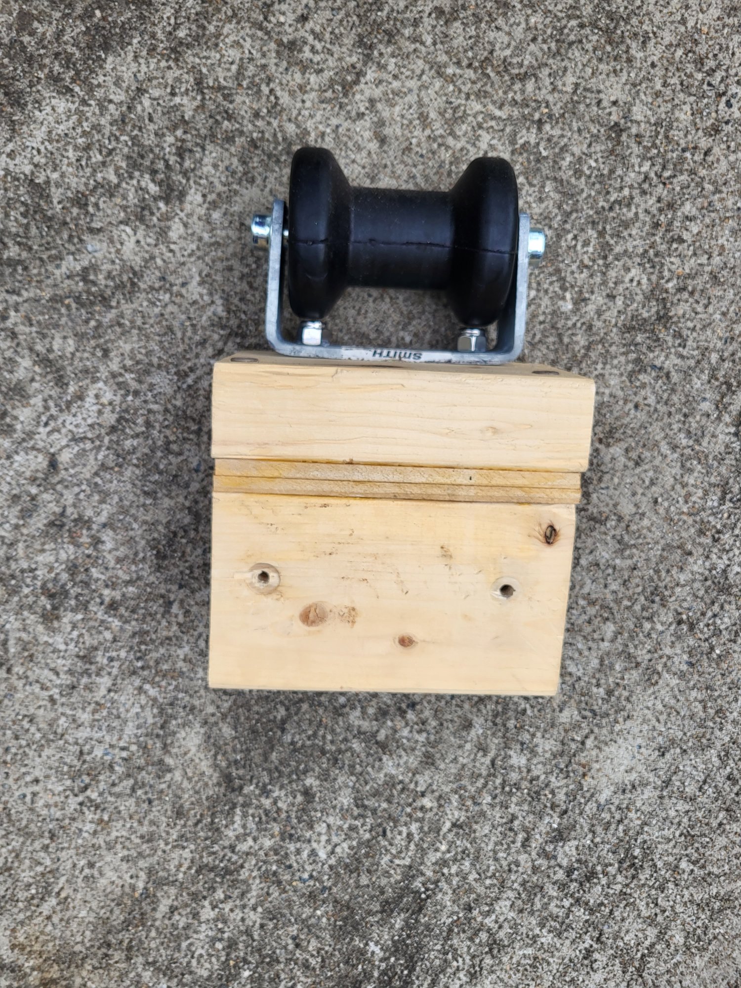

  • Mariner has a hinged tabernacle which raises the mast from the stern. The Mariner has a 25ft long mast on a 19ft boat, so the mast is almost balanced when in the tabernacle and sitting on the mast crutch mounted on the rudder gudgeons. So care is required when moving the mast aft to insert the mast base into the tabernacle. I installed a removable trailer roller on top of the mast crutch to facilitate moving the mast fore and aft from/to trailering position from tabernacle.

  • Attach trailer roller to mast crutch. Place mast on roller.
  • Roll mast back, and place base in tabernacle

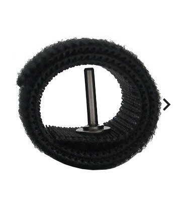

@pgandwIf you loosen your shrouds when raising the mast and then tighten them again, do you use slip rings to lock them in place? I think just installing and removing the slip rings would add frustrating hours to the set up process. I thought about tensioning levers, but haven't done that yet.
You are correct. When I bought my boat, three turnbuckles had CS Johnson Hook and Loop Locking Wrap Pins installed. The first time I set up the mast with split rings or cotter pins on the remaining turnbuckles, I said I have to get some more of these. Finally found them at Defender Marine. Spendy at $12/turnbuckle (2 velcro locking pins), but absolutely worth it IMO.

Using the Mariner Class recommendations has made a big difference in my sail trim. Forestay and jib no longer sag off in decent winds. Settings are measurable and repeatable. Did I say how much I hate split rings and/or cotter pins?
