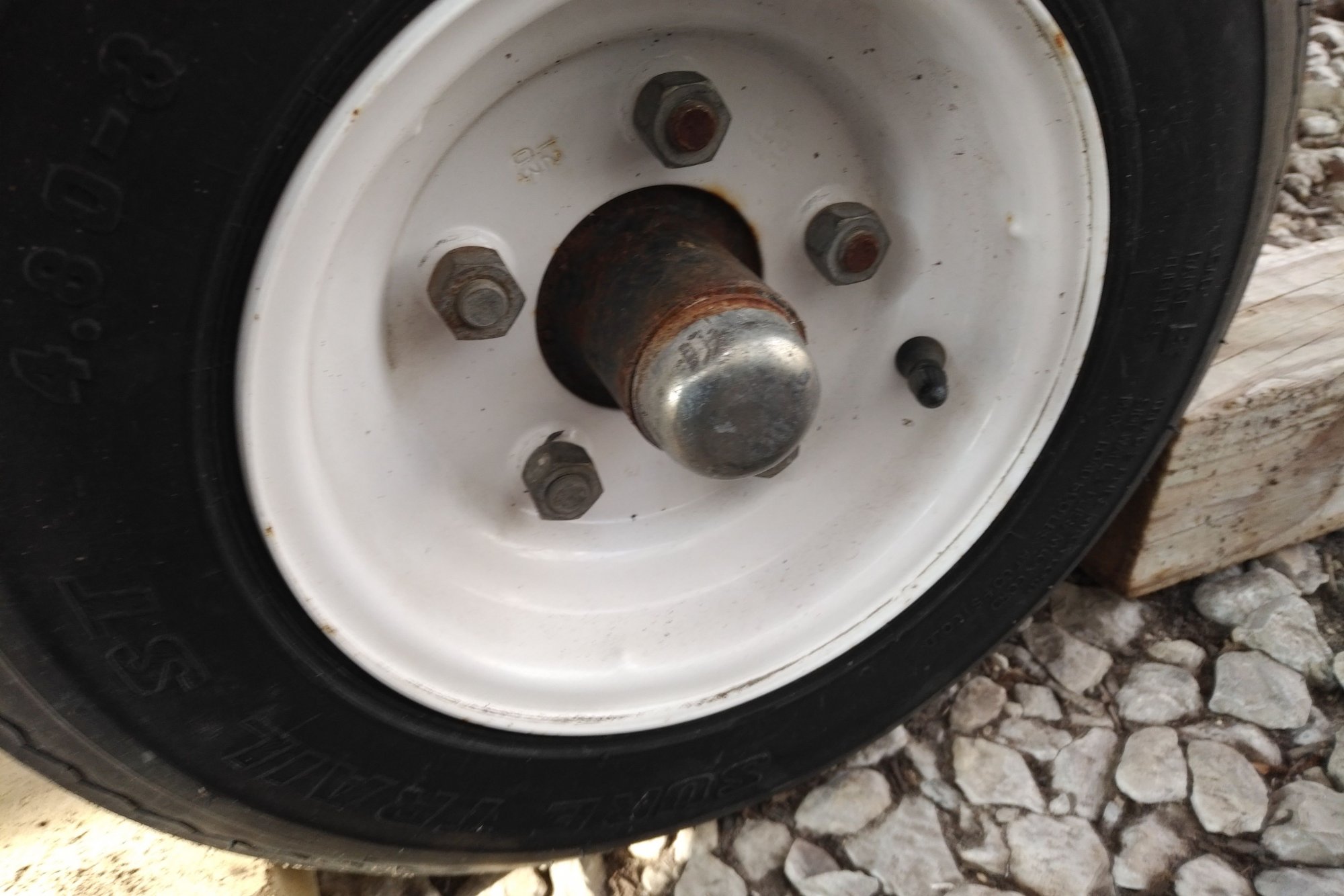

The wheel bearings on my trailer make a horrible noise - likely in bad need of grease. The caps are rusted on tight - penetrating oil and tapping and nothing can get the cap to budge. Any secrets I'm not aware of, or should I destroy and replace the cap?
S
sbrogden
Destroy and replace the caps. They are a consumable and should be replaced anyway.
Thanks. I got the cap off, it's destroyed. Now I am puzzled.
Axle nut and washer behind it are off. The bearing housing will not move off the axle. Tire is off. Can't see anything holding the hub on the axle but it will not move - other than rotate.
S
sbrogden
Thanks. I found a video that was helpful. Used my dead-blow hammer to beat on the back side of the hub and it finally came off. After lunch I will take a close look at the bearings.

Once you wrestle the hubs off and replace the bearings, replace the caps with "Bearing Buddies" to keep the new bearings in good shape.
One bearing inner race may have rotated on the spindle, making a groove which will make it difficult t get the hub off. That spindle may be unusable because of that.. although, some trailers have easily replaceable spindles ..

Thanks for the note about the spindle - I'll take a close look. Rotating by hand the noise is very bad.

... and use silicone-based or lithieum-based grease sometimes marketed as "water proof" grease. You can get "marine" grade grease but you will pay an extra $5 for the word "Marine" on the lable.

I sir congradulate you. You solved a potentially very bad situation before it became so much worse. Always better to replace stuff at you own pace in your driveway than the side of theinterstate in the middle of the night . Especially during a storm... ask me how I know ..

I bought lithium grease and new bearings for the left side. Installed. Bearing Buddies and new bearings for right side on order.
