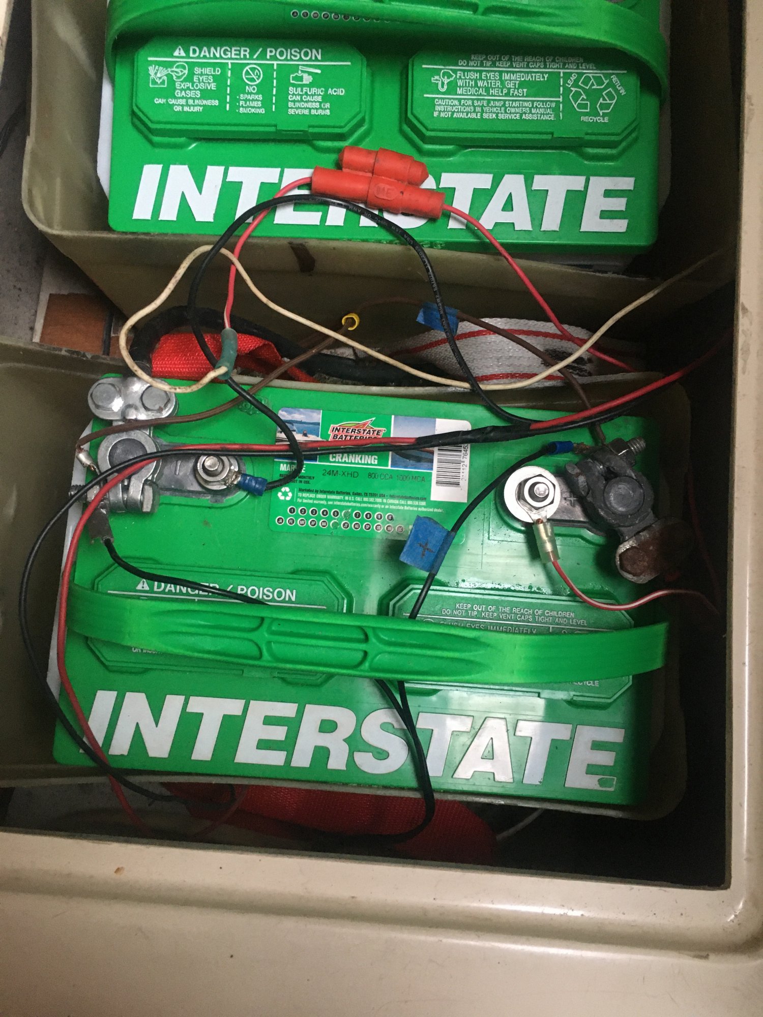

Batteries: 2 Interstate Marine Cranking, 2 years old
Charger: very old would be my guess:
Shoemaker: (10amp charger, 2 amp trickle, 50 amp engine start) model 1050PE

Yeah, so we’ve got some non-ideal things going on here. Those batteries, based on being for “cranking” are likely not deep cycle. So bringing them down in charge is really not healthy for their life span. With the 10 amp charger in the 3 hours you charged you put at most 30 amp hours back into the batteries, which isn’t really enough to build them back up. I am still curious as to what loads may be on the batteries over the week to flatten them, but if the batteries have reduced capacity because of being used as if they were deep cycle before, then it might not take much parasitic load to flatten them anyway.
I’d say to get a couple truer deep cycle batteries that will better handle being run down a little. You still can’t really run them down very far or leave them at a low state of charge, so you’ll want to check on the load situation too.

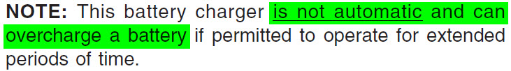

You really need to be using a smart "Marine UL Battery Charger". The Marine UL listing is critical as the article below will point out.
You are using an un-regulated constant current only automotive charger. Schumacher calls this "not-automatic" and there are numerous issues with this. The main one is that it's unregulated and will over charge your batteries if left unattended. The manual for this charger makes this perfectly clear.
Installing a Marine Battery Charger (LINK)

Battery cable? Looks like 10 awg?
I think the main cable goes off in the shadows on the lower right. It looks like there’s a heavy gauge black cable coming off the top of the left post. The smaller gauge wires do look like they could use some TLC though. I see a mix of red, black, white, and brown wires. Not much in terms of fuses. One of the black wires is connected to the positive terminal and labeled +, which makes me uncomfortable. Also, I really hope I’m missing something in the shadows but it looks like that brown wire runs from the + to the -. So I guess as long we’re making recommendations on updating the batteries and charger, those wires probably deserve some attention as well to prevent other problems down the road.
