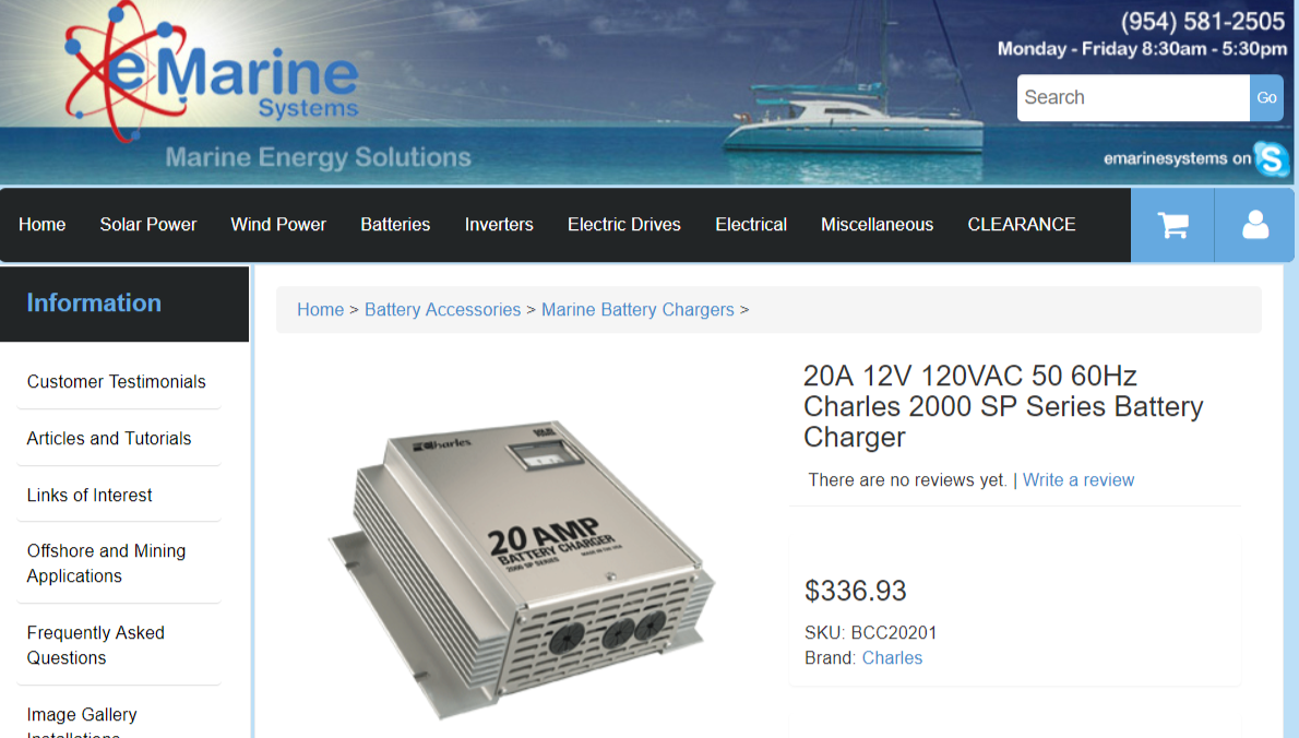

Emarineinc reportedly sells an in-kind replacement. However, if you want to spend less you can source any number of good quality chargers and even have an electrician install it for less than the difference.

Wow that was fast!! Was it the Charles 2000? Do you need the online manual assuming I can find one?

Yes it is the Charles 5000 20 amp 12 volt. If you can find the manual that would be great! I just read that someone said these chargers fry batteries...I hope that’s not the case. I appreciate your help.
