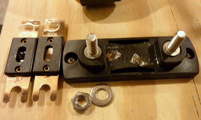

Please avoid the use of no-name ANL fuses that are not IP rated. You also want toavoid them because they may not even be a true ANL in terms of trip-delay curves. They may actually trip near instantly when trying to handle motor in-rush loads.
The Blue Sea ANL product is the only one we tested, on dead short circuits, that has not failed in an unsafe manner. For the ABYC High Capacity Battery Committee we tripped close to 100 different fuses and every single one of the elcheapo "auto stereo grade" fuses failed in an unsafe manner by blowing the crappy window right out of the product. Not a single BSS fuse did this.. You get what you pay for with ANL fuses.
If an ANL manufacturer can not provide an IP rating and a trip delay curve for the fuse walk away..
