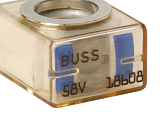

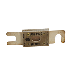

BUSSMAN - 250 Amp ANL Wafer Fuse and Napa Fuse Block Terminal 80 Amp . These are what I was looking at. It's a bitch trying to get anything here in Toronto CAN. Shipping from the US is outrageous.
View attachment 163878 View attachment 163880
All these fuses are available in Canada ,ANL and MRBF, MRBF are usually hooked up at the battery ,there by protecting the cable going out from short circuit. All are available with free delivery and bluesea buss bars ,ANL holders,ANL fuses, MRBF fuses and holders from Binnacle.ca 2 day delivery ,also available on amazon .ca

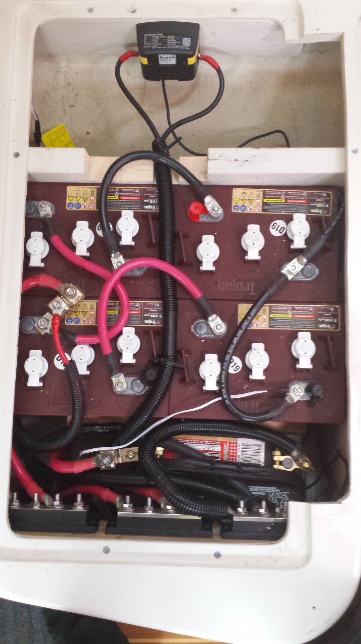

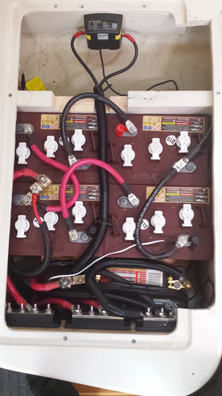

Looks like you are putting the starting battery port side of the GC bank. Mine didn't look like I had the room.

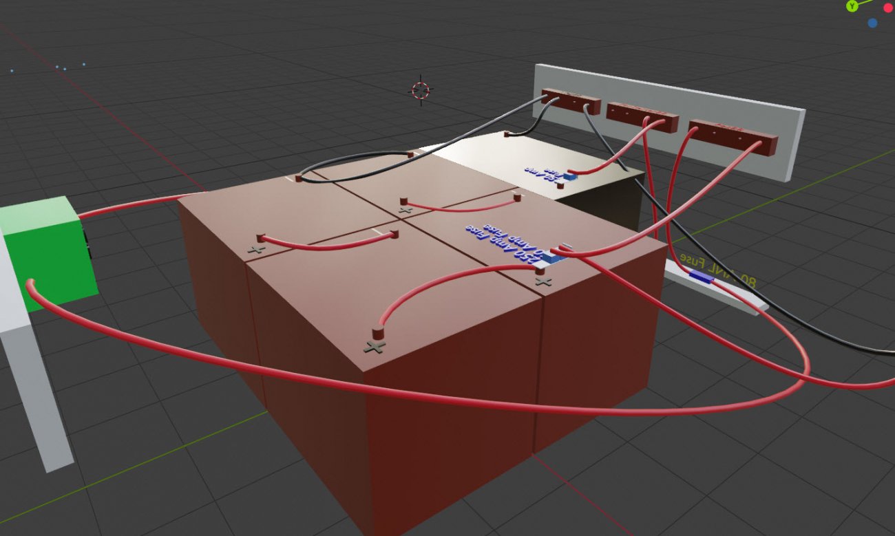

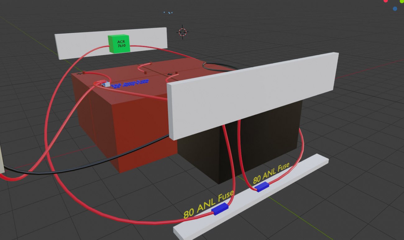

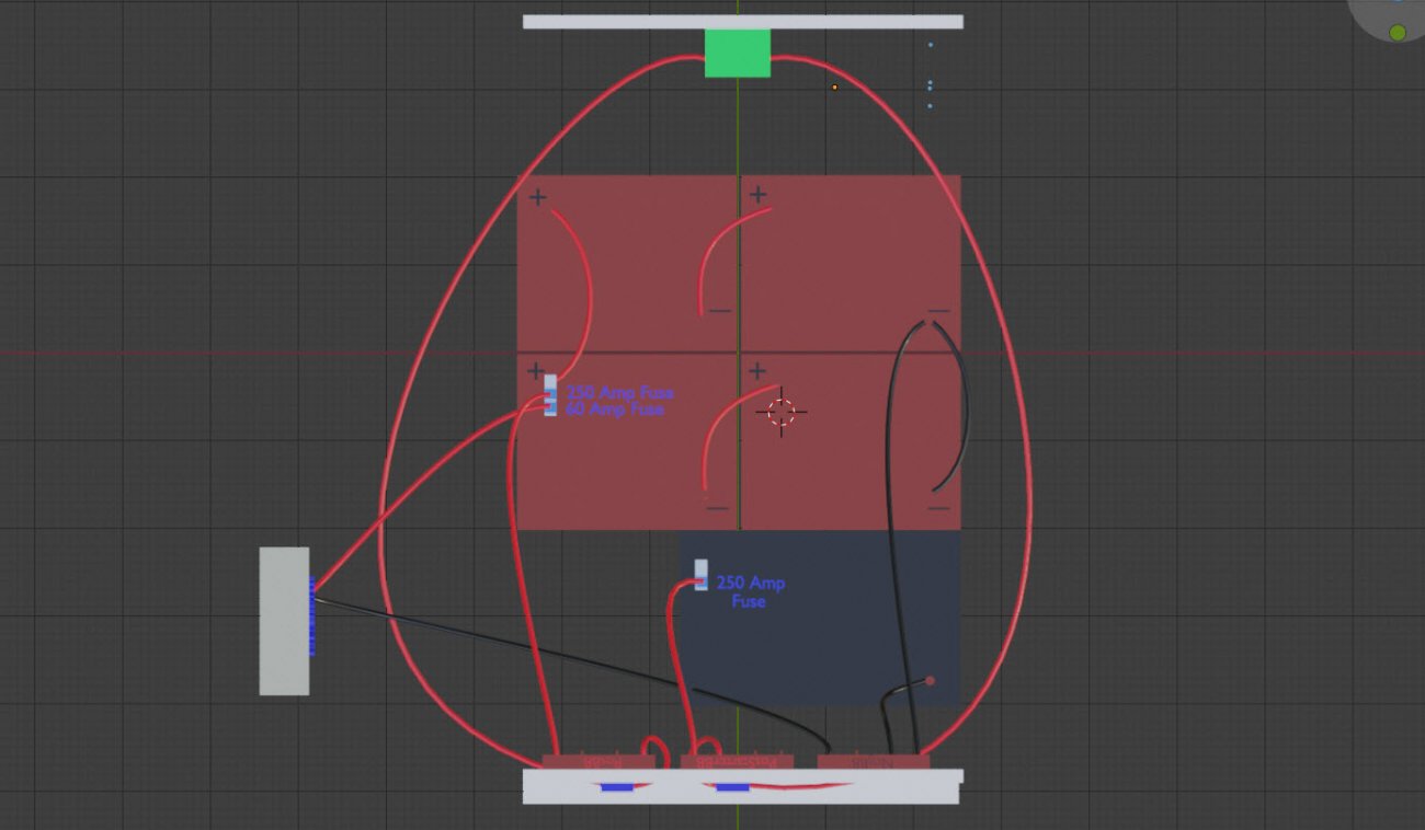

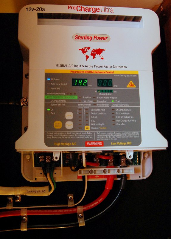

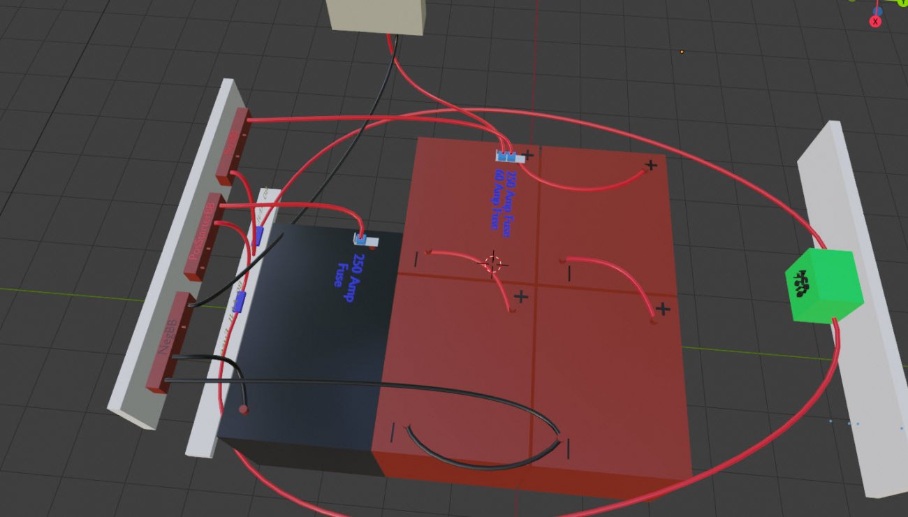

I have everything setup. I have 3 questions.

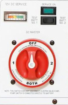

1. On the switch below where should it be dialed to when charging or does it matter?
2. This picture shows 2 jumper cables. Is this standard. Mine looks just like the picture below, except for the jumpers. I have an ARC setup.
3. Should the Charger and Fuse be connected to the Positive (House) Terminal Bus bar or
the Positive House battery terminal post as in the picture supplied.
May 20, 2016
3,015
1) assume you mean charging- not changing. If you have ACR it doesn’t matter if not Both
2) that is the mainsail recommended state per Maine Sail
3) go to the buss bar
Les
May 2, 2012
276
Catalina 310 Toronto, Ontario
1. Yes I mean charging.......... little typo. So it doesn't matter if it is on 1,2 or Both. OK
2. The ACR lines (both 80 amp fused) go to their Individual Positive Bus Bar Terminals - House Bank & Starter Battery.
3. Charger goes to the House Bank Positive Bus Bar Terminal.
4. Jumpers put as shown in supplied picture of charger.
Cheers & Thanks
