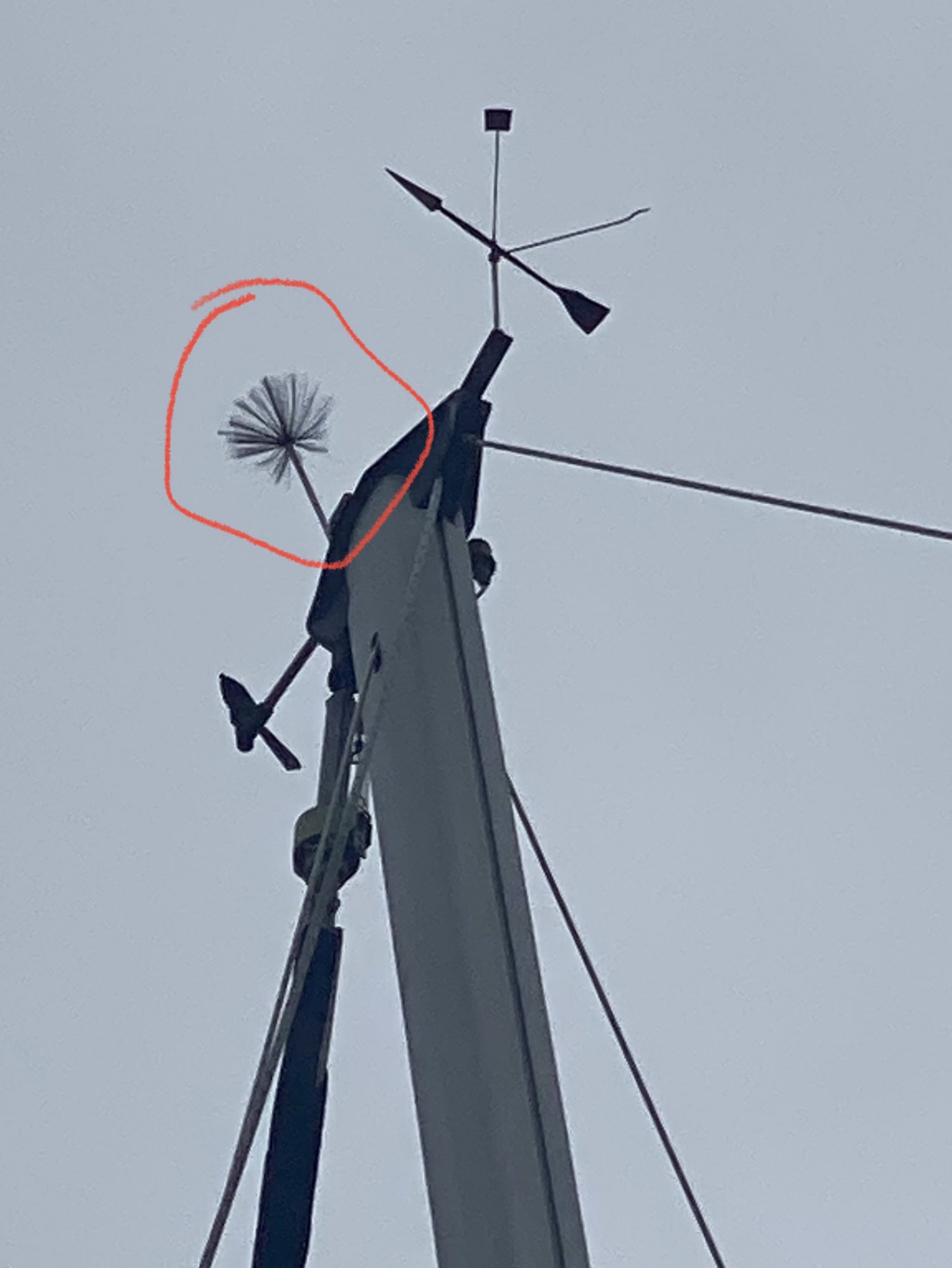

The article in post 3 is interesting because it discusses the futility of this type of device in dissipating charge. The idea being that if you can dissipate the charge in a particular location, lighting wont strike there. Lets say you could dissipate charge with the wire brush twice as fast as the ground could supply it. Fairly soon the charge would drop to a low level. But.. this is not at all the case and the paper put some numbers on this. In that paper, salt water can actually supply charge 200 thousand times faster than the wire brush can dissipate charge. Ie, this mechanism of protection is completely futile.
Good discussion on lightning get complex as you really need to understand electric fields. A couple papers at the bottom of this post discuss lightning rod improvement studies. Interesting because if you are in a marina, you want your neighbors sailboat mast to be a slightly more effective lightning rod than yours. The guys in the papers did lightning studies where they had a bunch of (I believe) 6m tall lightning rods on a mountain top in New Mexico. They varied diameter and blunt vs sharp. Its interesting that in this field of competing lightning rods, the sharp tipped rods never got struck while the blunt rods had numerous strikes.
If you buy a lighting terminal now, it will be blunt shaped. Many years ago, it would have been sharp tipped. While trying to dissipate charge is a futile effort, the papers discuss how electric fields and corona currents affect leader generation. They attempt to model why the sharp tipped rods were less competitive at receiving lighting strikes.

FYI, the wire brush will enhance corona current. There is a good description of how this works in one of those papers (I will dig it up and post it if anyone is interested) but the high electric field at the top of the mast will pull an electron from an air molecule leaving behind a positive charged ion. The ion floats away driven by wind and the field of the charged cloud. The electron goes into the mast where it will either charge the mast like a capacitor or flow to ground.
So the wire brush things dont discharge.. in fact they do the opposite. But.. that is also OK.
I would not buy one new.. but also would just leave it there. Who knows.. maybe it does some sort of very complex electric field modification that makes upwards streamer creating less likely similar to the pointy lightning rod. Who knows..Im pretty sure the wire brush doesnt do anything bad.

At the risk of sounding like a newbie, which of course I am. I would like to know what the toilet brush on the top of my mast is for
Thanks to all who have contributed. Some funny ones but also some really interesting and hood links. Lightning is one if those things to keep in mind as I have come across two boats so far that had lightning strikes. Much thanks to all. Zom-B out✌✌
