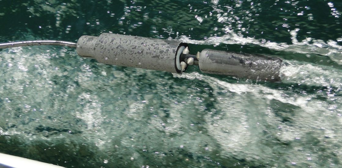

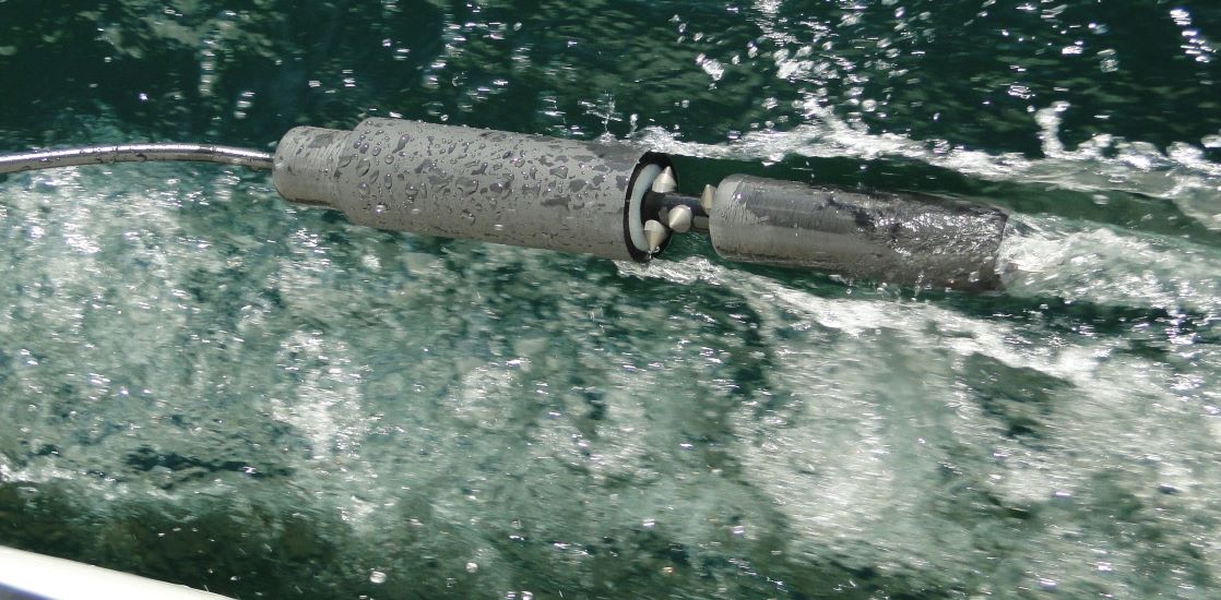

Curious if those standards differentiate between salt and fresh water? For example, the square foot dissipation plate at the bottom of the hull might work in salt water but would be pretty much worthless in fresh water.
Years ago when I did more sailing in Colorado and was around a lot of lightning, I had studied lightning protection methods and actually got a patent on a flexible down conductor to a discharge electrode that was kept at the water surface by floats. The last prototype before I abandoned the whole project is shown in the attached picture. Its a floating discharge electrode with four gauge wire back the mast. The four gauge wire attached to the mast passed by the side shrouds forming a spark gap to the metal shroud cables. The flexible wire and float (one on each side) kept the electrode at the water surface even when the boat was heeled while sailing. This used Dr Ewen Thomson's idea of the Siedarc electrodes which placed discharge electrode at the water surface where the strike wanted to go to in the first place. To sell something like this, I would have had to license Dr Thomsons patents. When I abandoned the idea (much better ways to earn a living LOL), I actually sold my patent to Dr Thomson but things went nowhere and a link in this thread says his patents have also expired. Its my opinion that Dr Thomsons idea of placing the discharge electrode at the water surface was the only method that would make any difference in fresh water.
The floating electrode was mostly intended for trailer boats where the mast is almost always ungrounded. Note that in the sailing to hell video, the guy said he had an ungrounded mast.
