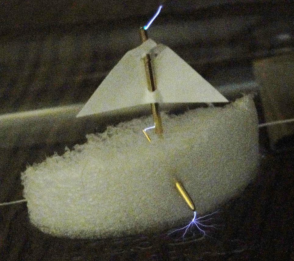

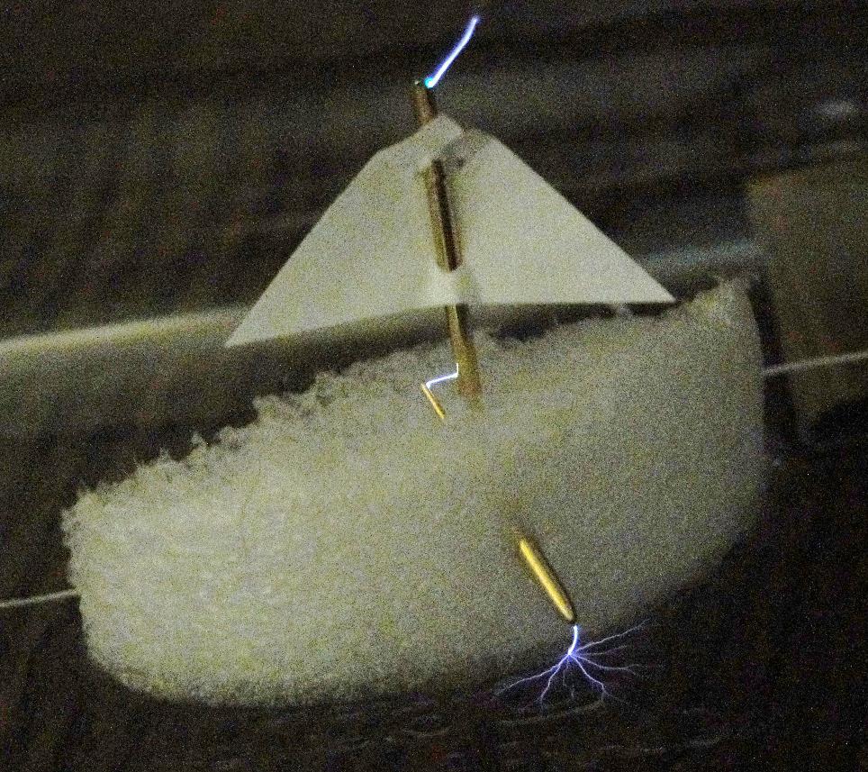

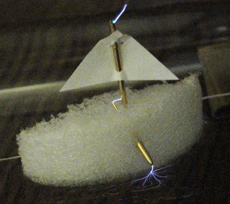

Here is a picture again that I took when messing with all that stuff a bunch of years ago showing the surface discharge in fresh water (our lab had an ESD tester, snuck in this test while at work). FYI, a discussion involving electric fields will explain everything happening in the picture.
