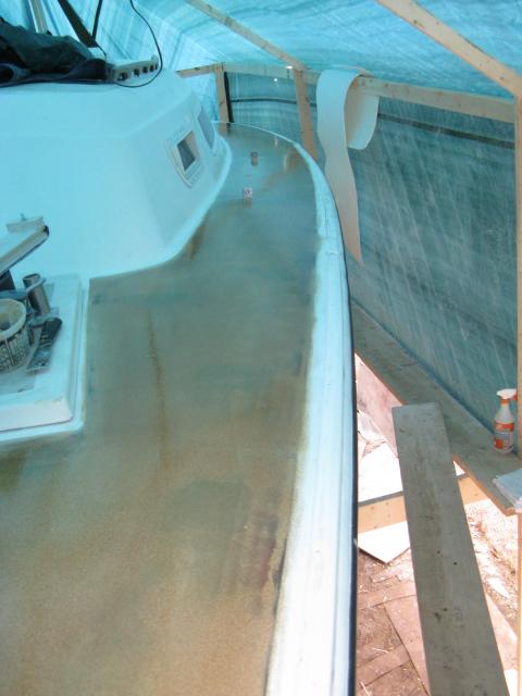

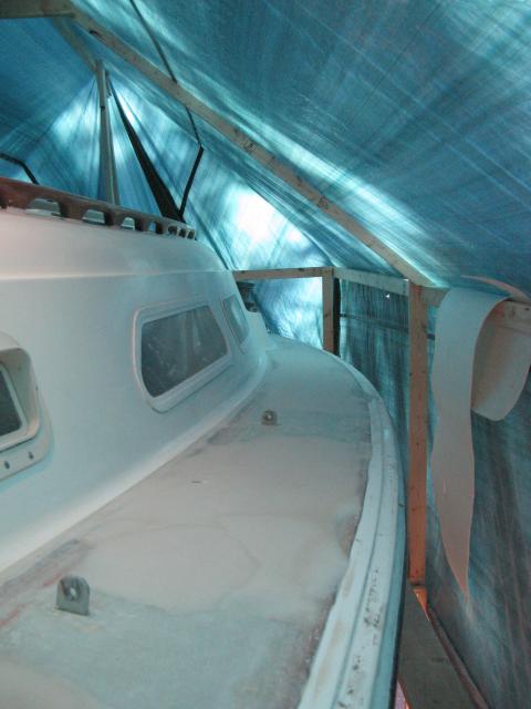

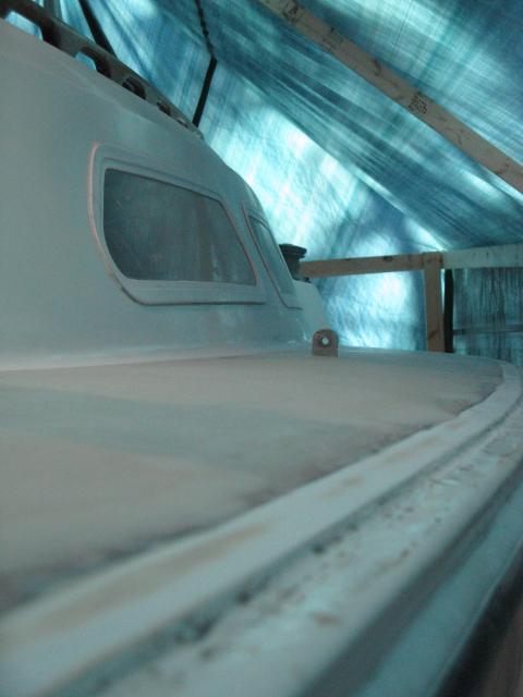

I'm dying here. The fairing is complete and the barrier coat goes on tomorrow. That was one hell of a lot of sanding touching up and resanding. The Maximum Accuracy Gauging light or maglight for short showed no shadows. That's a trick out of the Gougeon Bros. Fairing and Finishing guide. So anyway with all this work restoring, back to our current discussion. Preventing stagnant air and the other things that go with it. I wonder if these fans could be used in conjunction with the blower dorades and ducting on the 27? Not to pull out the existing bilge blower but as an auxiliary system in parallel. After all the work it would be nice to keep everthing fresh for several years. And a few pics of the fair deck for grins.

AAAnd a functional, if not very pretty, deck has been achieved. By that I mean three coats of epoxy applied with a urethane roller are now applied giving the portside a moisture barrier. The last coat I colored to provide a background for the forth coming gelcoat and nonskid. The downside is with a super smooth deck the imperfections in the starboard side are glaringly obvious. So let the warmer weather be here as gelcoat hates the cold.

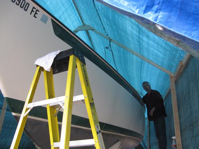

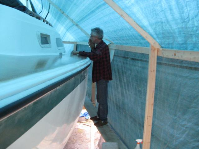

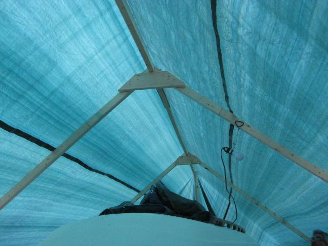

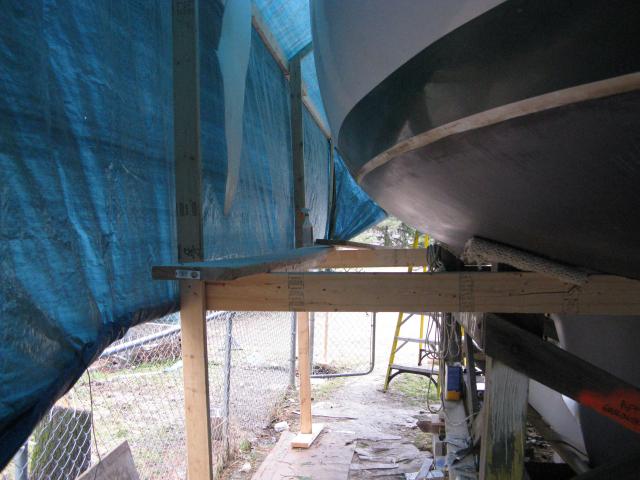

Hey, could you post a picture of the tented boat.. It never occurred to me that you had built scaffolding all around the boat to work on it.
Aug 20, 2010
1,399
Oday 27 Oak Orchard
Glad to oblige. I couldn't see myself moving a ladder back and forth every few feet so I had to build a cheap scaffolding. Also with the exposed balsa core I had to keep everything super protected lest it get soaked. So I picked up a few 2 X 4s and a cheap tarp to keep the weather away. I also use a smaller tarp to keep the boat covered for double the protection. I used the cradle as the base for all the other stuff as this isn't going to move. The ladder can be moved fore or aft and the other board bridge from the basic frame to it to make it easy to cover long areas efficiently. The height works out pretty good but a face sheild and dust mask are a necessity for the machine sanding, grinding or using the router as it is very close to face level. It does make it nice for the up close staring to check the work though. I honestly don't believe I could have made the progress as quickly as I have without it.

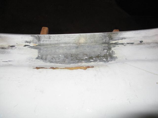

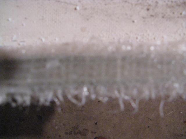

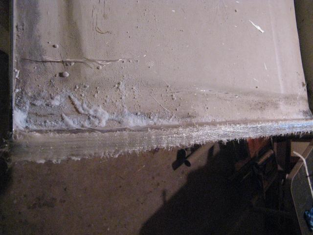

Pour me a warm one jibes the weather is going the wrong way. With the temps a balmy 17 and 18 by night and a toasy 25 during the day I can't do much but regale folks with tales of yore. Other than that, some things can be accomplished. Anyone want to guess the weakest part of an Oday? Yes the sliding hatch on the main companionway wins the prize. Step on that sucker and pow cracks it right down the middle. Hey it wasn't me but a PO. So with trusty grinder the 12 to 1 bevel ground on the inside and a build up with epoxy and three layers of my trusty +/- 45 knytex and hurray and oh joy it's fixed. Now somone in another post asked a while ago how to fix the razor edge, years of sliding that hatch produced. With some epoxy thickened with 404 high density filler layed on the sanded and cleaned surface provides a good base. Sand it and in this case I'm using the 0/90 knytex to improve the thickness and distribute the load. Nothing fancy here. I am also filling the weave, (even though it's not woven but stitched together) with 406 colloidal silica. That stuff is super smooth after sanding and wears like glass. That ought to give it another 30 some odd years. So here's a peek at the curing hatch in the basement where it's warm and as soon as it hardens just a bit more out comes the razor for a quick trim. Aaaayund, later this week I'll be showing how to dispatch with those pesky hidden lifeline stantion nuts without elaborate backer plates and holes carved in the cabin liner.

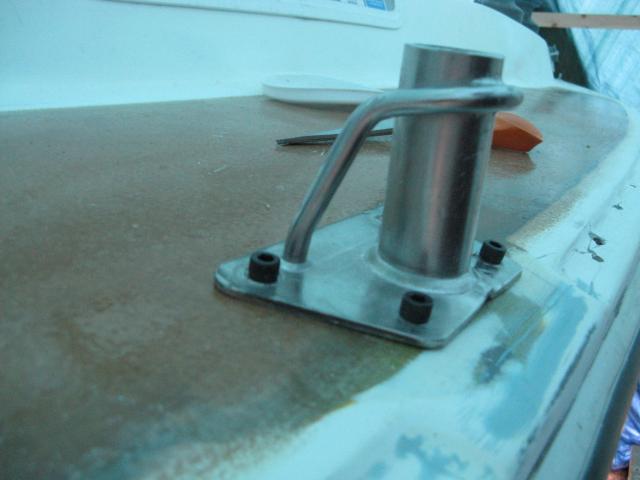

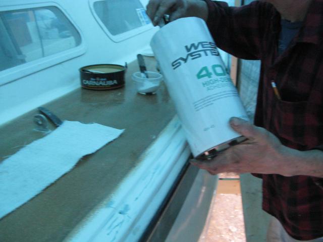

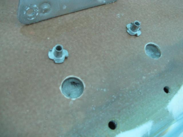

As I promised another way to free ourselves of pesky hidden stantion nuts without hacking the bejeepers out of our liners. Introducing the T Nut often confused with the peanut or coconut but radically different in form and function. These are 18-8 stainless steel and available through most any industrial hardware outlet, in this case Mcmaster-Carr. I clipped the prongs by about 1/3 as they only provide a means to prevent turning and any excess might well split the epoxy. With 3/4 inch holes bored in the deck, as this is the flange diameter, the core material was carved out by 1/8 inch on a side using a modified roofing nail mounted in my Dremel. I lined the holes with knytex as the tabbing at the cabin liner has been compromised and the epoxy would leak into the cabin if not for a seal which the cloth provides. Don't bore the holes so deep as to cut through the inner deck skin. The nuts are 1/2 tall so anything more for depth is excess. So wet out the holes with epoxy and thicken the rest with 404 high density filler. Attach the nuts to the stantion base with screws slighly longer than the nut height in this case 5/8 inch. Wax the stantion bottom and the screws prior to assembly of the nuts. Use screws that provide a good means of extraction, here I am using socket head cap screws that use an allen wrench. If the epoxy grabs you'll be glad you didn't use phillips heads. Fill the holes with the thickened epoxy, not too thick or it won't settle in around the nut, and using the outboard screw holes as guides set it slowly in place. Soon as it's cured I'll post more pics of the end result.
Aug 20, 2010
1,399
Oday 27 Oak Orchard
Amendment! Holy chirping crickets. After heat curing, the screws backed right out and a bump with the heel of my hand and the wax worked for releasing the base. After a quick sanding and reattaching of the base I was able to hang off the thing without so much as a creak. This is definately our answer to hidden nuts and elaborate backer plates. The only way these will break free is to tear out a huge section of deck and with epoxy encapsulation no sealant required as the core is isolated as well as the bottom of the nut is sealed.
