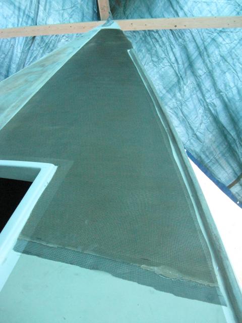

Well there it is. The largest piece has been made. I'm not crazy for the 75-60 as it sets up fast, fast, fast and if that wasn't bad enough it will readily tear. I'm going back to the 74-30 for subsequent molds. With the addition of the screen it is plenty good enough. Either product works but a slower cure, less susceptable to ripping is probably preferable. Place on the opposite side pattern up and cut it to shape plus 1/2 to 3/4 inch larger per side. And I should include a note about all this process. Gibco and the flex mold distributors are in business to make a few bucks. To pirate an idea is both unethical and probably illegal. If you desire to use this process at least buy something from these folks and remember if they go out of business we all suffer the loss of a product disappearing from what is in reality a very small market. So here's a look at Step 3 in its' final form. A good way to keep a company going and save some serious money at the same time.

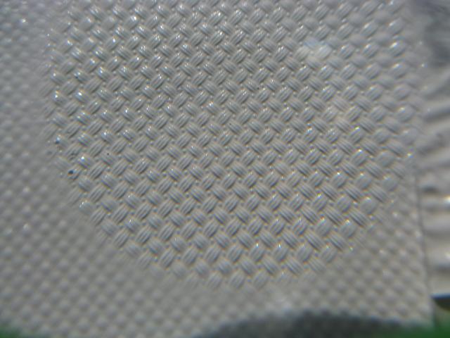

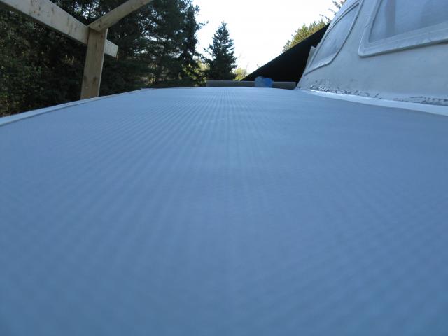

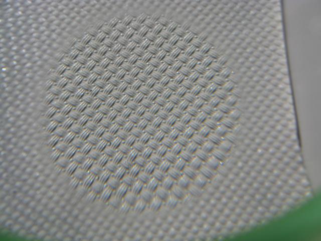

You be the judge. Picture 2 is the 75-60. Picture 1 is the 74-30. The 75-60 also curls at the edges like a banana so it would entail weights to fully imprint. My choice after some discussion among my family is due to the greater definition and resultant grip the 74-30 will be the mold material I will be using. It doesn't curl at the edges either. Step 4. Check.

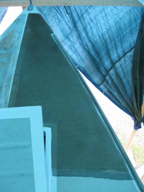

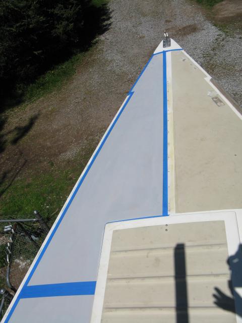

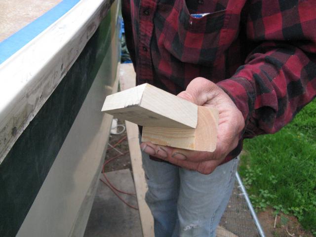

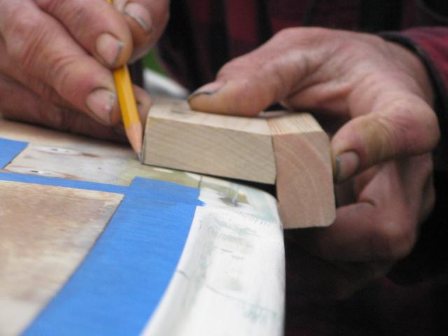

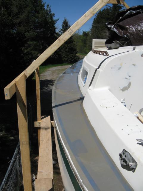

Good to here from you Todd. My pro said the same about spraying gelcoat. Embrace the orange peel, you can't escape sanding. So here's a few pictures of this morning's festivities. Getting a straight curved line with a little fixture I whipped up. It follows the curvature exactly and the pencil line gives a nice easy line to tape to.

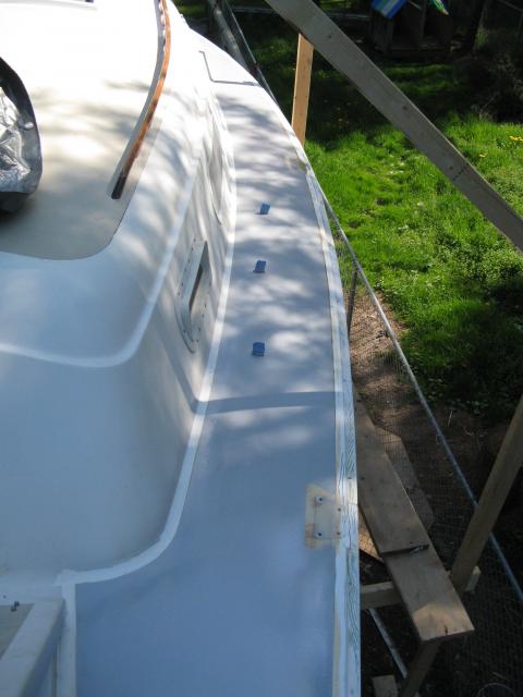

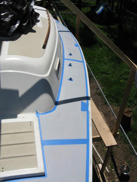

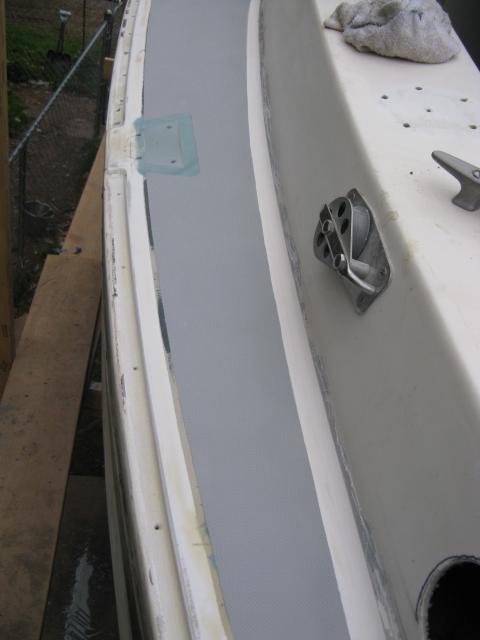

With this post I am going to conclude today's fun and frolick. I decided to pull the tape as it is apparent the nonskid isn't going to happen this weekend as the gelcoat has to cure 24 hours. I really didn't want to fight removing tape after a week imbedded in gelcoat. I am happy to report the tiny equipment has worked admirably with the basecoat fully applied and fully tack free over most of the area as of now. The 50/50 Duratec and gelcoat mix eliminates the need for wax or PVA as well as styrene thinner to shoot. The little gun with the 2 millimeter needle came through with flying colors. The down side is 8 ounces is the max it will apply before the gelcoat starts to gel. I did have one batch go off in the gun and let me say that's a real joyful event getting it out before it hardens. Make sure the mixing equipment is thoroughly clean between batches and if possible use disposable stuff. My 1 horse compressor came through like a champ delivering 45 psi without any waiting for pressure to build. My conclusion is; it is possible to spray large areas with smaller, and less expensive, equipment. The other situation was getting coverage with the Duratec. Since it is an almost clear additive the full coverage takes some repeated passes. Better to move along and come back after the solvents flash off and even go over the same area a few times with a new batch of gelcoat. By overlapping the areas, coverage is obtained without having to wait around and have a mishap with the gun. 12 minutes is about all you get to use 8 ounces with one refill included. Then it's to the acetone bucket and clean the heck out of the gun. So with the same and even base color applied, here are the pics and I included the equipment to show how small you can get away with.

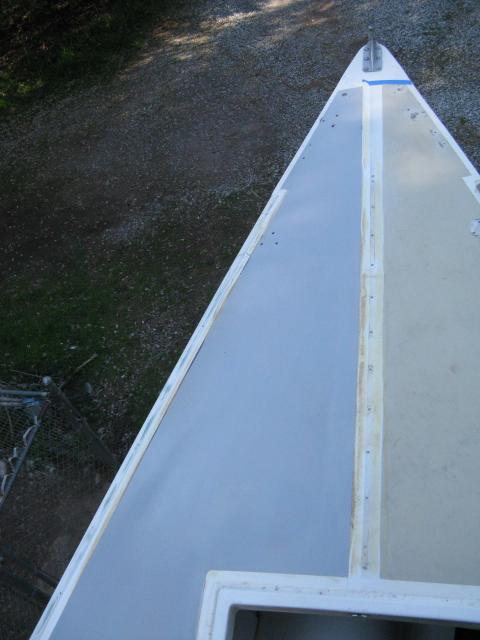

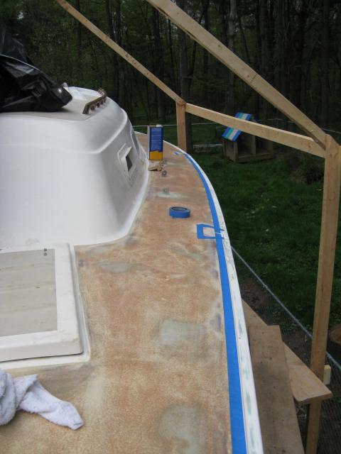

For today aside from retaping everything some additions were added. The cabin white stripe measured 2-1/2 inch where everything on the deck measured 2-1/4 inch. Not to be particular but just plain silly I layed everything out to the 2-1/2 measurement. Once the nonskid patterns are imprinted the places where there is blue tape will be sprayed white when the entire cabin is ready. The molds are cut and in place in picture 3 and I'm pleased with the way they are laying down. So for now unless there is a question YOT will await next weekend when success or disaster awaits.

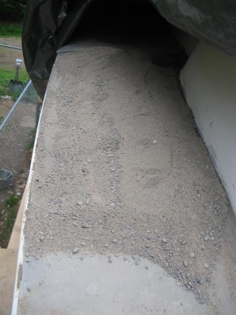

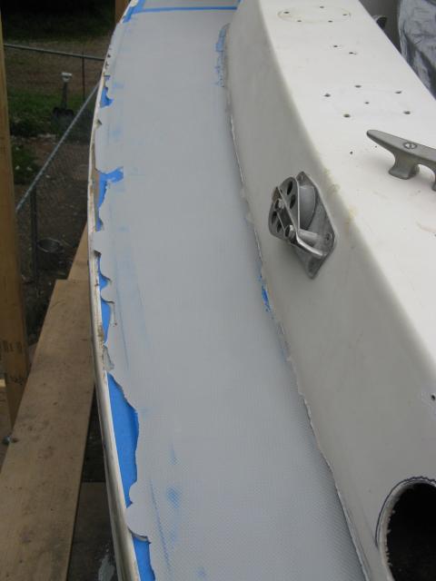

RTV Urethane mold update. I couldn't wait for the weekend as rain is forecast. So tonight I made the first imprinting using 50% Duratec and 50% gelcoat. The mold back was dusted with talcum powder to prevent dragging of the spreader. The 50/50 mix was too runny but did fill the mold. One other problem was I rushed the process and there were several small areas with air bubbles. The gelcoat wave must be unbroken through the entire process to prevent this. Adding a half inch of sand to the top of the mold proved useful in keeping the mold tight to the deck. The final error was a premature pull of the mold that wiped out a 2 inch by 7 inch area of the pattern. So tomorrow I will try another pour and modify the technique as the mold works extremely well having thus far yielded a nonskid deck in the 70+ percentile. This is definately holding a great deal of promise for a lower cost original deck, once the procedure is worked out I do believe stunning results in the 98 - 99 percentile are achievable. The best part is an unsatisfactory result can be sanded down and is ready to go as there is no wax or PVA involved.

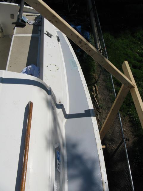

:dance:I suppose I should be humble, oh to heck with that. Who's your Daddy, whoot, whoot. My name is Joe and I say yo cause it's the only word I know. So for the technical whooey. 10 ounces gelcoat, 2 ounces Duratec High Gloss Additive, 1.5 teaspoons MEKP working at 62 degrees and slowly move the mold into the area to be patterned while keeping a nice wave in front of the curl using a squeeze bottle with a spout. Once the mold was down on the Gelcoat I lightly ran a spreader from the center of the mold to the edges at appproximately a 30 degree angle moving from fore to aft and after one and one half hours damn I'm good. With 4 tiny flaws that the urethane picked up from the flex mold now you too can reproduce a nonskid deck. I used sand once again to prevent edge curl and the mold was lightly misted with Pol-Ease 2300 to prevent the mold sticking. Enjoy the pics and have at it. Sand, rubber and assorted other crud aren't your only options.

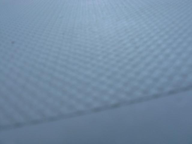

Thanks jibes. The actual pattern is outrageously small and the only way I can get a picture is through a magnifying glass. Paul Lacharite at Minicraft said this is a very delicate pattern and would prove to be a challenge. The post of 4/23/11 shows the pattern photographed through a magnifying glass. The whole section looks exactly like the one in picture one. This was the last unknown in the project and by next week I should be ripping the starboard deck open to see how bad bad can be.

Sure, rub it in jibes. We know there are two seasons. Winter and the fourth of July. Our secret is we put skates on our sailboats and careen about at breakneck speeds across our frozen lakes. How's that for a sea story? So where was I, oh yeah, 2 of 2 are nonskidded. Once again this crazy pattern is so tiny my camera just doesn't do it justice. Each time I roll back the mold is like Christmas. With each inch coming out fantastic the suspense builds until all is revealed in splendid condition. I gotta get a better camera as this one just doesn't have the resolution. I'll post what I have just the same with the important thing being the results were reproducible. Two down two to go.
