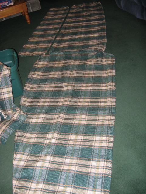

WARNING: The following post contains graphic images that some viewers may find disturbing. But since you're probably going to ignore the warning anyway, here's what's up with 25 and his YOT restoration. The cushion covers are complete. A self feed or walking foot are an absolute must for plaids to keep the patterns from drifting during the stitching process. The plaid fabric is the dread Olefin (Herculon) that was original in the Oday line at the time of construction. The bottoms are Outdura Acrylic that I was going to use as a hull liner but changed my mind when I found the exact or at least a closer material to the original hull liner. Sewing your own is a real money saver. For less than 1000.00 you get the machine (Singer Confidence Quilter), fabric and all the assorted threads, snaps, zippers and whatnots to completely redo an interior. A great moneysaver and winter project for any boat. Here again I had never sewn much of anything but with some guidance and trial and error, viola a new interior decor awaits.

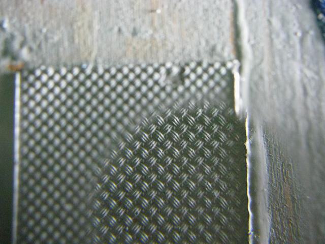

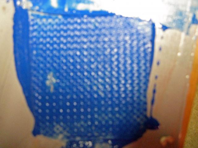

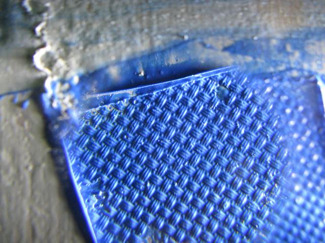

Well with the house reeking of polyester gelcoat I am happy to report all my messing with RTV Urethane molding compounds is yielding some encouraging results. In addition to producing some reasonably accurate emblems it will capture a well defined non skid pattern. So with some lousy pictures ( this 312 Oday rope weave pattern) has been transferred from a small scrap of the Gibco Flex Mold to a gelcoat layup and then recaptured with the urethane and with that a layup in gelcoat again. So what does this mean? It means huge savings in reprinting your original deck nonskid. Now the rich guys can go ahead and buy the full sheets and the results will be astonishing as the gray layup demonstrated. For those of us on lesser budgets, here's the how to. Purchase a smaller amount of the flex mold and use it to create a gelcoat deck, say on a 4 X 8 sheet of plywood by using the repair techniques shown by MAS epoxies. Now you have the pristine deck for the cost of the Flex Mold, say 1 square foot or so, the plywood and a quart or two of gelcoat. After it cures pour on the urethane enough to cover the deck. After that cures remove and cut out your patterns to the sizes you need. The urethane captures about 95% of the original pattern or about 3 years of hard use less than perfect. For about 300 bucks you've got some great one shot molds to replace your worn nonskid. If you can afford it the Gibco yields an eye popping wow result. Now hows about some decent weather so I can get busy again.

Nice work on the non-skid. I can't wait to see it on the boat. Not sure of your process, are you making loose pieces of gelcoat with the non-skid and then bonding them to the deck? I would have expected spraying on the gelcoat on the boat then using the non-skid molds to impart the pattern after covering with mold release?

Ahoy there jibes, from this God forsaken frozen wasteland in upstate New York. If it weren't for Lake Ontario and it's many destinations I would definately be moving. Not sure if Miami would admit one more lunatic. No offense to any lunatics from Miami reading this. What I'm up to jibes is to create a gelcoat 'deck' on a 4 foot by 6 foot piec of plywood by piecing the gelcoat with the Flex mold as it does lock into an existing pattern. With the nice flat surface imprinted in a false deck I can then pour the RTV urethane over that deck. After it cures I should be able to cut it to fit on the boat and in one continuous pour of gelcoat imprint an entire section if not an entire side. Some of the problems were the curvature of the deck didn't lend itself to piecing it together as the flex mold doesn't turn horizontally. I figured that would turn into a colossal mess. The other problem was one of stiffness. The flex mold would have to be cut for each section as it doesn't lay flat when it has to be able to lay up against the cabin sides. This prevented a mirror image piece that could be used from one side to another. I thought about casting off the boat but with gelcoat being essentially brittle I had serious doubts about it's ability to conform to the deck. Everything fell to the urethane to succesfully duplicate pattern. With yesterdays test I am encouraged this will be the preferred route I will pursue. The urethane is also far more flexible so it can conform to the deck. Along with it's translucent cured state, imperfections and coverage can be seen as they occur. Should a void be detected during the pour it is an easy matter to correct it right then and there which is not possible as the flex mold is not transparent or translucent. You only see the result once it is cured and then it has to be repaired. So as of now I'm chomping at the bit for weather conducive to finishing the fairing and creating an original non skid deck. I will definately be sharing this as it unfolds. I am even going to find a way to get some good pictures of how delicate this pattern is along with every step of the process.

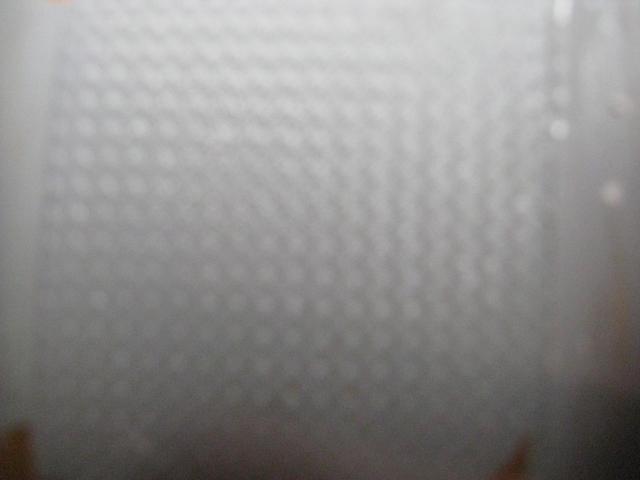

Here's a camera tip for getting these extremely small details beyond a standard cameras range. Take the shot through a magnifying lens. With that tip I can now show the flex mold vs. joe mold results. The quality was not the issue I was going for at this stage but a less expensive way to achieve a reasonable result. So without further a-do which is which?

Thanks sailingcal. I checked the owners manual and adjusted the settings but alas my camera has severe limitations. This 312 pattern is a ridiculously small pattern with a depth of only .007 inches. How this pattern provides any secure footing is amazing. I looked at the pattern on a piece I removed and noticed it had been regelcoated without reimprinting. Now I know why I couldn't get a mold of it. The 75-30 RTV urethane I purchased from US Composites captures it quite well provided it has a good surface to duplicate. Again thanks for the photo advise as I would like to post some pics of the process as it progresses.

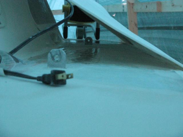

Aug 20, 2010
1,399
Oday 27 Oak Orchard

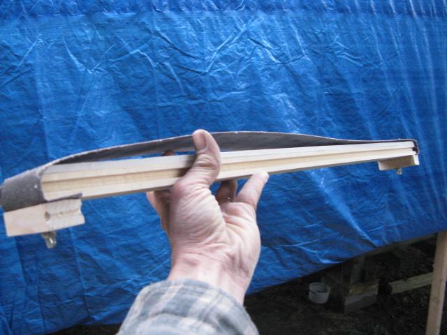

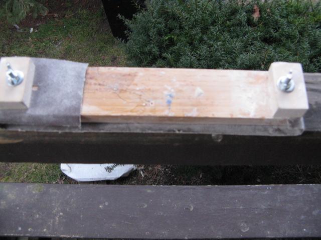

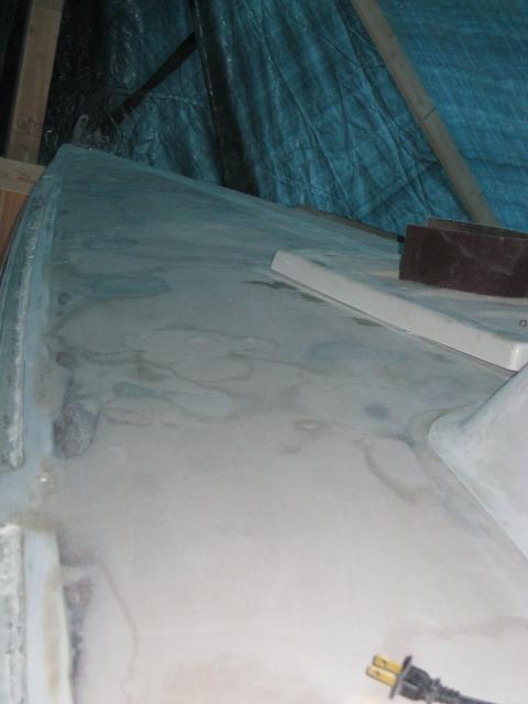

Hey jibes I was wondering where you were. Nope not yet, but with the weather approaching the forties and fifties progress is being made again. With any gal the make up is a must before going out. With that the cosmetic work is well under way. The fairing of the port deck is nearing completion with the final barrier coating looking like it will happen in a few days. Now that I have found a body and fender tech willing to shoot gelcoat when I'm ready I am a happy kid. He also turned me on to the long board sanding block. A few flat head 1/4-20s and a couple of wing nuts and there you have it. It sure makes sanding smooth lines a piece of cake. The 30 inch board has some left over 1/4 inch foam glued to it. The 1 foot board is great for the radius work but I didn't bother with the foam. The smoothness of the lines is amazing and I highly recommend them for this type of work. So here are the pics of the bow all nice and pretty with the fairing compound along with the foam tent and Stanley heater keeping tonights goofest toasty. Also up a couple of pics of the simple long board sanding blocks.
Jan 27, 2008
3,092
ODay 35 Beaufort, NC
What are those old man hands doing in the picture?
