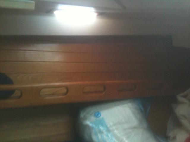

Purple haze running through my mind, wow I can hear the colors man. So in addition to figuring out how to Make Oday Emblems I have been working on the hull liner. I bought a roll of Volara closed cell foam from www.foamforyou.com I also bought some 313 adhesive. Foam excellent the adhesive not so much. The web spray is worthless when bonding fabric to foam. It works quite well bonding the foam to the hull. Flame laminating is cost outrageous. I will be trying Bostik Supertak mist for the fabric to foam bond as the web type sprays leave to many voids. Poor YOT looked like it had cellulite. So I'll keep everybody posted once the adhesive shows up. And don't forget the respirator or you will look like this.
