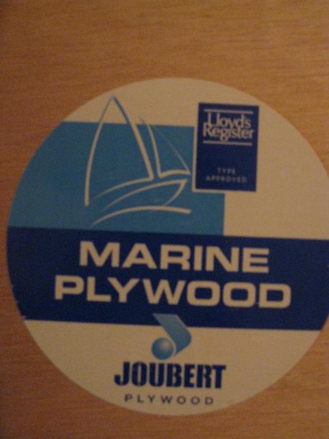

Aaaahhhh, jumping crying out dammit. Well a major colossal catastrophe has occured. Apparently all 'Marine' Teak Plywoods are not created equal. There are two distinct classes. Class one is a structural teak plywood made with a hardwood core available by special order only through one retail supplier. I am currently awaiting the lead times and pricing. The other type is not a marine grade at all but usually has a softwood core and a very thin teak veneer surface and is often marketed as 'decorative' marine plywood or simply A1 marine plywood. There is a huge difference in the compressive and shear load carrying capability of the two. So as my error becomes painfully obvious, grab an education at my expense, any true marine plywood will be stamped with BS1088 or have Lloyds certiication or it's pretty much good for nothing on a boat. Oh well as the saying goes, "I do it nice, 'cause I do it twice." Shrats.

Hurt isn't the word I'd use Indy. I'm livid over this. When I talked to my supplier, even they were distraught that this is such a low quality product. At 196.00 per 4 X 8 sheet, 3 sheets is a horrifying blunder. Well anyway I'm glad the error was caught, even by mistake, before the boat went back to the water. What a disaster that would have been. So undaunted I'm looking at Okoume-Joubert BS1088 which has the stamp on each sheet. 153.00 per sheet as opposed to 365.00 per sheet and massive lead times for 1088 teak. Much as I love teak, I don't love it 1200.00 dollars worth. That kind of money is reserved for the new toe rails, hatch sliders and handrails. As a side note BS6566 is the certification for exterior marine plywood. On the plus side I have a really great set of patterns for all the woodwork in an Oday 27.

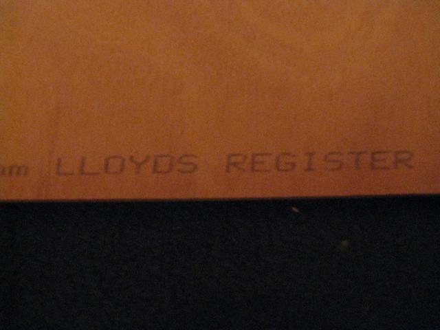

Hi there jibes138. Too late. Ding, Ding. Boat Babe carry a card with a big 2 on it will ya. Round two. Ok so anyway true teak marine plywood that is structural ain't happening. Entre s'il vous plait M. Guy Joubert. Considered the best marine plywood in the world we have some pics of the amazing stuff complete with what to look for. It's actually Okoume (pronounced-Oh coo may) and is labeled umpteen ways with it's certification. While it may not be totally original it's close enough. My friends at Pittsford Lumber have been great through this mishap. They have researched any way to salvage the teak but like me came up disappointed. No problem, they have offered to sell the pieces for me as they sometimes get someone looking for small pieces. So everything is stripped from YOT and is awaiting the new stuff. While at Pittford Lumber I was inquiring about some wood for the trim as the door frames shattered during removal and are pretty much dead to me. They were most helpful in assisting me in finding a suitable chunk of wood that could be turned into new door frames. That last pic is 8/4 Mahogany that has been planed on front and back. So, things are moving forward again and I'm optimistic that a repeat of the last fiasco is a miniscule possibility. Now as to the totally mod like wow orange, perhaps oldhokie64's 272 hippy glider previous owner somehow got a job at Oday as an interior designer. So enjoy the pics and look for these labels/stamps when you buy plywood.

Hi again jibes. I already bought the Okoume. Here's how this whole thing came to be. The first two teak plywood sheets had 3 ply cores and perhaps a .050" teak veneer. They were stamped A-1 Marine. They seemed light compared to the originals but I figured new techniques and so forth. It was when I bought the third sheet I knew something was odd. It had a 5 ply core and was stiffer. I then began to question the difference between what I had purchased and the originals. I went to the Husky Plywood web site and looked up the 'marine plywood'. Low and behold a spec sheet (posted August 2010) with the caution, this is a decorative marine plywood and should not be used for structural applications. It listed the core as Fuma. When I looked up Fuma wood it turns out to be Kapok. Now I was really concerned. Kapok is on the order of Basswood which is great for decoys and such and the expected durability is 5 or fewer years. I started weighing the panels and found they were 1/2 the weight of the originals. Alarm bells were ringing at this point as I knew these would never hold the upper shroud chainplates. What came next was to search out marine plywood specs. The BS 1088 kept coming up. There are requirements for core density (500kg/cubic meter or better) as well as durability ratings which list how long it can be expected to last when exposed to the elements without maintenance. There are also boiling tests where they actually boil the plywood in water to see if it will delaminate. Then as you mentioned the core gaps and glue types. So anyway, now I know more about marine plywood than I ever wanted to. But hey at least I can share the knowledge with others. Now the answer to some of your other questions. The boat came with that orange. Perhaps that was how I got such a good price. I'm changing it to white. I'm sure the tape deck I pulled out ran "White Rabbit, by Jefferson Airplane" more than once. Yes everthing is epoxy edge sealed with epoxy coating over the areas that are in contact with the fiberglass. Tabbing is being replaced on the hull joints with +/- 45 knytex and epoxy. And can anyone tell me what time is good to catch Rudy at D&R? I've called 4 times and can't seem to get ahold of him. Ain't sailboats great? There is always an adventure even when on land and that might just be why we love 'em.

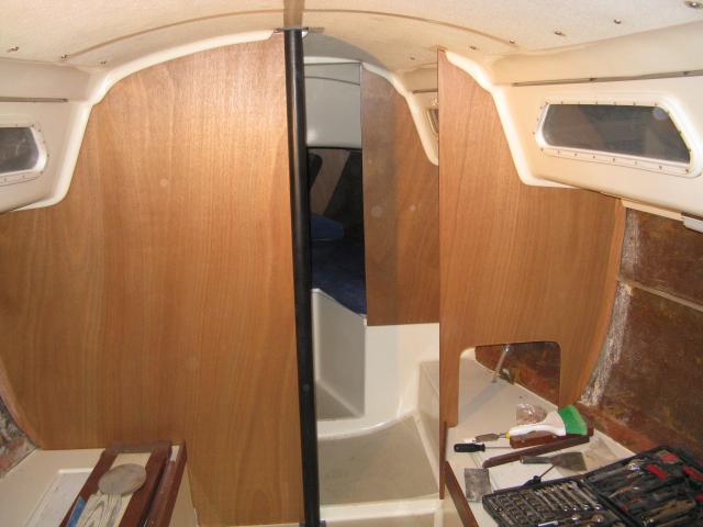

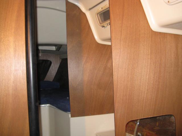

A special Odayowners.com news exclusive bulletin. 25yearslater has installed the main cabin bulkhead. In one single thread viewers can choose between light and dark as well as grain patterns. So with that said here's what's up. When I applied the epoxy to the edges and tabbing areas Okoume turns bright orange. That's a color I'm trying to escape from. Taking Panta Rei's advise I headed to Sherwin Williams to select some color to tone it down. Seems Teak has an element of green to it along with the brown. So I decided to stick with a stock color rather than a special blend. Having brought a sample piece of light teak and a scrap of okoume the staff allowed me the opportunity to sample some different Minwax stains to see about what color I could tolerate. Selecting Minwax 'Fruitwood' yeilds a light teak color as can be seen in the photos. Not perfect but close enough. Application was by brush followed with a wipe of a terrycloth rag. I did this in sections as I wanted to control the color very carefully. Next was let the stain dry and two coats of Minwax wiping polyurethane were applied. This has to be applied by cloth and not a brush. So there we have it. Also up, the port deck faired and sanded and awaiting it's final fairing, and also the first gelcoat on the companionway bulkhead patches.

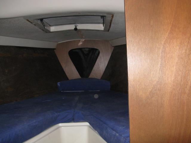

Okay busy day. First the layout of the plywood sheets.
Sheet 1) Portside main bulkhead, Vanity 3 pieces.
Sheet 2) V berth bulkheads, Port and Starboard Shelves, Hanging Locker behind head.
Sheet 3) Starboard main bulkhead, Forepeak V thing, Table 2 pieces.
Sheet 4) Port and Starboard Settee backs, Quarterberth Engine access, cupboard in galley.
This orients all the grain in a vertical orientation except the settees and shelves. Any additional stuff can be cut from the remaining plywood but that is minimal at best. I have the lads working on converting the owners manual to a more suitable format for download. And a few photos of some of the woodwork awaiting tabbing and the final fitting of the remaining woodwork at which time most will be removed for the hull liner application. Enjoy.

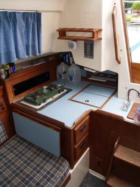

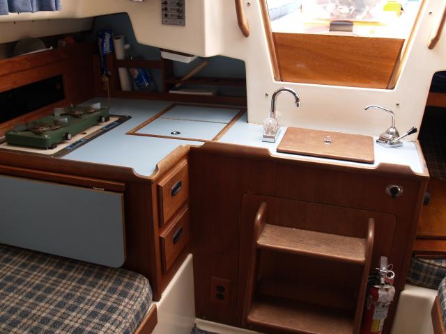

What a great project and resource you're providing here! Our last boat was an O'day 27 and we loved that boat. Our family just out grew it so we made the leap up to an O'day 35. I made my fair share of modifications to the 27 that I thought I'd share, I hope you don't mind. I know you are restoring to original, my projects were modifications that took the boat away from original, but it allowed us to stay in that boat longer by adding storage space. I removed the vanity and sink in the head compartment and added a stack of drawers there instead. My thinking was that we would get by with just a single sink in the galley. This addition did take away the footwell on the starboard settee so this berth was just for the kiddos.
I also added a photo of our baby blue galley. Perhaps a step up from the psych. orange, but still not my favorite color.
Anyway, keep up the good work!

Here's one more shot of the galley/companionway for your layout. I'd say you matched the color pretty well on the bulkheads, better than I did with the stack of drawers, but oh well. I also added a cockpit shot that shows a nice little tray that drops in between the seats. No room for a cockpit table on the 27, but this tray came in handy. It could slide fore and aft, but rails on the underside kept it in place side to side.
