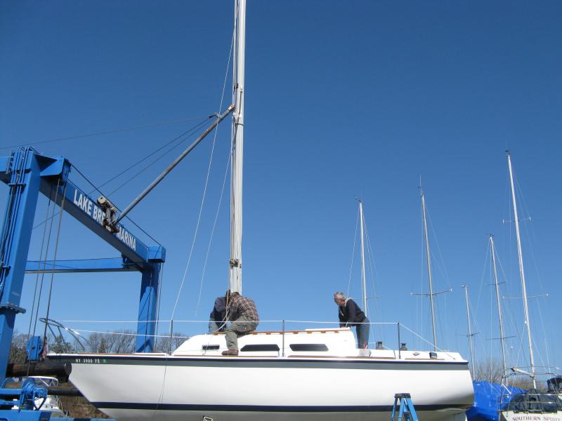

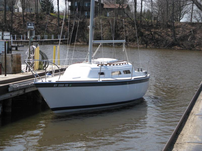

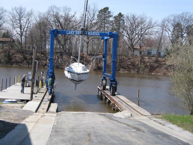

YOT doth float. Most everything went without a hitch other than a slight gas leak at the fuel pump, a stuck fuel check valve at the tank and the electrical fire when the ammeter shorted to ground and burned off the insulation. The repairs were quickly attended and I am happy to report the old Atomic 4 barked to life. The Hayn Hi-Mod fitting I used for the backstay is a cinch to use. As you may remember I had the split backstay with adjuster but opted for a single fixed stay. Ordering extra length on the backstay a quick cut and assembly were an onsite rigging walk in the park. With the mast up the final measurements were placed with the order for a 140 Genny and an Asymetric Spinnaker from none other than the good folks at SBO. :D

Nice, glad to see you in the water. Great pic's, now for some sailing pic's..Michael..

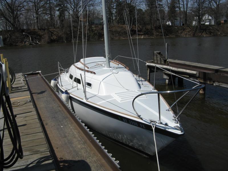

So ive come full circle. I have watched you take that boat and restore it so well, to such "as new" condition as it likely possible, or reasonable, and its really a very pretty and very sharp boat. And it is amazing how modern it looks.
So I raise a toast to you Sir, you did amazingly well. You should be very proud of her, she shows very well the effort you put into her, and is worth every bit of it. YOT indeed.

Looks amazing. Time to pack up, move aboard and head out for parts unknown. That view from the top really shows off the non-skid areas, you did a remarkable job with that. And Anchorclanker didn't mention to think how much weight you lost and how much booze you didn't drink while engaged in this hobby? I built a sailing dinghy once and lost 15 pounds in the process.
