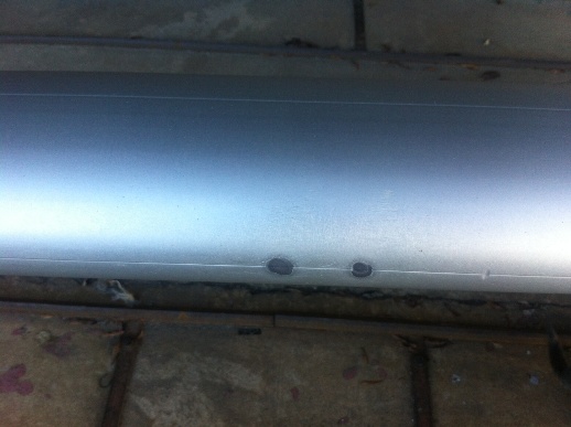

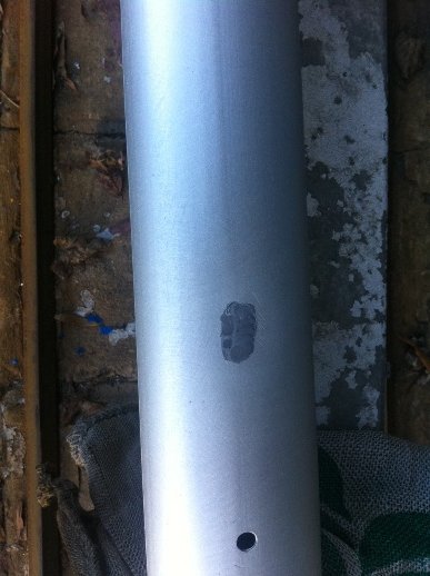

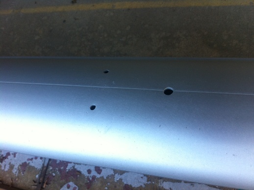

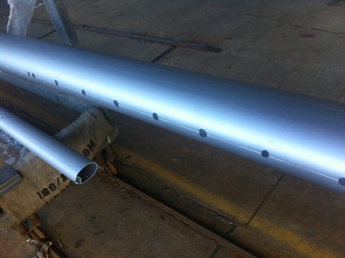

So without further delay here is where the mast stands. My new bestest friend in the whole wide world Matt Dyer at Charleston Spar/Sparcraft Spars has sent me the pictures of the mast following cleaning of the old gold anodizing and reanodize. Notice the discoloration of dissimilar metals. These are the mast aluminum and the filler rod aluminum. Looks like crap, right? Not to worry. The next step will be the powdercoating which provides a super durable finish that will be uniform in color. So as of now :eek:
The mast had to be stripped of all other metals prior to the anodizing process. So stay tuned to this thread for the final results.

Not so much the different metals, the filler rod was probably the same or a very close alloy to the base metal. The Mast is wrought. This means is it stretched and worked until the grains are all very elongated and uniform in direction. The welded area is just like a casting, the metal is melted and resolidified. Grains will be randomly oriented and the metal will have a different microstructure than the rest of the mast. Checking the alloy content it will be the same percent of various elements but will have completely different properties. The mast is likely solution heat treated and tempered, the weld may or may not have gone along for that ride. Anyway all this adds up to the anodize having a different appearance on the welds. If you look at an anodized aluminum casting it will look vastly different than an anodized wrought aluminum.
Aug 20, 2010
1,399
Oday 27 Oak Orchard
Huh! That's interesting to know how the differences in the structure affect the way that it responds to anodizing. I'm sure some folks would assume something is wrong but in fact it is cosmetic rather than structural. Thanks again for contributing.
Jan 27, 2008
3,086
ODay 35 Beaufort, NC
If you look at an aluminum part that is a casting but with machined surfaces the machined surfaces will have a vastly different color and appearance than the as cast surfaces.
This is from a paper written about seam welded tubes related to anodize appearance:
"Be aware of anodizing's effect on welds. The weld on a tubular component has a different color than the unjoined areas of the component. The heat generated during the welding process can disturb the metallurgy on nearby metal, or heat-affected zone (HAZ), and cause a localized discoloration after anodizing. Use the proper 5356 alloy welding wire and the lowest heat possible"
Note they talk about the microstructure in the recast or heat effected zone from the weld as causing the appearance change.

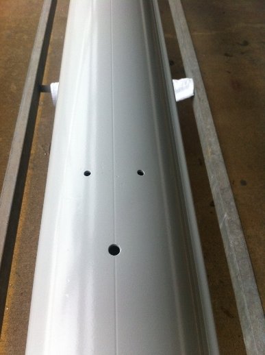

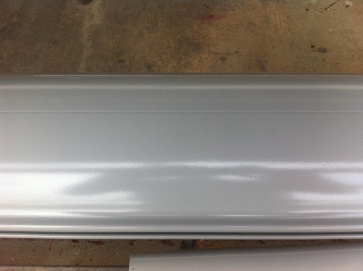

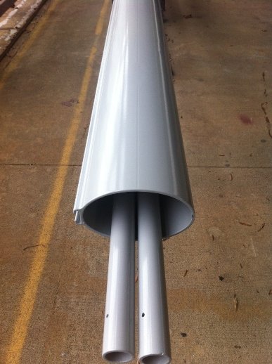

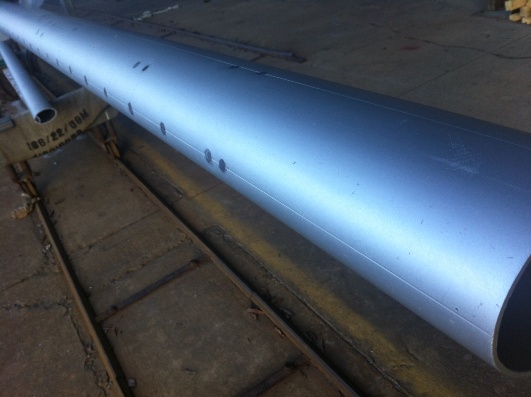

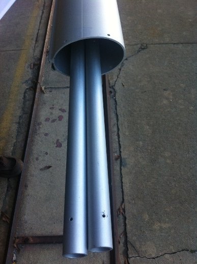

Check it out homes. Those fellows at Charlestone Spar really busted a move on the mast. This is powdercoating's finest hour. The anodizing arrests any corrosion unlike paint and the powdercoating is superior to paint in it's chip resistance and longevity since it is bonded to the aluminum anodizing. Bwaa Haa Haa. Dat sucker will outlast me. :D

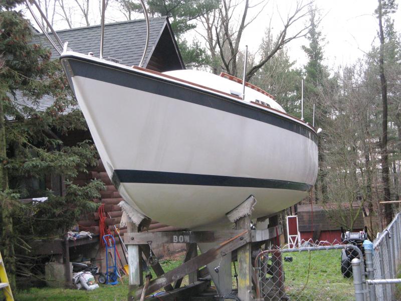

It seems the gods of warm weather have favored me. Availing myself this good fortune I was able to paint the bottom. Pettit Vivid in white. Batteries, register it, move it, launch it and rig it. Then the bestest part. SAIL IT. :dance:
