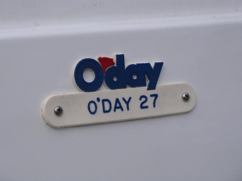

Aww for crying out Pete's loud sake. After all this an annoying drip, drip, drip. Where in hell is that leak coming from? Rain reveals all don't you know. As I peeked and peered and probed it eluded me. After covering everthing with tape, buckets and whatnot the leak tasked me. In a moment of shear epiphany it occured to me the two freaking holes from the emblem pop rivets were wide freaking open. A dab of modeling clay proved to be the solution until I mount them. Bilge pump check, water system check, handrails on their way and that's about it till spring. Then on go the emblems as the handrails are the last restoration item. Batteries, lifelines, bottom paint and rigging are pretty much spring time chores. So I guess I can say, YEEHAW and phwew. Oh yeah and the mast is waiting for a boat headed south for it's rework. No hurry there as it will be done indoors. OOOOPPS one more thingy. Pyacht in Maryland has 9 loop teak handrails for the lowest price I could find. http://www.pyacht.com/cgi-bin/pagegen.pl?pr+hnl409T.html

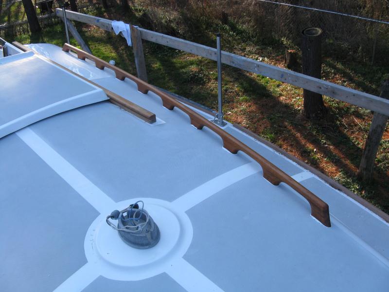

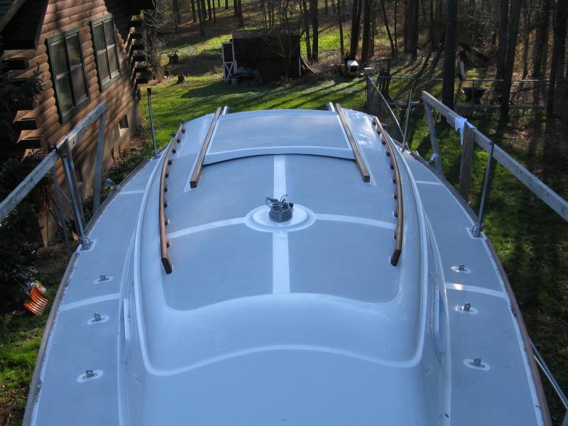

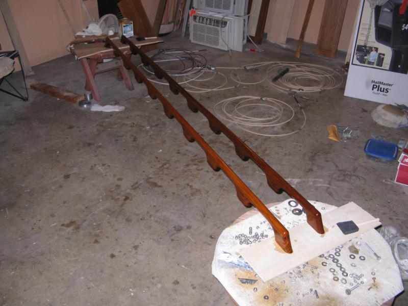

I'm so excited I might need a cold shower. My handrails are here and oiled up. Once the oil dries on they go and YOT is officially complete. I will be sending the mast out soon but that isn't something I even remotely need to worry about as it is a quick easy process. I purchased the handrails from pyacht and they are exactly the same as the O'day originals. They are made by H & L in California and have a 3 week lead time. I also afixed the emblems because I could. So for http://www.pyacht.com/cgi-bin/pagegen.pl?pr+hnl409T.html handrails in teak or mahogany try these folks. They even have longer ones. :D

Thanks Joe. Glad to have had you along on this adventure. I never thought this thread would turn out to be so popular. YOT does lean a little (about 2 inches) to port. The camera does exagerate it though. The advise and encouragement has been truly appreciated. Glad I could provide some insight into the O'day line.

Merry Thanksmasyear. And what a day it is. The handrails are on and with it the last of the components are finished. I used #12 stainless oval head sheet metal screws and stainless finishing washers to afix them as per the original. Have a variety of lengths on hand. 2", 2-1/2" and 3" as the cabin liner and cabin top can vary significantly in thickness. I drilled 5/16ths inch through holes in the deck structure only and used plastic straws to keep the injected thickened epoxy from providing a big drilling project. Once the epoxy cured a quick drill with a #1 drill down through the straw and we were ready to attach. Starting aft we predrilled 5/32" holes approximately 1.5" deep to preclude splittting these things. Reattach and mark the next 2 or three and remove and drill. Reattach and mark the next group of 2 or 3 and follow the same take it of put it on procedure. Finally remove and caulk or use butyl tape to permanently attach. There is a very pronounced bow so take your time to prevent a split handrail. So there we have it. YOT is ready for sleepy time till spring. :dance:

Damn nice looking. Good thinking with the soda straw idea, gonna rip that one off.

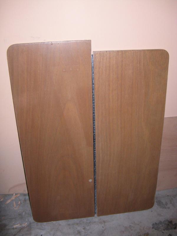

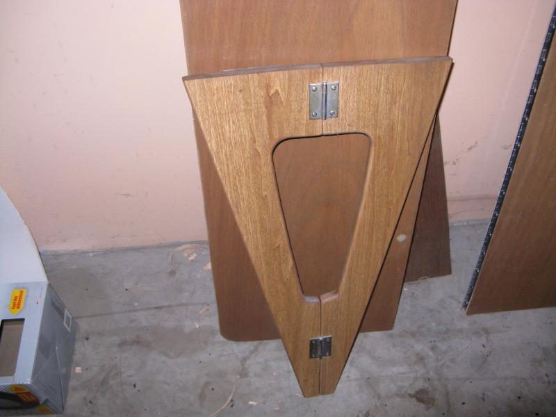

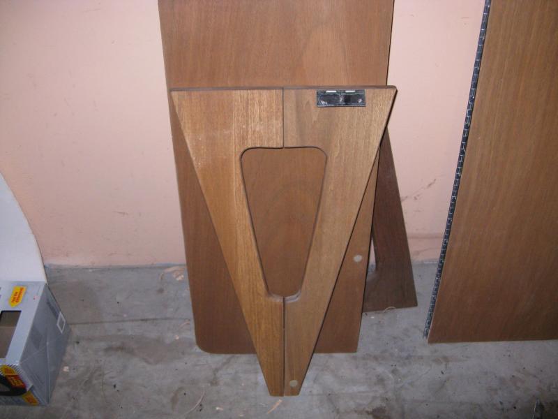

I like the job you did on the fold-up salon table. What I can't see is how it is supported when folded down. Are there legs folded up somehow or do use something else?
Bill
Aug 20, 2010
1,399
Oday 27 Oak Orchard
Thanks Scott. It has been great having you along since the beginning. Hello there Bill. The table can be seen on pages 5 and 21. Page 21 is cut short but it is a two piece leg that hinges in the middle and on the leg that is nearest the leaf it is hinged at the top. When the leaf that is hidden is folded out the leg folds out to support it. Here are some additional photos of the table and legs. I removed it as the Formica buckled on one leaf so I will glue it a little more diligently this time.
