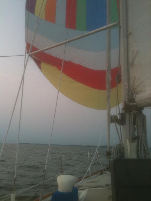

I'd be interested in how you rig your spinnaker on your 35, how you connect the tack and how you run the sheets. For the halyard I added the masthead plate with a block and run the halyard forward of the roller furler, I was thinking about running a short cable under the anchor roller for the tack to get it outboard of the bow pulpit. Just curious how you set it up.
For the sheets I made two lines with blocks atttached and I tie the lines to the stern cleats and run the sheets through the blocks then to the primary winches. This works well and I didn't need to add more tracks or winches. Again looking to compare notes. Thanks.

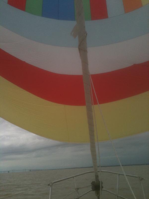

Jibes, my spinnaker is symetrical so I use a traditional method using a pole, sheet and guy. I added a topping lift for the pole but the PO had rigged a spin halyard that goes to the top of the mast. The pole is actually a three part extendable wisker pole which creates a bit of a tangled mess of the harness and release lines that I added this year (not shown in picture from last year). It is dowsed by a sock which works well but adds another level of complication. When my ship comes in, I would like to buy an asymetric and put it on a continous furler off a fixed pole on the bow but I need to invest in air conditioning first. I think I would lose some down wind angle but I would probably use the spinnaker more.
