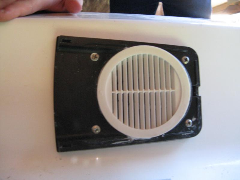

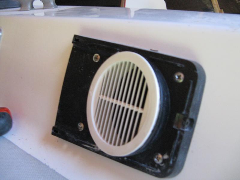

Perhaps some may have assumed I've sailed away, NOT. The little things are being tended to at this point. One of these are bees and other nasties accessing the cabin via cowl vents. A mini louver from McMaster-Carr should do the trick. Silicone it into the 3 inch opening in the Sea Dog Line cowl from Sailboatowners.com/store and bugs be excluded.

Welcome aboard Boatsail. Enjoy our merry band of recyclers/restorers and general all around good folks. Still more to come from 25 that would be me. Not much but some. And the grand finale being getting it in the water and see if it was all for naught. I prefer screaming like a little girl at bees Todd. It doesn't help but it makes me feel better.

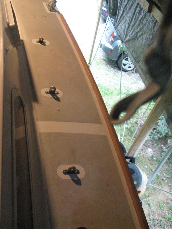

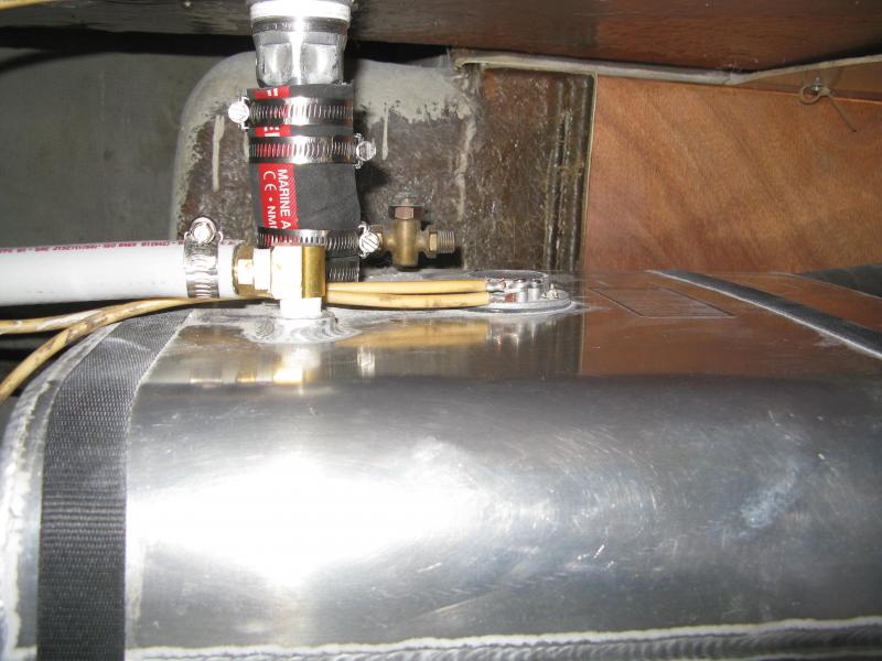

S'more nice stuff and gotta haves. Gas tank with SBO Store fuel hose, thanks Phil, that meets ABCLMNOP and Roids of Rundun (Lloyd's Register) for ethanol compatability. Grounding from filler neck to tank and to ship's ground. I saw the aftermath of a boat explosion once and that was sufficient to convince me get it right. Double clamps of stainless steel and vent hose, thanks again Phil. Also shown fancy dandy white bases under chainplate covers. Don't understand the nonskid under this area so I ground it out and filled with white gelcoat. Pretty snazzy huh?

Let's start at the beginning. Sorry to hear about you tank situation jibes. SailingCal has a oday 34 that he had to replace his tank. Hehad it custom made so he would be an excellent source. I was fortunate enough to find Mirax in business making the same tanks. They are within 1/4 inch of the original so I didn't have to recut the fuel fill hole. The tank did measure about 1 inch shorter so a new bottom support and blocking was made. The hose install was 1.5 inch ID on an aluminum hose barb 1.5 X 1.5 NPT screwed into the aluminum deck fill. The 4 inch hose was an easy measurement. Set the assembled fill and barb on the cockpit floor and measure the length from tank top to top of hose barb. To assemble install the hose on the tank and caulk the deck fitting. This is then pushed down into the hose. Secure the fill with screws into the predrilled holes and tighten the hose clamps. Remember to slide all 4 clamps on the hose first or you get to take them apart and restart 'em. Now to Jonny. You got it right about us gas burners. Creating all sorts of drama around marinas. Actually gasoline has been successfully used for boats for most of the twentieth century with a very good safety record. What we are running in to is aging boats with antiquated fuel systems. While we may not like ethanol blends it is the way it is and we are going to have to adjust to insure we are not going to ruin a great safety record. I am grateful to the many who post on this thread as it was their contribution that prompted me to inspect my tank and fuel hoses while access was available. This is our thread so it can't be hijacked. I'm just the nut who started it and followed through with techniques and advise provided by a wide variety of sources. And by the way jibes SBO Store sells by the foot. Email Phil and he can set you up. He might be willing to sell less than a foot but it is pretty cheap. I have 8 inches leftover if you want it.
