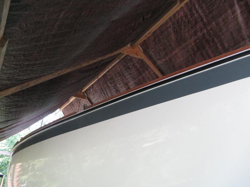

Well hows about an update 25? Since you asked I'll tell you. I won't bother with photos until I have all this complete. Rubrail. Snizbot snarfle grunda floble. This is a real pain in areas I didn't know I had. If you are buying the whole shebang from Rudy get it unwrapped and layed out as soon as it arrives. The stuff will stay in a coil if you let it sit this way for an extended period of time. It will take several days of weights to pin it down in sunlight to get it straight again. So the next headache was the holes were drilled at random locations. Somebody at the manufacturer needs a tape measure or one made by a reputable company. Better yet just don't drill them at all. No job is better than a poor job. Couple that with Oday random drilling and it is a challenge to get anything to coincide. The solution was run masking tape along the boat and perforate the tape at the holes from the boat. Remove and apply to the rubrail and drill holes from the tape. Bingo they line up with your boat holes eliminating filling and redrilling. Looks like a drunk did it but the insert will cover these quite well. I have opted to run two full length pieces along each side and which will allow me to experiment on bending around the bow and stern with smaller pieces. This results in 4 joints rather than the original 3 but in the event of a mishap there is plenty that should be left over. Once I get this done I'll update with photos and commentary.

Let's give this rub rail situation a little more thought. What is it for? To prevent damage from minor bumps against pilings and docks primarily or maybe when tied to another boat while rafted. It will not protect in case of any significant hit. It is also cosmetic in that it hides the screws from the hull to deck joint. From an impact standpoint the rub rail around the bow where the tight bends are is useless and the same for the stern where the other two tight bends are. Why not just cut matching 45 degree angles at the stern and terminate the side pieces at the bends and then use one long piece across the sternmatching at the corners instead of trying to form a continuous bend? Same at the bow? I have had to splice in repair sections on mine so have a little experience with it, as it gets old it gets brittle so small impacts start to shatter the extrusion. Haven't messed with the corner bends however. Just a few thughts to ponder, I know YOT wants to be "original" but this might be an improvement.

So while the rest of you were enjoying a sail or having your families pay you homage, yours truly never rests. Indy is right. First thing this morning it was up to Lowes for a heat gun. A cheap Wagner model. Hey it works OK? Having enough holder on hand a practice bend was made. Just as predicted by Indy the stuff collapses. Bria with the heat gun had the right method. Without substantial heat it is gonna bust. Jibes corner pieces would be fantastic if somebody made them. In their absence it was devise a diabolical plan for bending while maintaining the shape so the insert would fit. Install a piece of insert then heat and bend. This holds enough of the shape to doctor it up after. A spreader tucked in with the thick part under the lip works quite well. Heat the holder and pry out on the spreader until everything cools. If some additional fudging is necessary a flat blade screwdriver GENTLY inserted and pried upon brings the lip out quite well. Only heat the lip very carefully as it is easy to scortch. All this initial bending was done on the boat with the touch up off the boat. Attach the holder on one side first so you have a good seam then bend it around to eliminate a lot of screwing around. Leave extra at the other end for trimming after the forming is complete. So here are the photos submitted for your consideration. And HAPPY FREAKING DAD'S DAY.:D

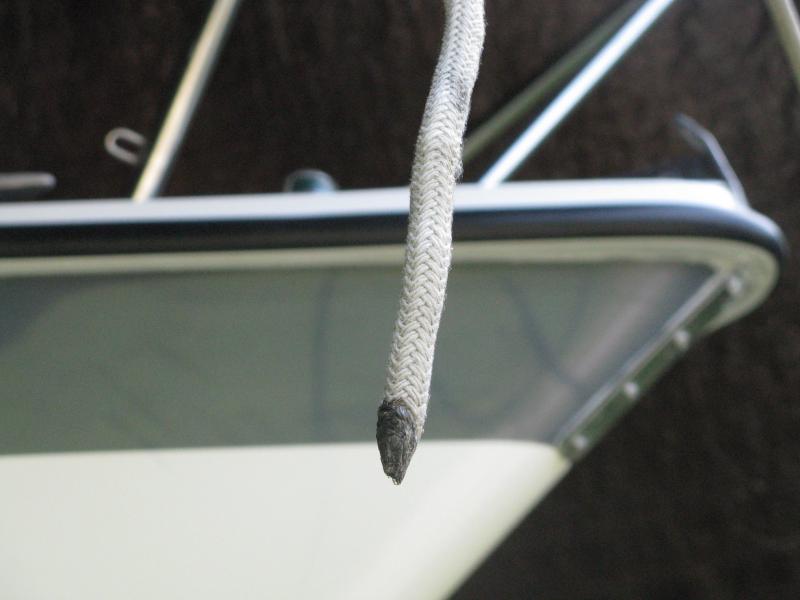

Great info 25, thank you, we can all learn something every day and hopefully now we can do this correctly when the time comes. What is your third picture trying to show? It is a picture of the end of a line dangling from your boat or enclosure? Not sure how it fits into the context of your post.

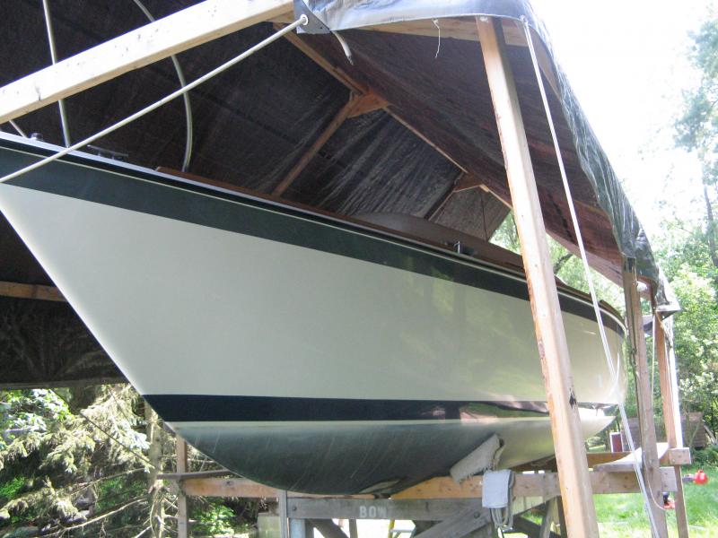

One other thought, the boat looks fantastic. What are you doing with the below waterline section? Is the hull barrier coated? Will this just be in fresh water lakes and hauled each year? It looks like you have bottom paint on it, just wondering if now is a good time after it has dried out for a long time to do a moisture check, soda blast and barrier coat? Would take a bout a week with all the time to dry the multiple coats.

Will do e-pod. hey jibes, good questions all. The line, not quite sure. Maybe the mate is trying to tell me mutiny is in the offing. Bottom was previously barrier coated by a previous owner. Well at least they got that right. There wasn't a blister on it. This has been a fresh water boat hauled every winter so far as I am able to track. I will be keeping it's home port here on Lake Ontario and have it hauled when the water is about to get stiff. The heat gun was a Wagner model HT1000. Yes they are great for shrink tube and I often use them for that purpose. The finish her up list is down to about 15 items then I will be proceeding to the mast. At this point I am looking at Alodine to bring back the gold color. Nasty stuff but does work well on aluminum. So ta everybody for now but I'll be back.
