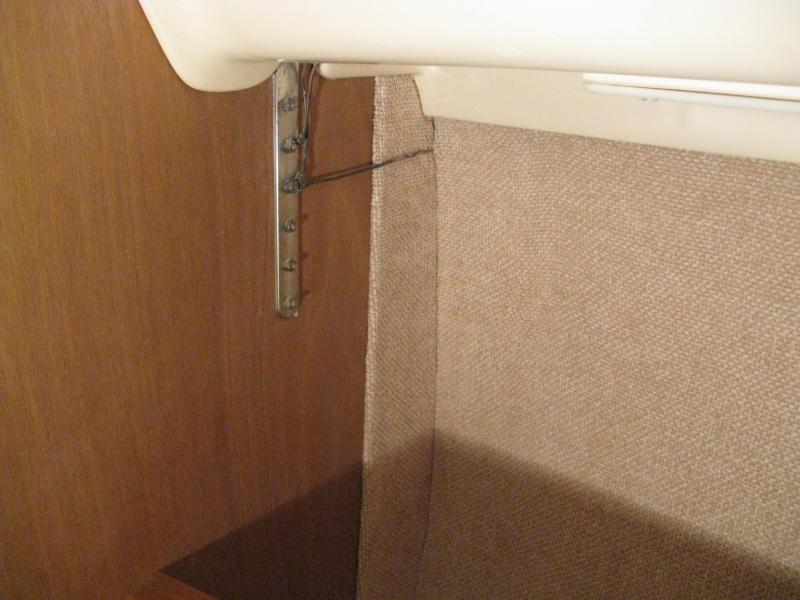

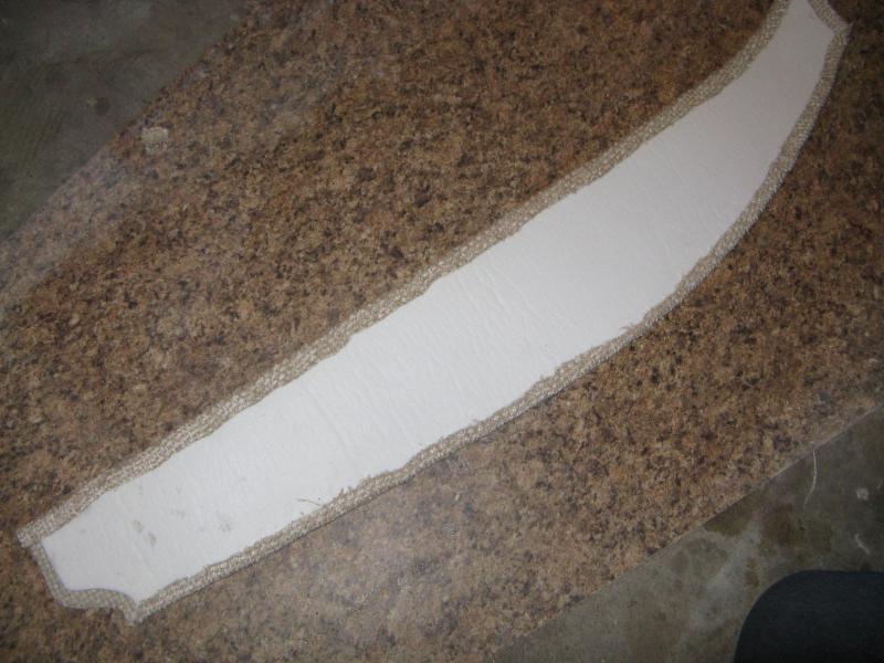

Don't bother me now I'm on a roll. I'll share a taste of coming attractions. First a word about gititdoneitis, which is characterized by a marked propensity to slapertogether. Not with a fanatic like me. So after what was almost a disaster bonding foam to hull and cloth to foam I bonded cloth to foam and the whole shebang to the hull. Works much better and you can do a nifty roll and tuck for those pesky edges and bottoms. Here's a few photos to give you an idea of how to eliminate the teak trim strips that invariably crack at the first hint of a nail. Another dodad was a recessed deck plate that winds up flush. I'll cover that tomorrow. So here we go. Cut the foam accurately to the shape you want. Spray it up along with the cloth and bond with the pattern orientation you're after. Spray the back edges and roll the cloth around the edge and onto the back. Viola a nice neat edge. Bond to your hull or bulkhead and you have a lovely straight edge without any edgeing necessary.

Hi bria. That is the back side of the foam/cloth piece you see on the bulkhead next to the chainplate. What I am showing is the edge that rolls over to the back. Just trim your edges so that about 3/4 inch bonds to the back of the piece for a finished look when seen from the front.
