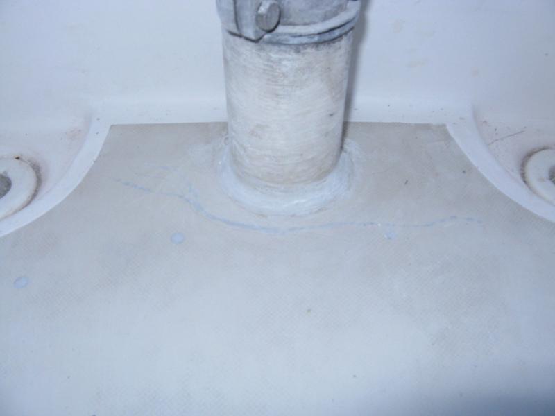

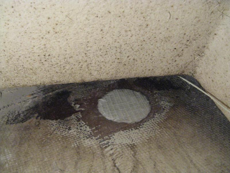

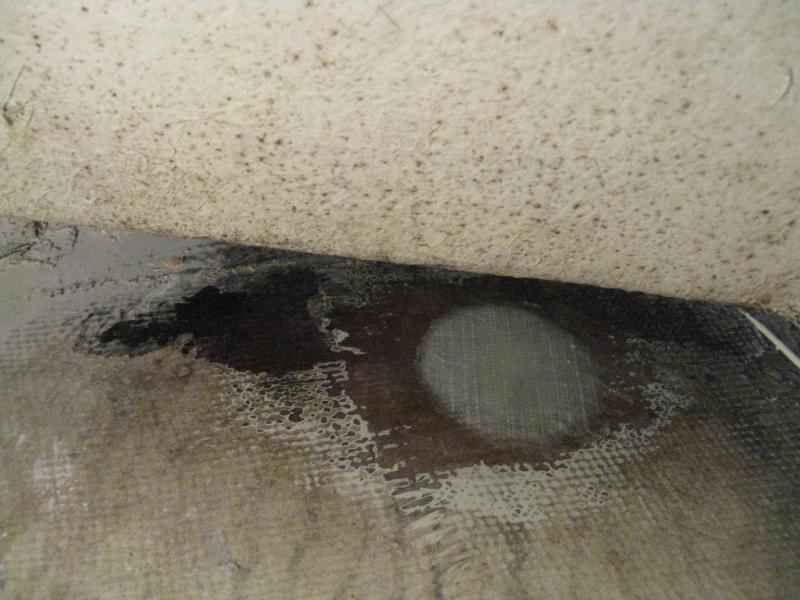

The internal bevel and patch episode. With the plug installed it's time to finish up the internal backup patch. Since the plug was 1/16 inch below the inside of the hull a slight bevel was ground out to 4.5 inches. This had successive layers of +/-45 biaxial cloth (3 each) at 3, 3.5 and 4 inches applied with epoxy. The final 4.5 inch patch was 0/90 biaxial. No particular reason other than it matched the roving so that when it is painted it isn't as noticable. So with that the hull remains smooth internally without a bump and is very strong. Next up the outside fairing.

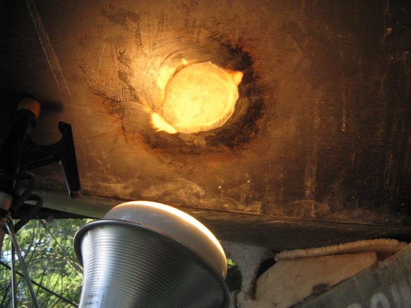

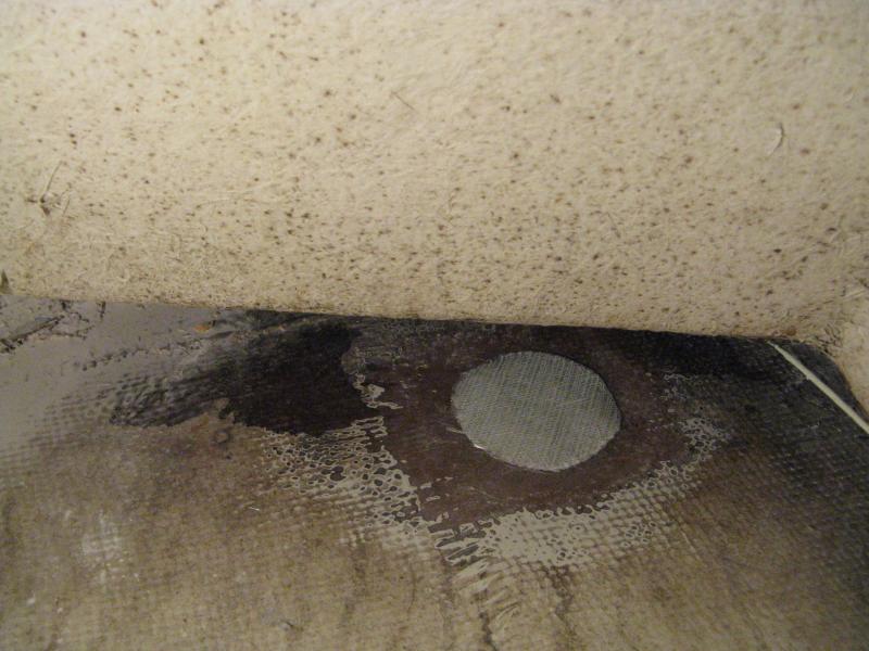

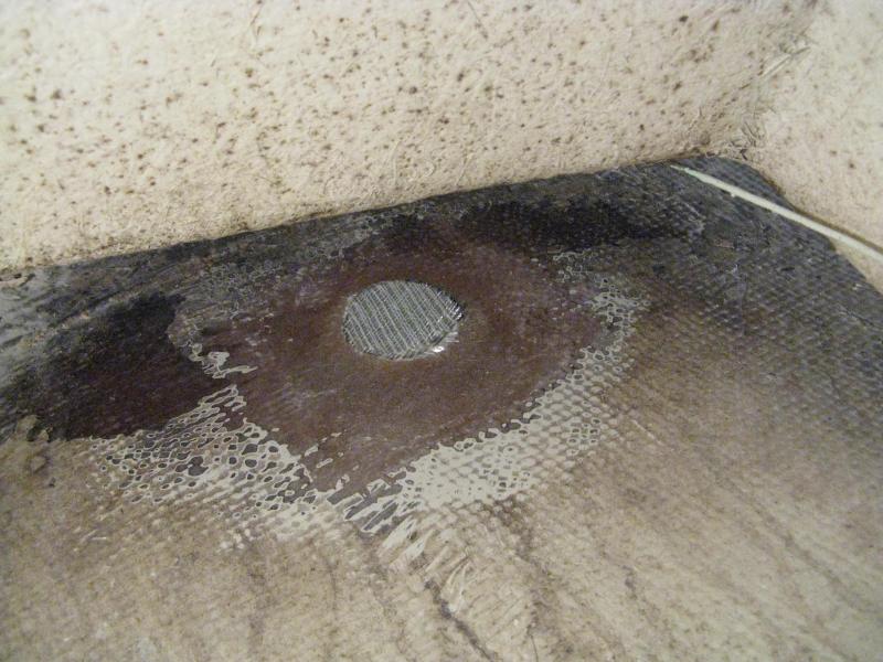

Well there it is. Sand and coat with 6 coats of epoxy and paint. The plug was overfilled with epoxy and 404 high density filler. That's all there is to it maine89. That's a heat lamp by the way since spring doesn't seem to want to arrive.

That's the creepiest looking thing I've ever seen. Looks like an eye from a reptoid that came down from outer space to give you some free advice. Maybe it will be more appealing once it is painted.
Aug 20, 2010
1,399
Oday 27 Oak Orchard
Damn, my secret is out. Yes aliens have coached me through this process. They have shared advanced techniques and materials in exchange for the occasional alien prostate exam. OOOHHHH and out the nose comes the coffee. :eek:

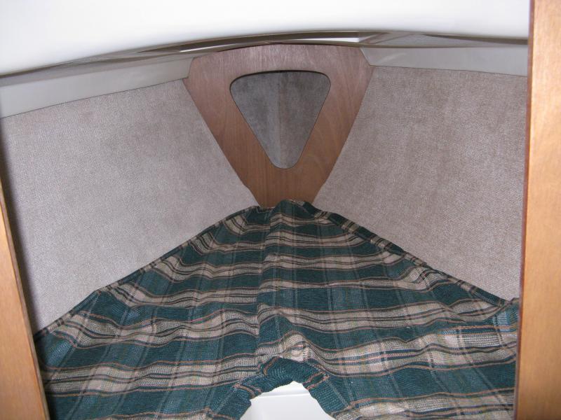

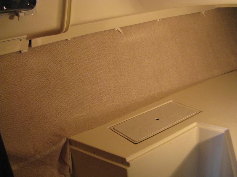

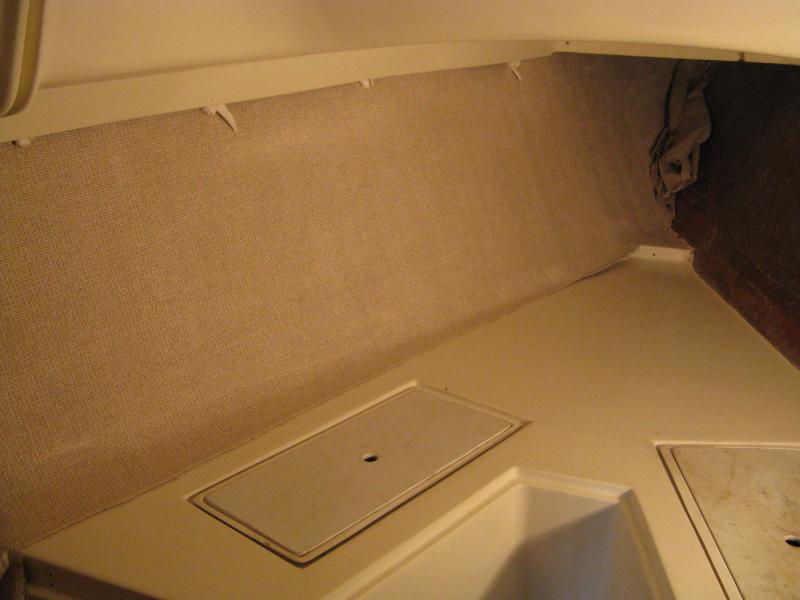

So it's raining but at least it's 73 degrees. That means, oo baby, hull liner time. First as discussed previously the Volara (closed cell polyethylene at 1/4" thick) foam was cut and bonded to the hull using 3M High Strength 90. That should be sufficient as the high temps are low enough to keep from adhesive failure. Let's hope on that anyway. The hull liner being fitted for bonding with 3M Super 77. This product is clear so any bleed through will not show. I did test this to make sure but let's not be sloppy. So here we go. And yes this cloth is a polyester blend virtually original to the scraps I recovered after removing the interior and subsequent Ozite stuff. I will give it a good spray of Scotch Gaurd when complete.

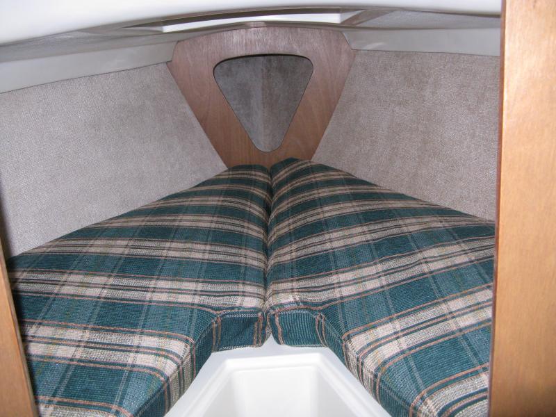

OK. Well the cockpit floor has been epoxy injected. Drilling a grid around the affected area at 4 inches was sufficient to dry it out using a heat lamp. The telltale dark color disappeared as the moisture was driven out. Screwing a piece of plywood covered with polyethylene from the top clamped everything together while the epoxy cured. The plywood was on the bottom bye the way. Now for the other thing. The foam was bonded with 3M High Strength 90 to the hull. The fabric was bonded using 3M Super 77. This stuff grabs like mad so you only get one shot at it. Working in sections at about 2 feet per time made it manageable. A line of masking tape was run along the top edge prior to glue up to aid in repositioning the fabric as it is easy to distort or shift from its' best position. And just to see how this would look. The unstuffed cushions.

v-berth looks great

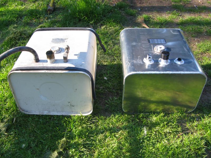

While we're on the topics of tanks, here is the new one. It is less length than the old one by 1.5 inches. This will require a larger seat rail for it to sit in it's original cradle. Also we have the cushions underway with foam from www.foamdistributing.com and I might add the HD36 is plenty firm. Cut with an electric carving knife to shape and you are ready to stuff it in the covers. This is inexpensive enough to replace at the earliest hint of mildew but bears noting it isn't flame retardant as some of the higher cost foams. Lastly the rudderpost was ground out with the Dremel and a carbide burr and filled with epoxy and high density filler as a result of delamination of the cockpit floor.
