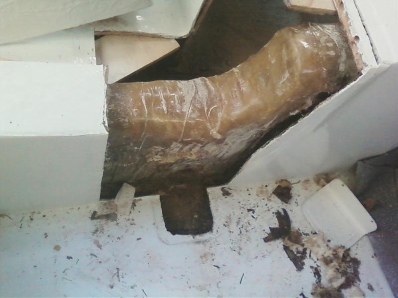

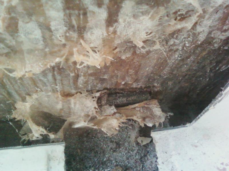

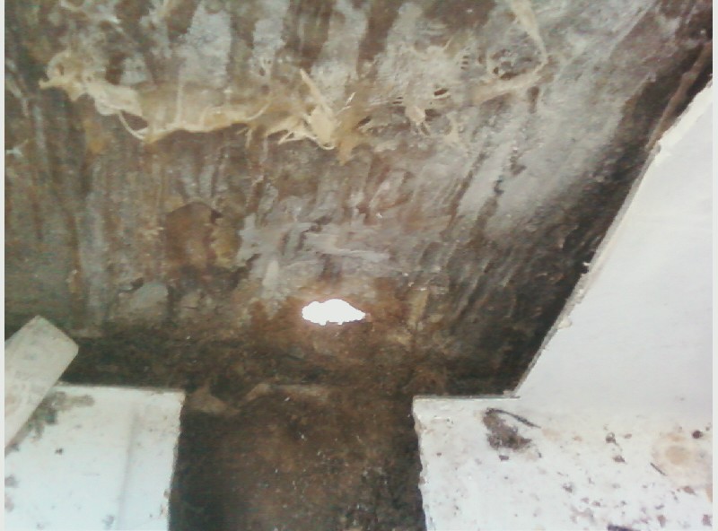

And I fitted out a SS pivot bolt. While I was checking the fit, I was cleaning up some "mud" that was in the pivot hole and noticed that the mud had wood fiber in it...:naughty: So I got worried and cut an access hole to the pivot pin. Dang..... to say the repair job was halfa$$ is an insult to all the Gomer Piles of the world.... (see pic #2)... There was no way to get a good dry seal around that.... so... I had to remove it entirely. See the next two pics. I'm going to make a backing plate out of Trex tomorrow.
