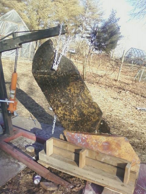

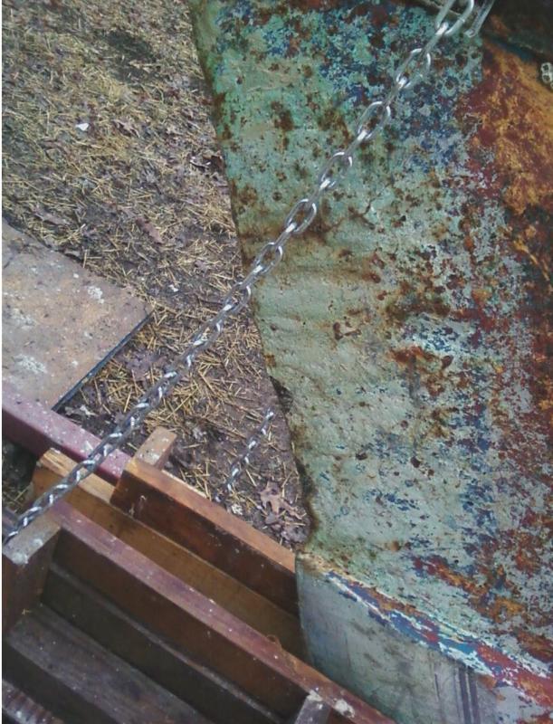

So yesterday (Friday) I was able to leave work at 2:00 and I spent 'till sundown chipping the rust scale off of my keel in preparation of sandblasting.

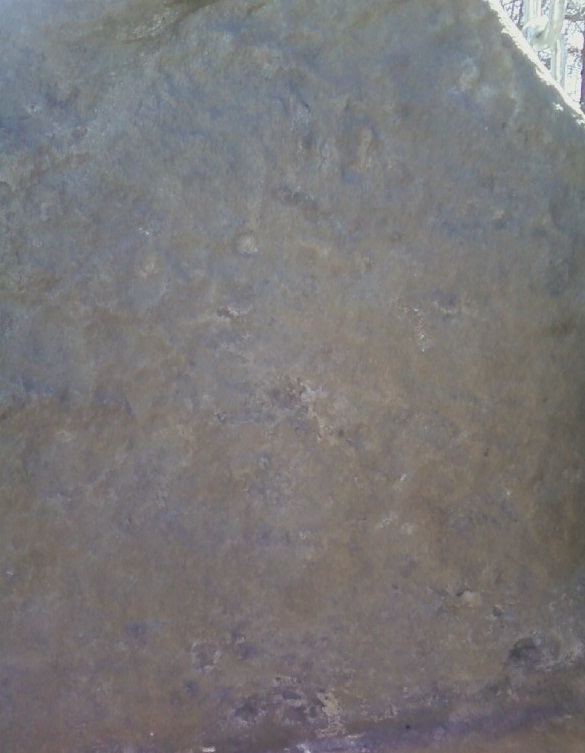

Here is what I learned... needles scalers are good for getting off the small stuff but when you have some serious compromised metal to remove you need to hammer it (see pic #1 & 2).

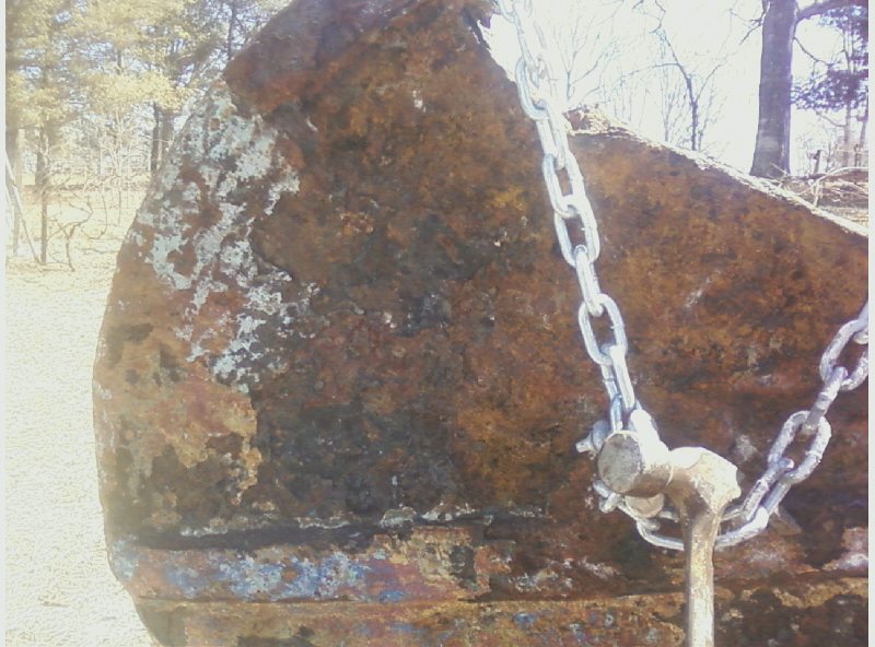

After about 5 hours of banging with my hammer and following up with the air needle scaler, I had quite a pile of rust scale (see pic #3). I was not yet happy with the results but I was out of daylight so I put some rust treatment on the exposed metal (see pic #4).

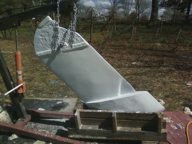

Today, my arms hurt so much I could not even thing of swing a hammer all day... and I broke down and spend $45 on an air hammer and a set of chisels. (see pic #5 for a stock photo of the air hammer I got)
Oh man that was the right move. I got done in an hour what took me 5 yesterday... and I'm sure the quality of the job is much superior. I ran out of day light again so I don't have a pic of the other side yet. But I think I'll go back over the other side tomorrow.
Anyway, I'm very near ready to sandblast. Waiting on a warm enough day to follow with epoxy barrier coat before I expose that raw metal.
If you ever need to do a job like this.... buy the air hammer. I got a really nice 10gal compressor from Tractor Supply for $99.99 and the air hammer for another $50. I'm still way ahead of what a yard would have charged me AND I have a few new toys to boot. :D

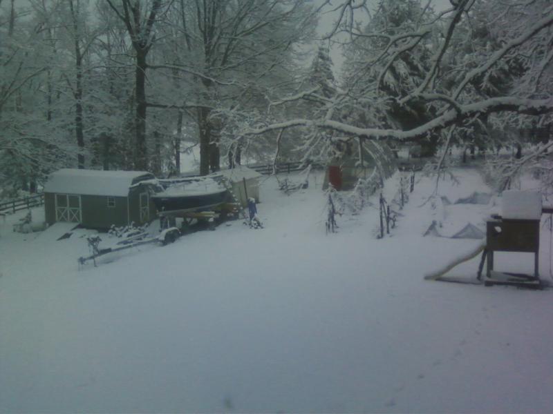

Got the scale off of the other half of the keel yesterday morning. About noon the snow started. This is what I woke up to today.
Calling for more today and tomorrow. Looks like it will be a few more weeks before I can get the keel sandblasted and painted.
This is not normal for central Virginia in late March.

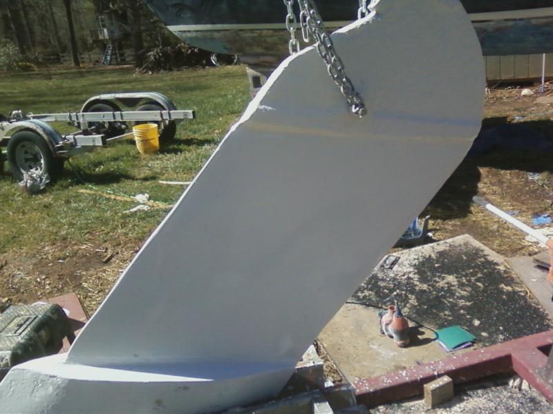

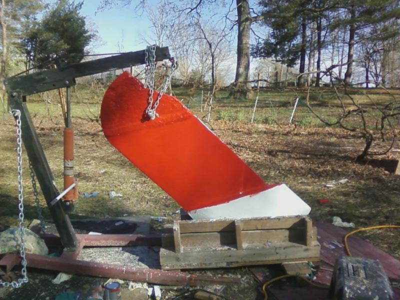

Well we finally got some warm days and I was able to do some epoxy work. The keel is looking good and nearly ready to put back into the boat. Here are some pics.
The first two pics are a port and starboard look at the keel after I had resurfaced, faired and repaired the leading and trailing edges. These pics also show the keel after three rounds of barrier coat, followed by sanding. The lead bulb is not yet faired and will have to wait until I move the keel back into the cradle.
The third pic is after the first coat of paint. I have some 180 grit that I'll sand it with in the morning and apply a second coat.
The third pic is just a reminder of what it looked like when I started.

Thanks T-Kanz
I've attached a pic showing the yoke. I had some trouble getting the keel back in the cradle ... so I could lift it like so...
In the process I scrapped up my paint job.
After I sandblasted, I treated the surface with rust remover, rinsed, and polished with a wire brush wheel on a hand drill. Then I painted with rustoleum's "severe rust primer" (three coats). Then body filler. Then two coats of 2-part epoxy barrier coat. Then another two coats of rustoleum to protect the epoxy from UV-degredation.
I still need to fair the bulb. some of that will be grinding and some filling. The bulb has several layers of something hard on it already so I don't think I want to try and remove that. I'm going to grind down the big bumps and fill in the deep holes until she is smooth.
I also got the bottom cleaned up and after I fix a few cracks and hole in the hull, I'll put two coats of barrier and a bottom job and I should be ready to splash.:dance:
Something interesting I learned hoisting the keel. The center of gravity for the entire keel is almost exactly where the hole for the yolk is placed.
