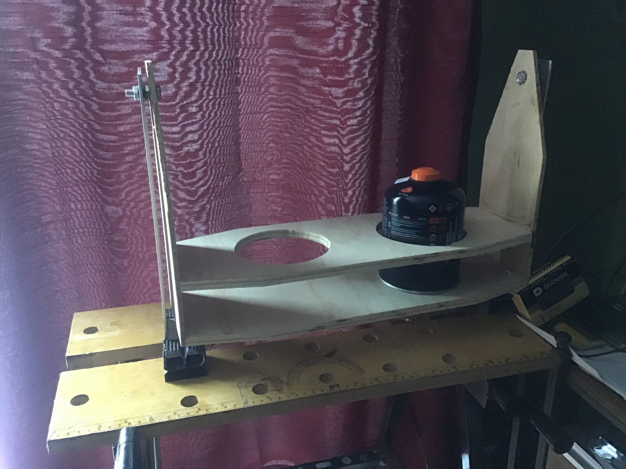

Here is a prototype of my gimballed double jetboil stove, still need to figure out how to install in on the boat and I plan to add a nylon washer to help it swing

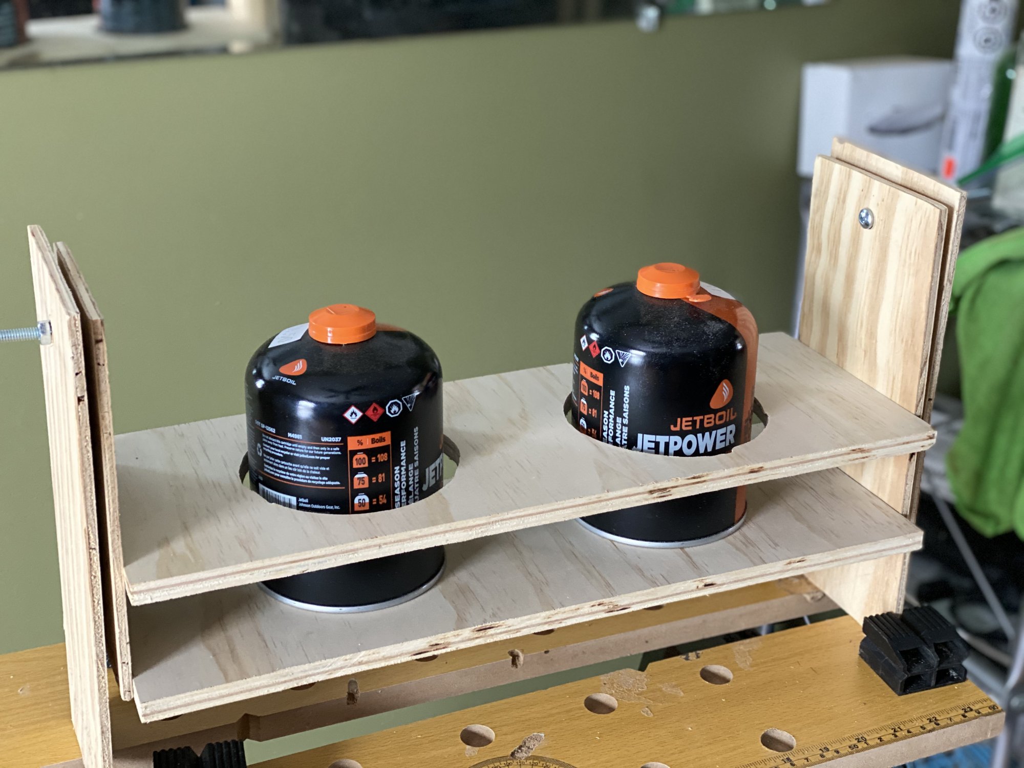

I’ve updated my prototype with longer side arms and some aluminium legs, now I‘m looking on how to fix the legs on the boat.image.jpg

I’ve updated my prototype with longer side arms and some aluminium legs, now I‘m looking on how to fix the legs on the boat.View attachment 173923
You'll have to add weight to the bottom or it will be top heavy the weight will be too close to the pivot point. Try adding the stove and a pot of water, see how it swings.

With the weight of the gas cansters so far below the swing axis, I reckon you have a pretty stable design.
Maybe a bit of added ballast, but not that much.
Once you get the physic worked out I will be right behind you on the build.

As soon as I work out how to fasten it to the boat, I’ll start testing it and get back to you

A full canister of gas weighs less than 2 pounds, 1 pound for the gas and the rest for the canister. A quart of water weighs 2 lbs, plus the pot, plus the burner. That makes the stove itself top heavy and moves the CG up high.
Do some bench testing to work out the bugs first.
Go to images.google.com and search for "single burner gimbaled marine stoves"
Also take at look at this article: The Boiling Point: Five-Way Single-burner Galley Stove Test - Practical Sailor Print Edition Article
