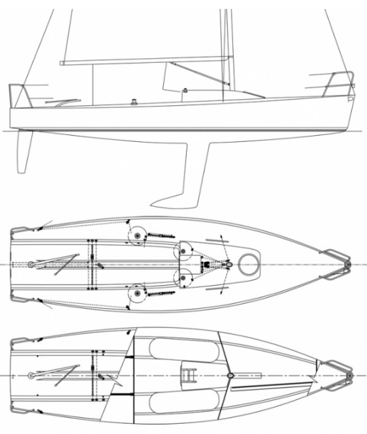

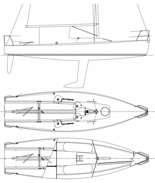

I hoved-to a J90 I used to crew on just to prove to the skipper that it could be done. The J90's keel is about as narrow and deep as they come with a draft of 6'-6" and a keel cord length of about 12".
It was between races, and we were set up for the 15-kts of wind with full main and the 2nd to largest genoa. It took a bit of finessing the tiller and adjusting the main sheet, but I was able to get her stable with the wind about 100º and making only 2-kts to leeward.
