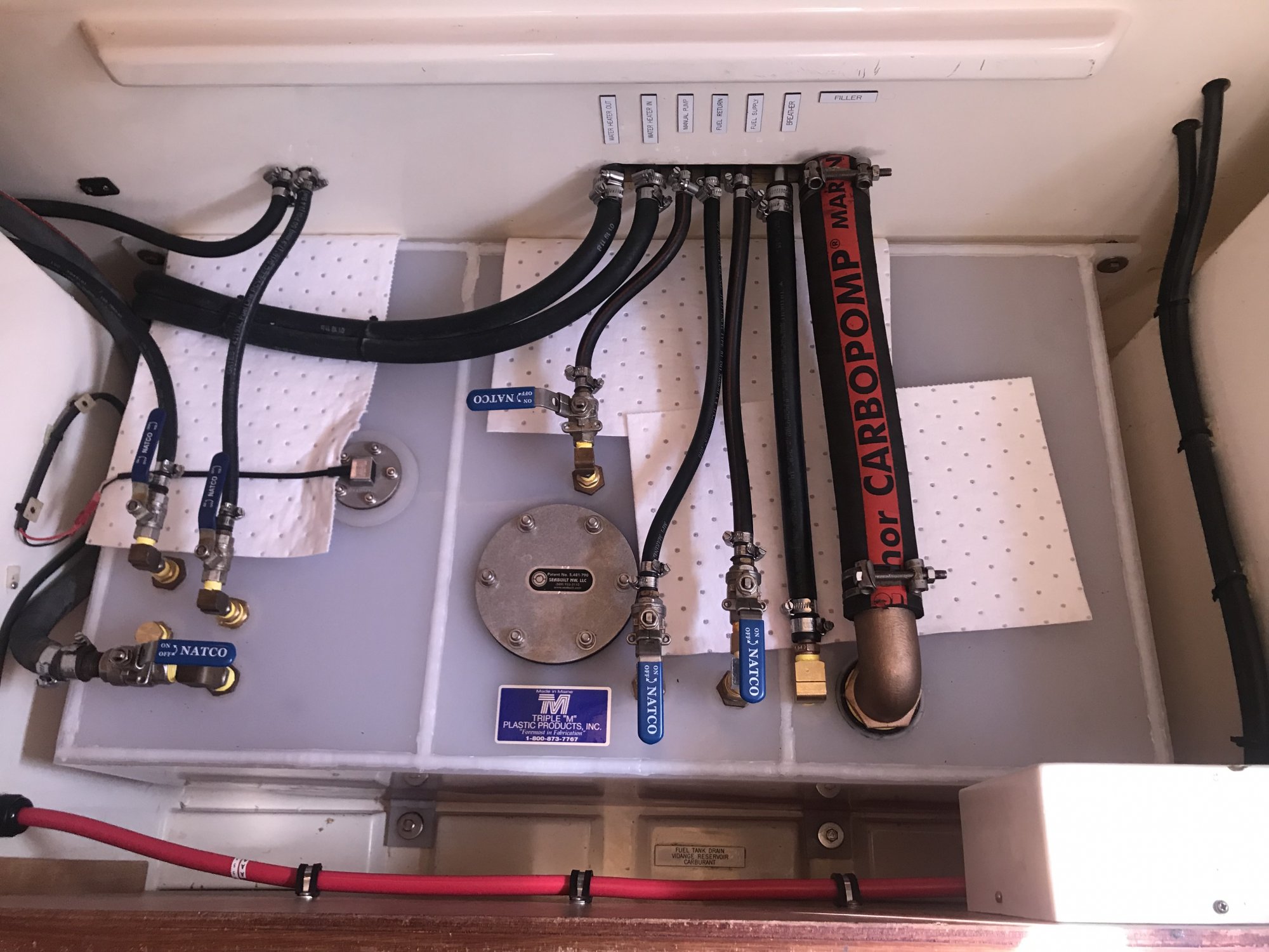

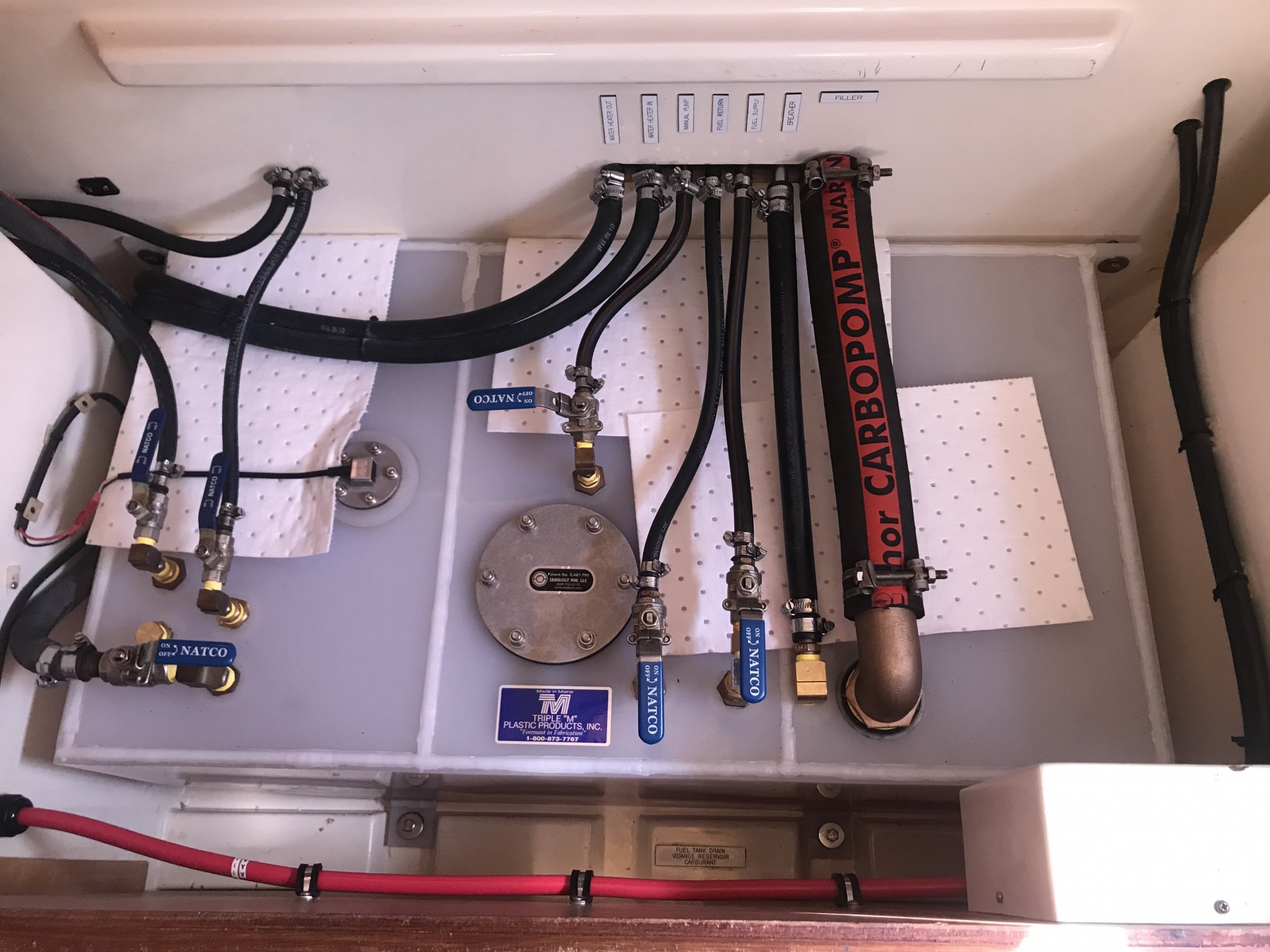

One thing I did was shim the sender up so that the float could get higher in the tank to measure true full. This could also help you get the bottom clearance correct.
I thought of that but I don't have the vertical clearance, the tank's under a setee.
Wow, that's a clean installation! I picked up the cushion and an access panel and the top of my tank is so dirty! I really should clean it.

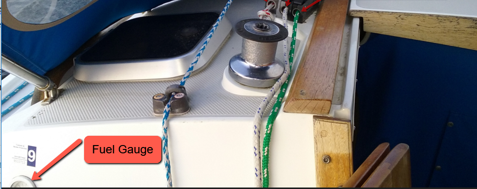

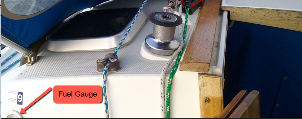

I do not have any complaints about how it measures at the top of the tank. I have my gauge mounted on the aft side of the cabin top.
Very handy there. The original gauge is on the engine panel which cannot be seen at all from the dock when filling.
