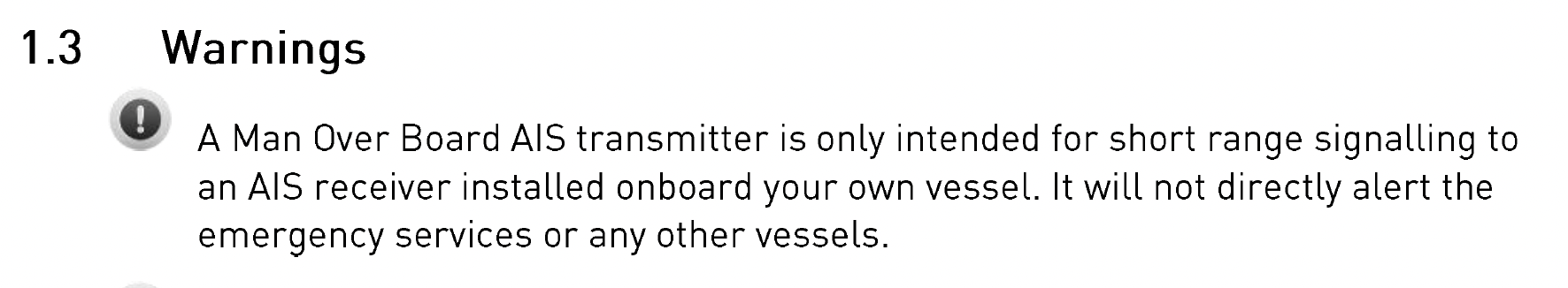

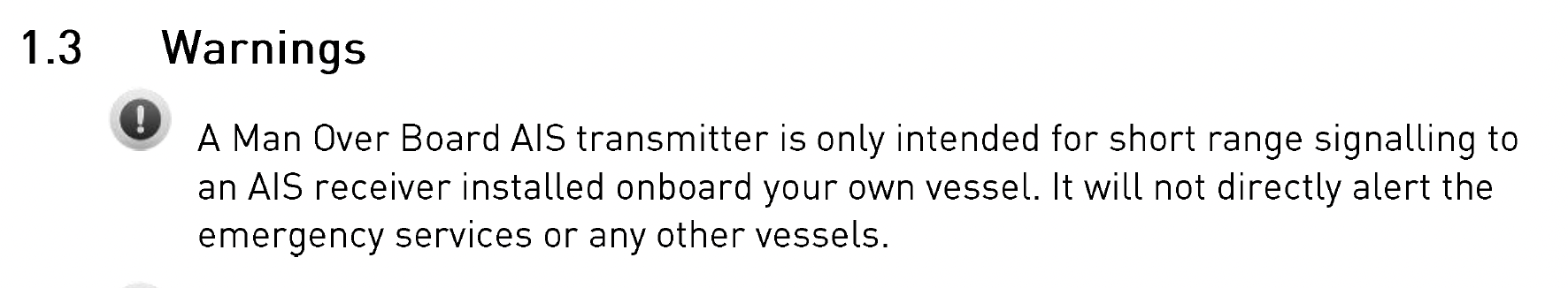

I just read this in the MOB1 manual:
Does this mean other vessels really won't see my AIS position and hear my DSC call from this device?
I mean, I'm solo sailing, there's no one on my vessel when I fall over. :(

That would be a weird limitation. From their website - “The MOB1 communicates with the vessel you have been separated from and other vessels in the vicinity (up to 5 miles range dependent on conditions).”
Maybe the line in the manual meansit can communicate with your own boat because it should certainly be close enough (but others might too)?

The DSC signal from the MOB1 is a VHF signal from a low powered device. As such it is limited by line of sight. Since it will be at 0 feet above the water, the line of sight distance will be short.
The USCG Rescue 21 system is designed to receive any signal that is up to 20 miles off shore transmitted from sea level by a 1 watt transmitter. The MOB1 has a .5 watt transmitter. Thus, the closer you are to shore, the more likely the signal will be received by the CG.
The DSC function is designed to notify your boat. The AIS distress signal will be sent to all vessels and will set off a AIS alarm on nearby vessels including your own boat.
