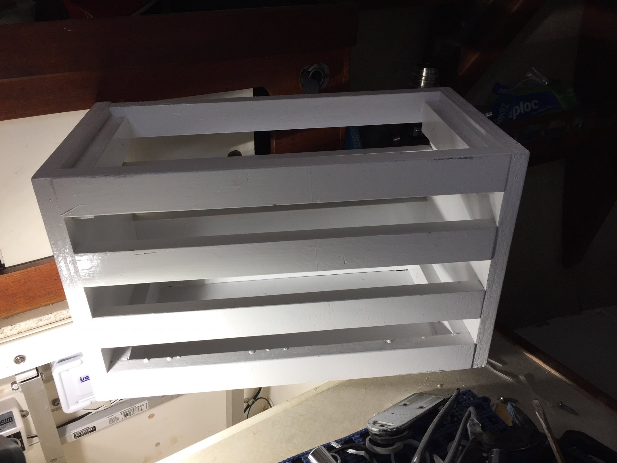

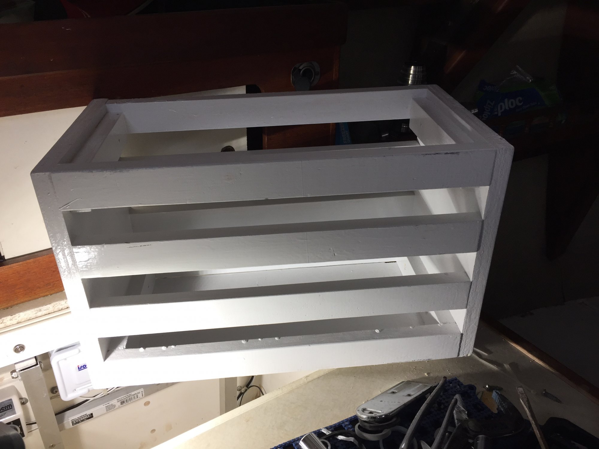

Regarding old ice box conversions: Most old ice boxes are deep top loading types. This design was fine with the bottom filled with ice. Once converted to refrigeration you have a very deep refrigerator. What are you going to do? Fill it with food and beer? You will not see the stuff on the bottom until Fall when you empty it out for the Winter. Consider building stackable boxes that fit in your space. You can lift out the top box and then the bottom box for total access.View attachment 189699View attachment 189700
