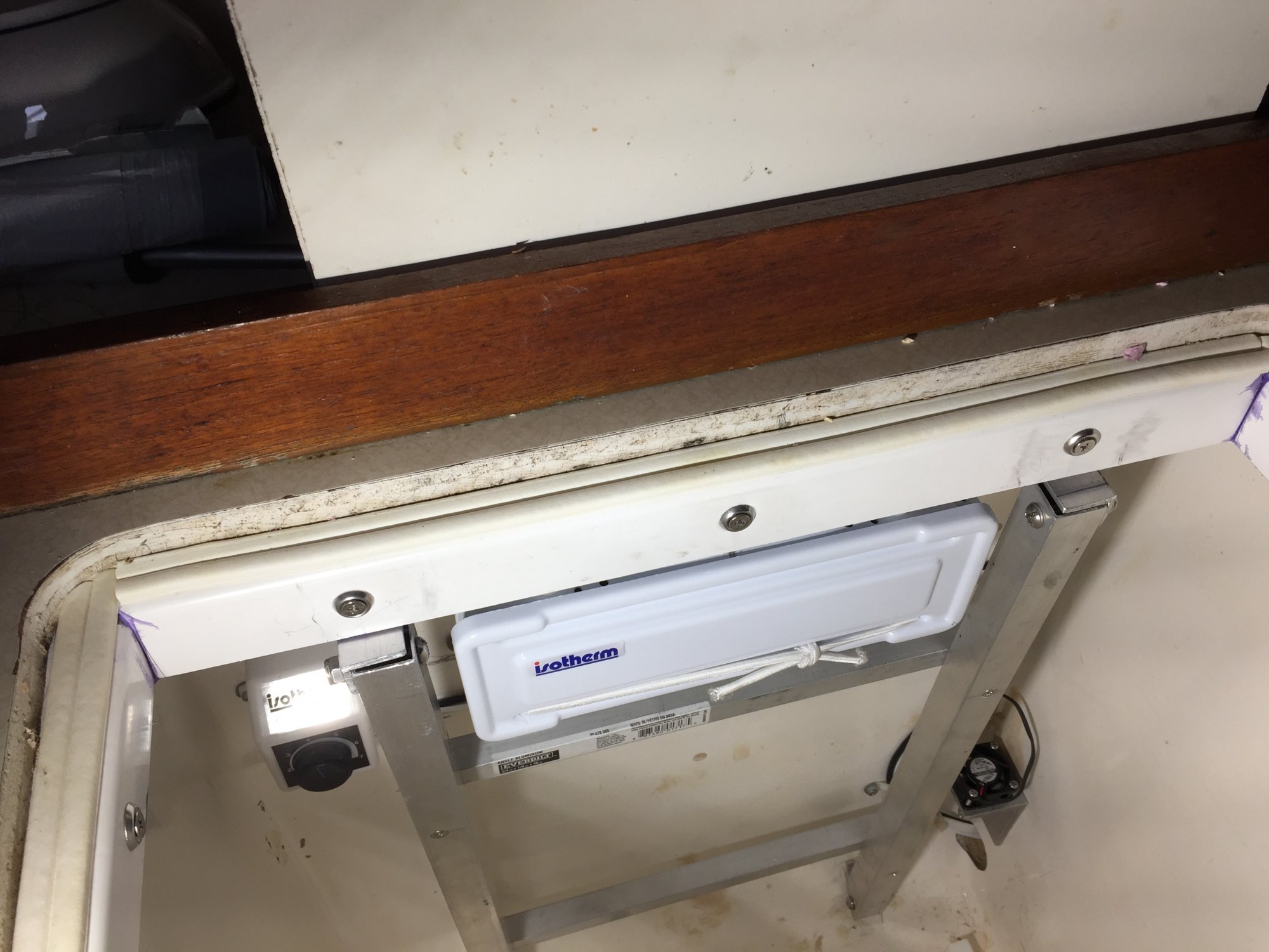

This post has a few years on it. I'm getting ready to add refegeration/freezer ane was thinking the ice box near the sink, however the aft icebox would allow for more room. I've got 320 watts of solar powering 2 GC T-105s.
Any "lessons learned" that you can share would be appreciated.

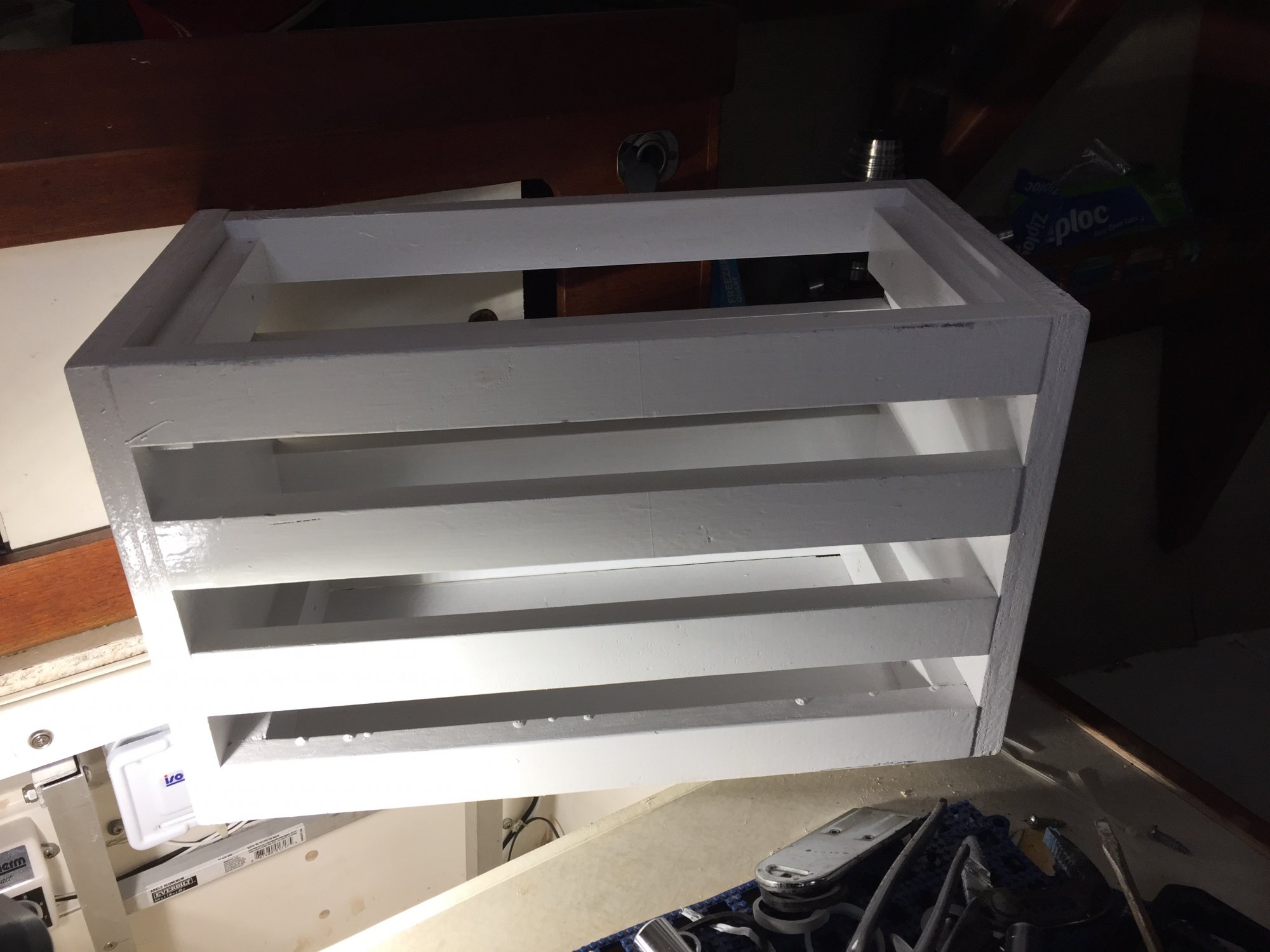

Regarding old ice box conversions: Most old ice boxes are deep top loading types. This design was fine with the bottom filled with ice. Once converted to refrigeration you have a very deep refrigerator. What are you going to do? Fill it with food and beer? You will not see the stuff on the bottom until Fall when you empty it out for the Winter. Consider building stackable boxes that fit in your space. You can lift out the top box and then the bottom box for total access.

Thanks, I've noticed that the portable refer/freezers have baskets for the same purpose so was thinking that would be a good approach to prevent the "lost" products. Is the freezer section inside of the Isotherm evaporator and the cooling air spilling into the remainder of the box?

One thing that would favor the ice box next to the sink for refrigeration is that running the engine for a while heats up the aft icebox considerably in warm weather.

Good point. Been looking at the Isotherm self pumping system that replaces the galley sink through hull with an integrated condensor coil. They recommend that the compressor be located under the sink. Seems like a great alternative to an air cooled system.
The forward icebox is certainly more convenient to access. I use that one instead of the aft ice box. The attraction to the aft one for me is the increased capacity. I'm assuming that in any case I'll end up adding more insulation which will consume some of the volume.
