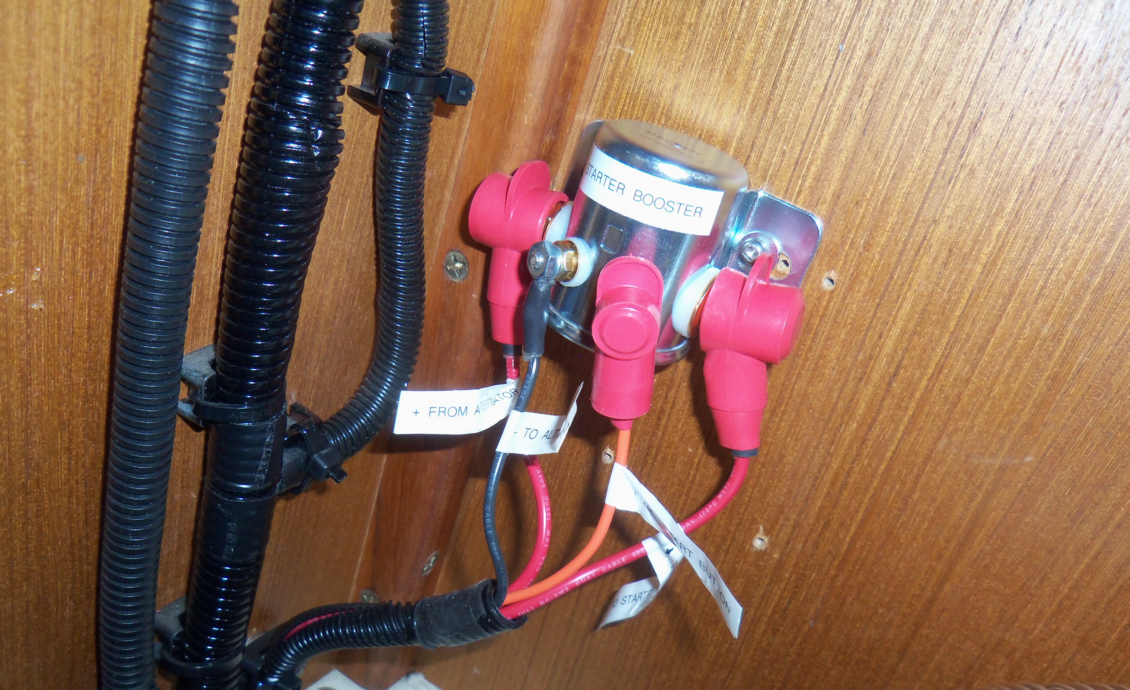

I was thinking 10ga for the power in and out, and 14 for the ground and switch.
Should do the job perfectly.
#16 would be adequate for the wire from the starter switch as it is only required to supply about 0.5A for the Cole Hersey relay.

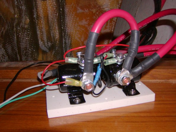

Ralph, here is a photo of 2 relays I installed near windlass motor to lower and raise the anchor with wired remote switches from the cockpit.
I included diodes in parallel with the coil, they are inside the blue shrinkage tubing.
