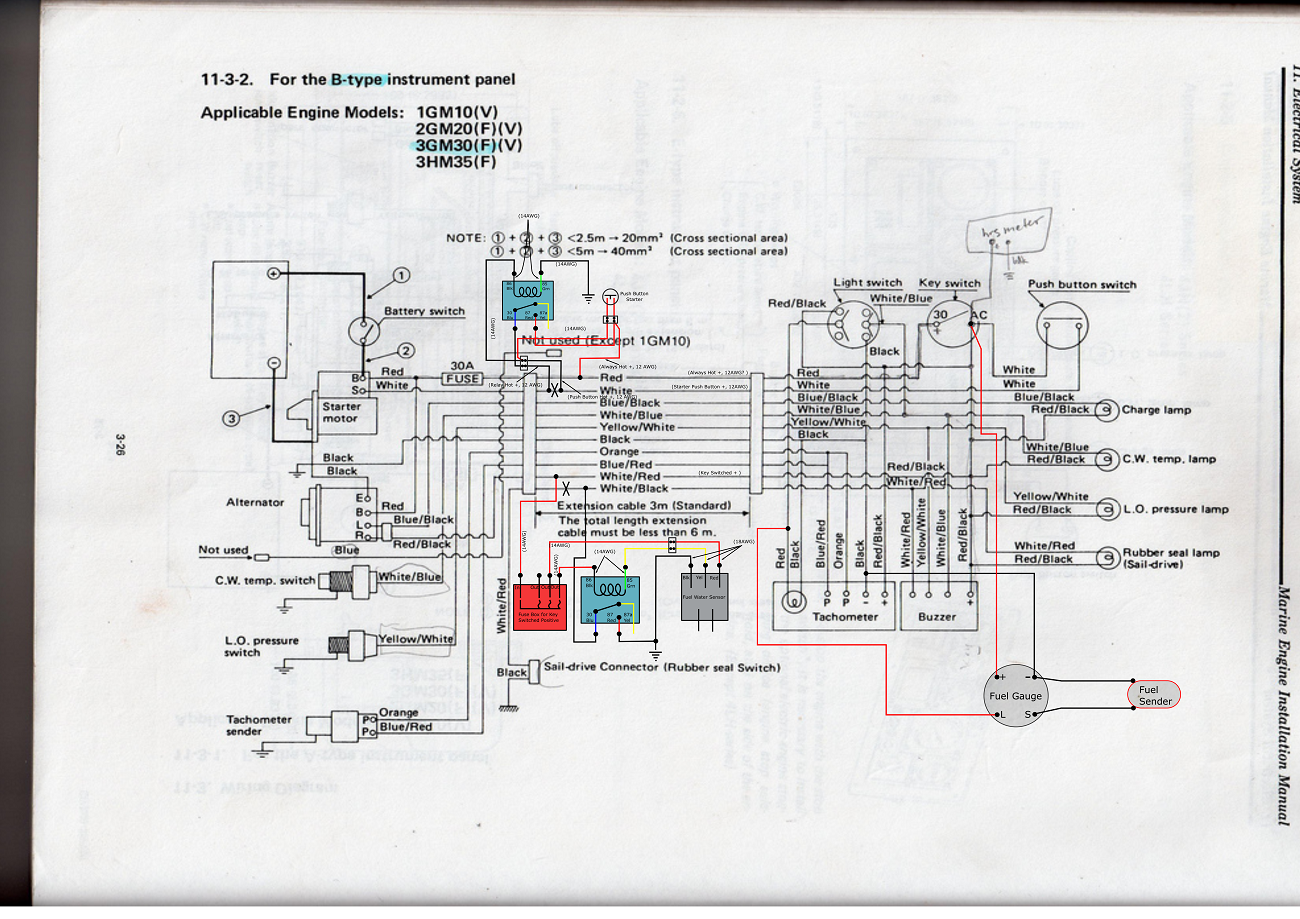

Here's a wiring diagram for the GM series. I grafted in a starter relay with an additional starter button down in the engine compartment (to help with engine fuel bleeding and such). It also includes my additions of a lighted fuel gauge, and a Racor fuel/water sensor with relay (turns out the B panel has a unused saildrive light that says "Water" and is wired all the way to the engine. Perfect for re-purposing for a fuel/water sensor). All the relays are standard automotive relays that push into sockets. Easy to replace if one fails.
