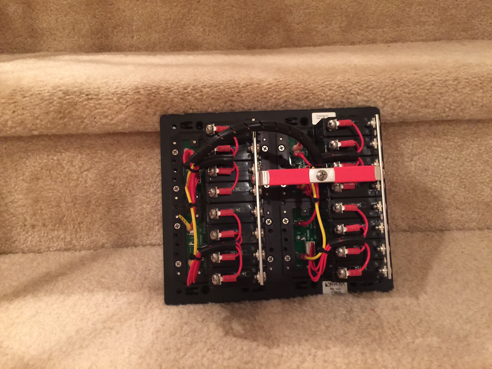

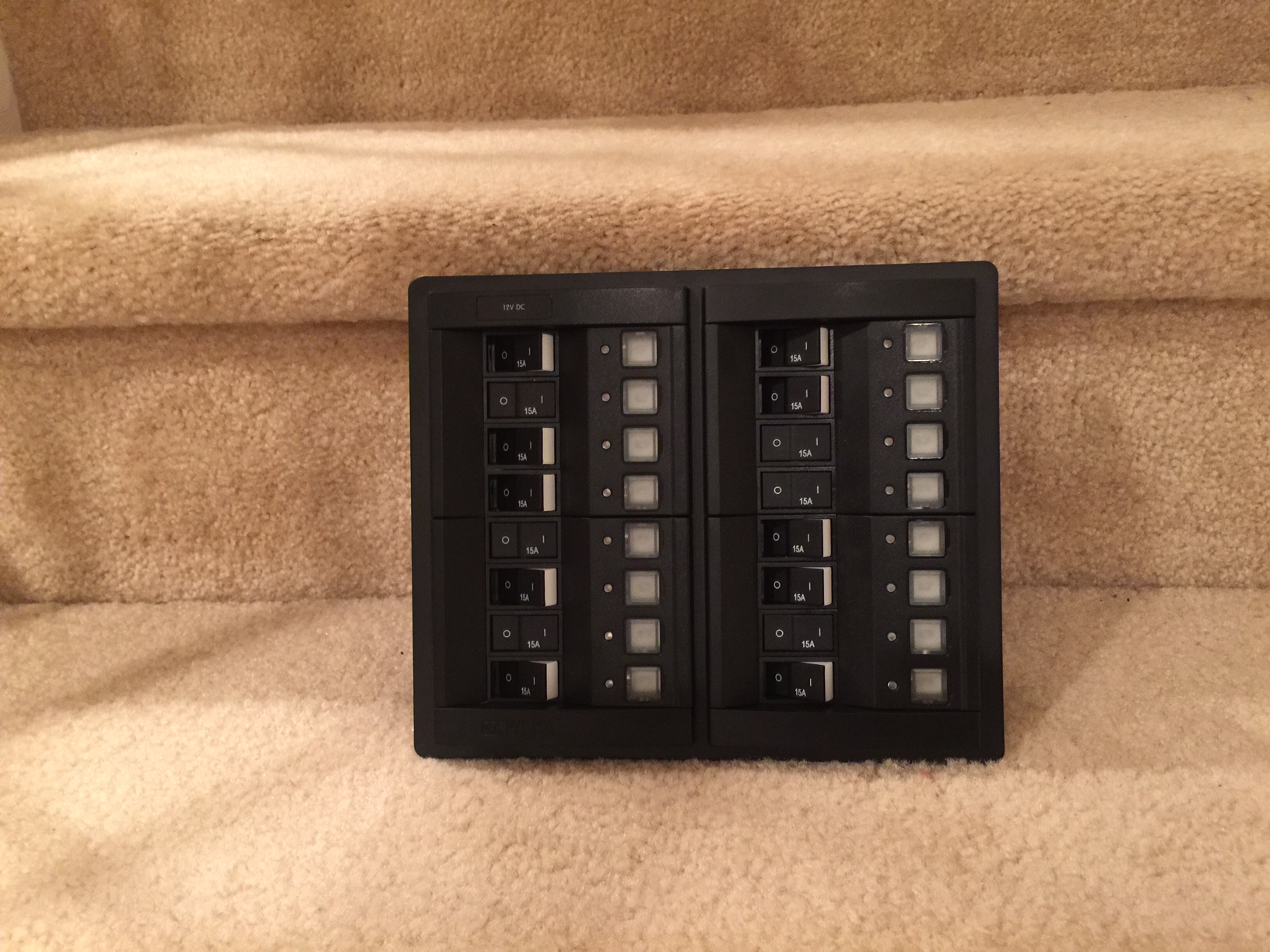

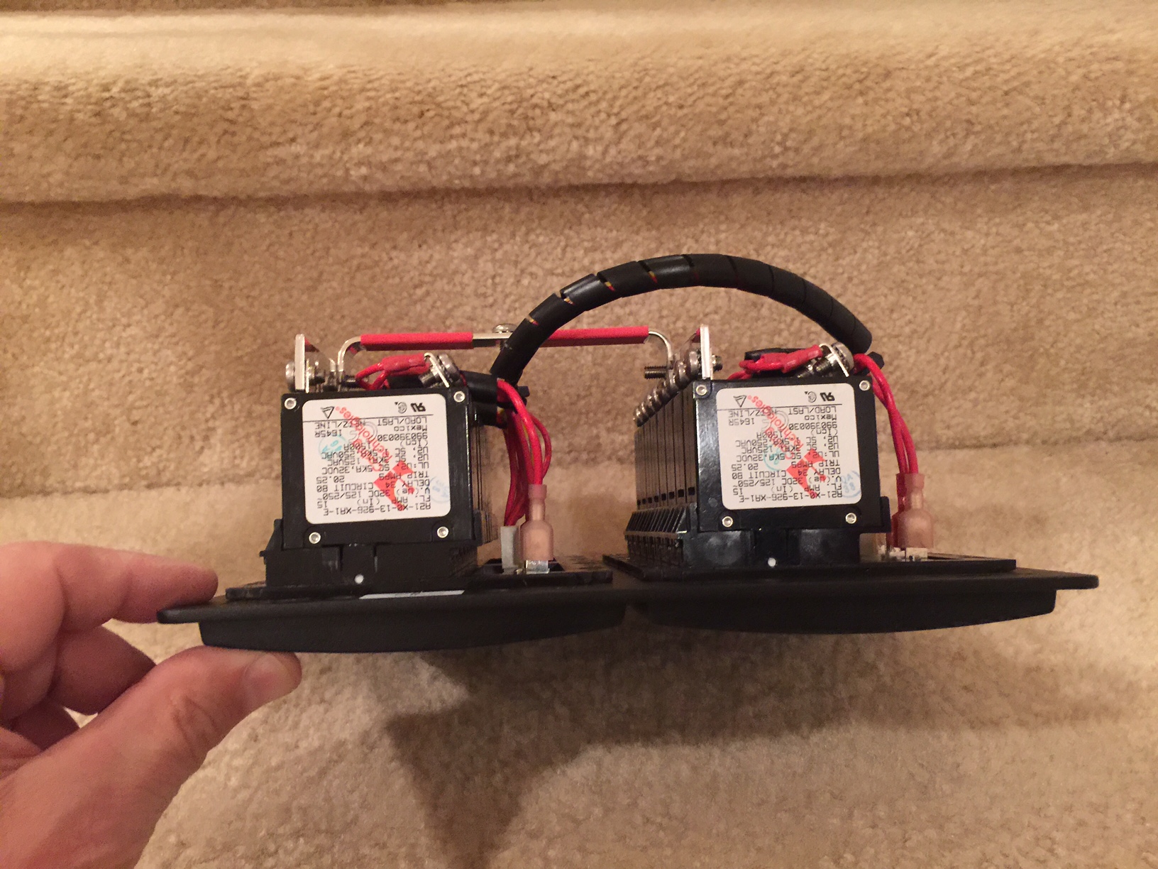

Here are a few photos of the 16 position DC Panel (yet to be installed).
Very simple and elegant with the rockers. As you can see, it is very easy to see the difference between off and on, both with the white sidewalls and the LED indicator. Obviously, I haven't mounted the backlit labels. I'll mount the LinkPro monitor and other selected gauges independently on the front panel. There is a very solid, fixed position when the rockers are engaged. There is no mistaking the position. I guess I also just prefer the feel and look of these as opposed to the toggles.
