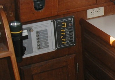

I have my options open. Currently
the DC panel(on left) has 6 toggle breakers, an Off/1/2/both switch and an analog meter.
The AC has a 30amp main breaker and 5 AC sub circuits.
While the 5 AC circuits appears to be ok in the refit I think I want to add more DC options so I can have fewer combined circuits (i.e. lights and propane sniffer on same circuit). These are so old the lights are difficult to identify if they are on or off. I think I like the toggle in that it is easy to identify on or off condition.

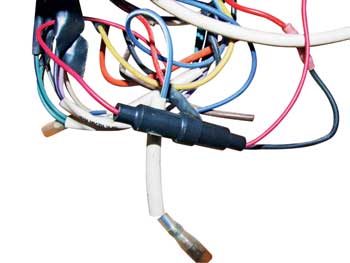

Maybe. So you use a fuse as a breaker. But think about how devices are fused. How close the fuse is to the device. There is reason for that. The wire between the fuse and the device is unprotected, so they minimize that. If the short happens in the wire between your suggested fuse/breaker and your device, your device will likely fry. So mmost are like this harness. The fuse is 3 inches from the radio.
