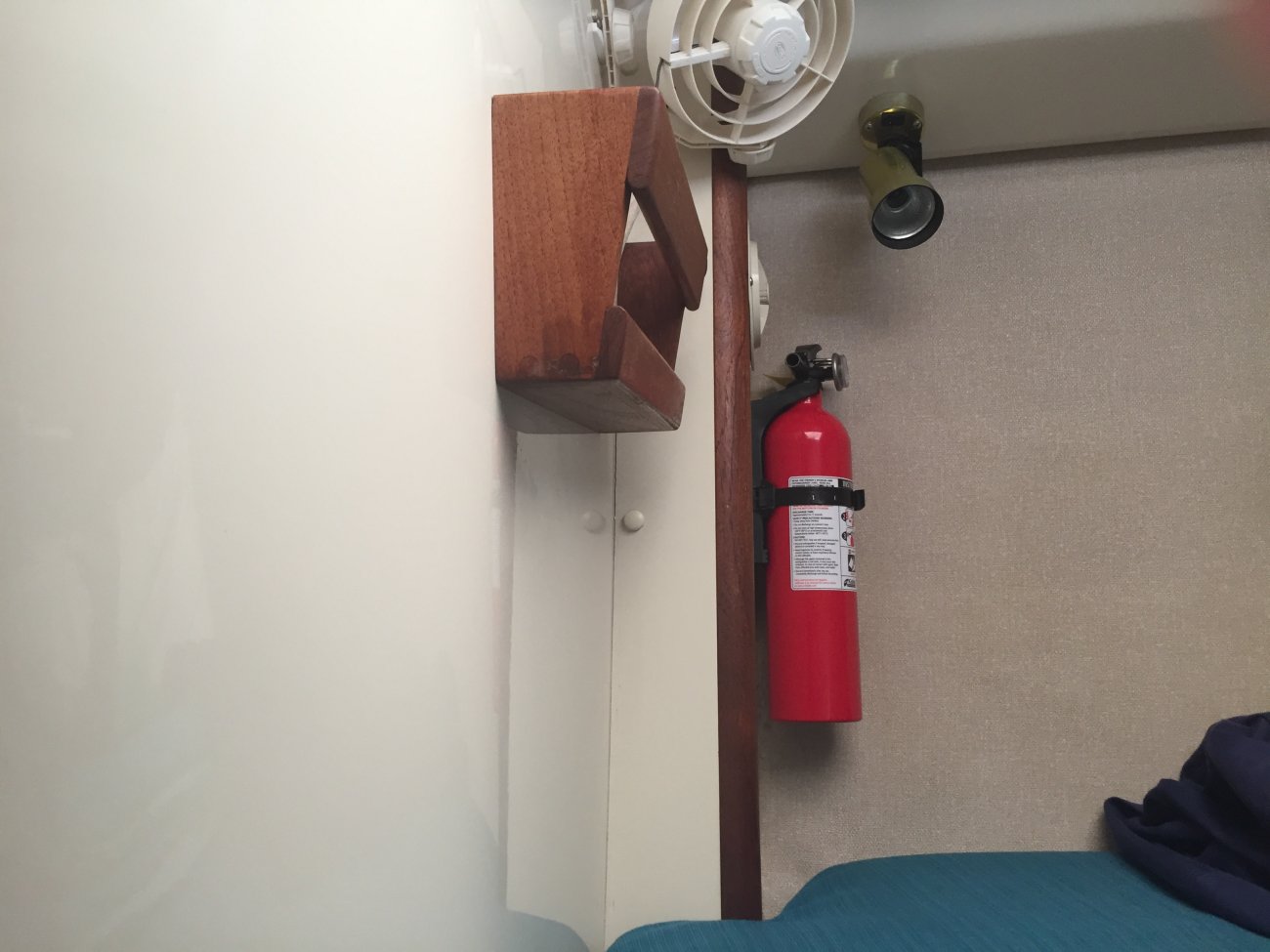

Frank, no curved soft panel on the starboard forward side of the aft head, just above the vanity?
How about in the V-berth, port side aft just down from the spot light?

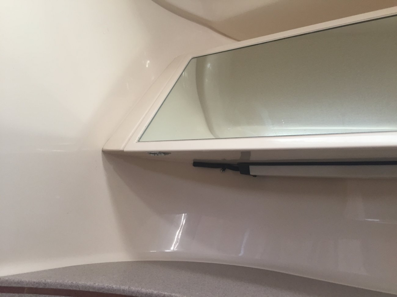

Hi Rick, definitely no removable panel in aft head. In forward cabin adjacent to the head there is what looks like removable long straight panel. As there is no problem now I did not look into it.
The aft head now discharges directly out. I had the yard do it, it was PITA and cost an arm and the leg but we are ok in the Caribbean.
Huh! Maybe a running change. I'll take photos of mine next time I am there and post them for comparison.

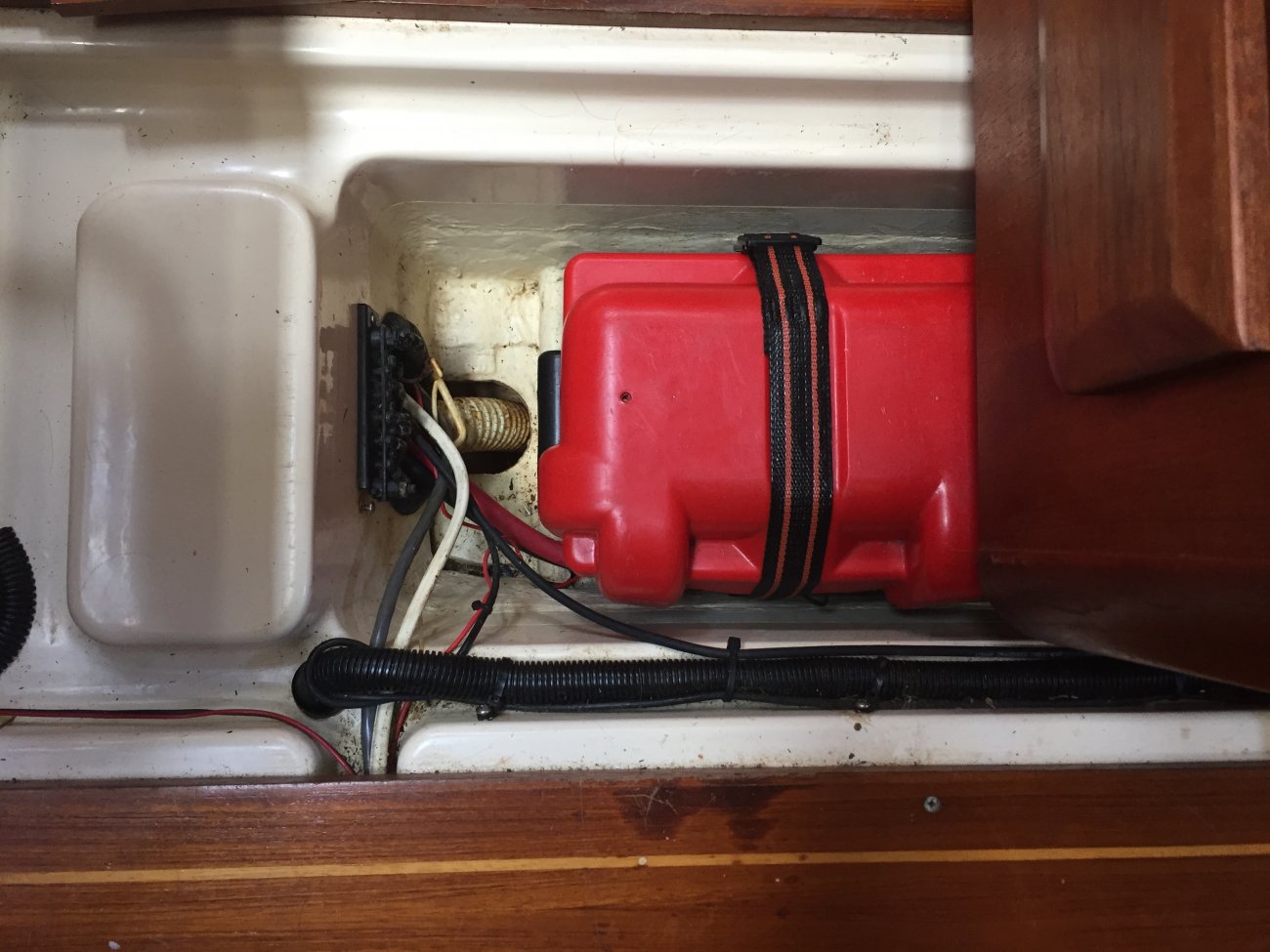

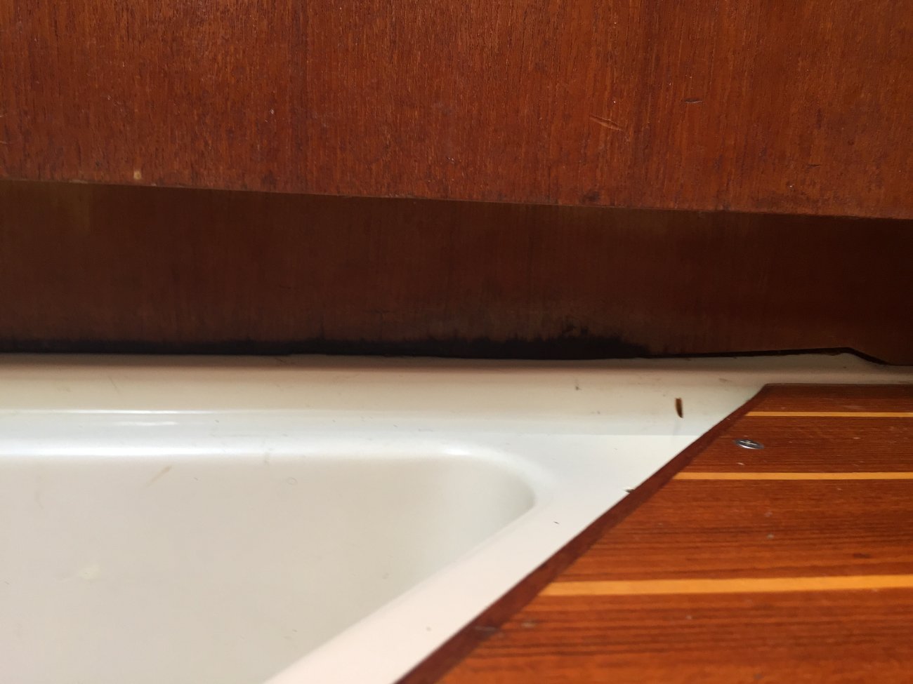

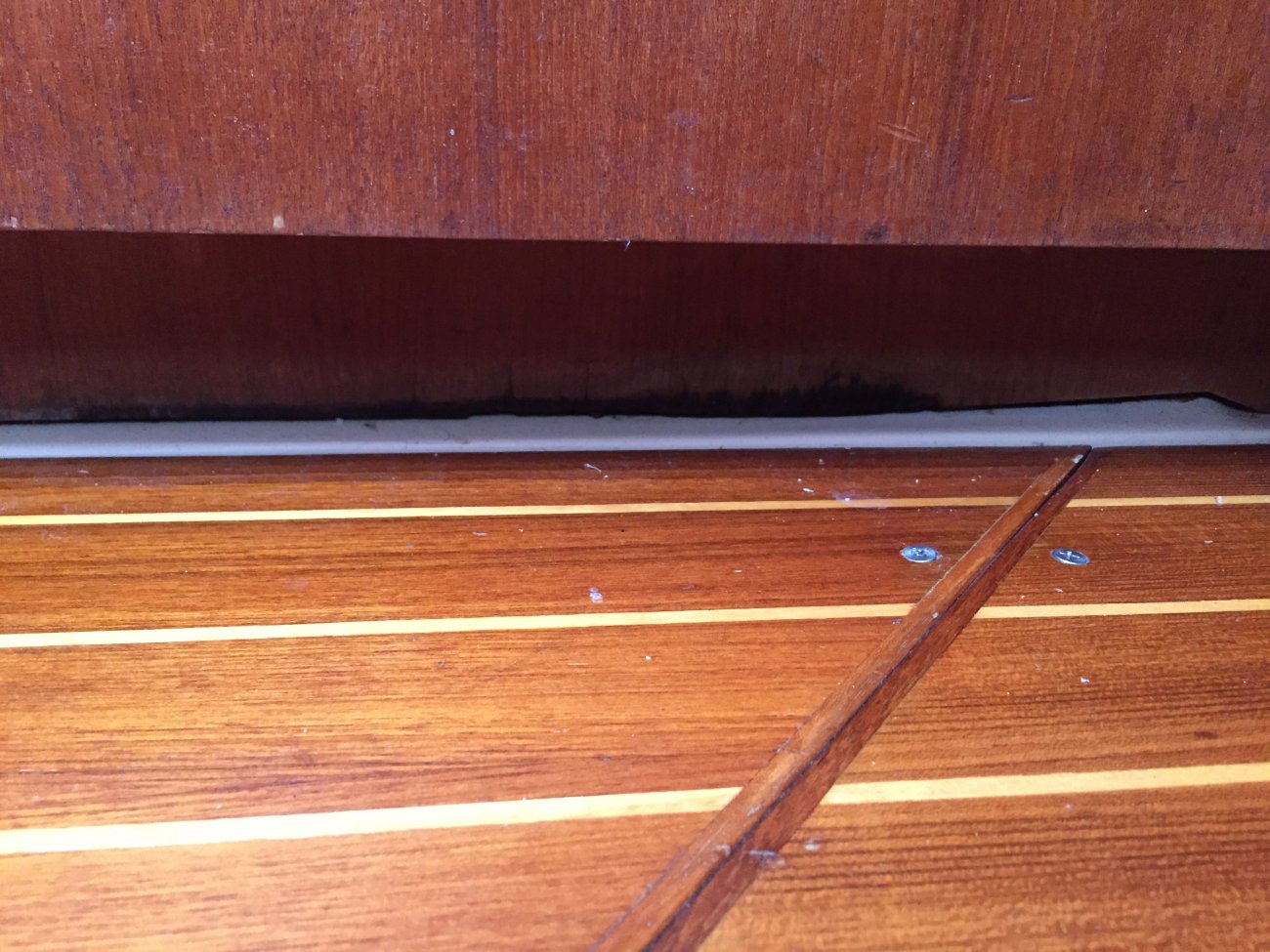

Found moist wood just bellow the frige, I believe there I might have seen a post on the subject, not sure. The attached picture was taken with the floorbo
Second picture shows a hose going to the bilge, looks like it is over ( maybe even attached to ) the aftermost keel bolt.

For the second picture with the corrigated hose just aft of the Starting Battery. That hose goes into the aft bilge section and feeds aft to a manual gusher pump that is probably located in your port lazarette. The pump should have a metal handle with a black round ball on the end (stored somewhere you can get to it quickly) that fits into a hole in the pump operating mechanism that can be accessed in the area just below the aft removable helm seat. The hose is attached to a "foot" that is down in the bilge. That foot should be pretty low in the bilge. I found for some reason that mine was accidentally pulled out till it was at the very top of the bilge, just below the battery shelf so I had to feed it back down to low in the bilge. It sounds like you can see the foot since you said it looks like it may even be attached to a keel bolt. It is not. You should lift out your electric bilge pump some (easy to do since it is on a movable piece that can be lifted out of the bilge without disconnecting the pump wires and hose. Then put some water in your bilge and make sure the manual pump works. It discharges on the port side of the hull through a mushroom fitting near the fuel tank vent. The diaphram in the manual pump can go bad or the hose can get a cut or tear and then your "sh&^% hits the fan" manual gusher pump won't work and you could be in deep do-do.

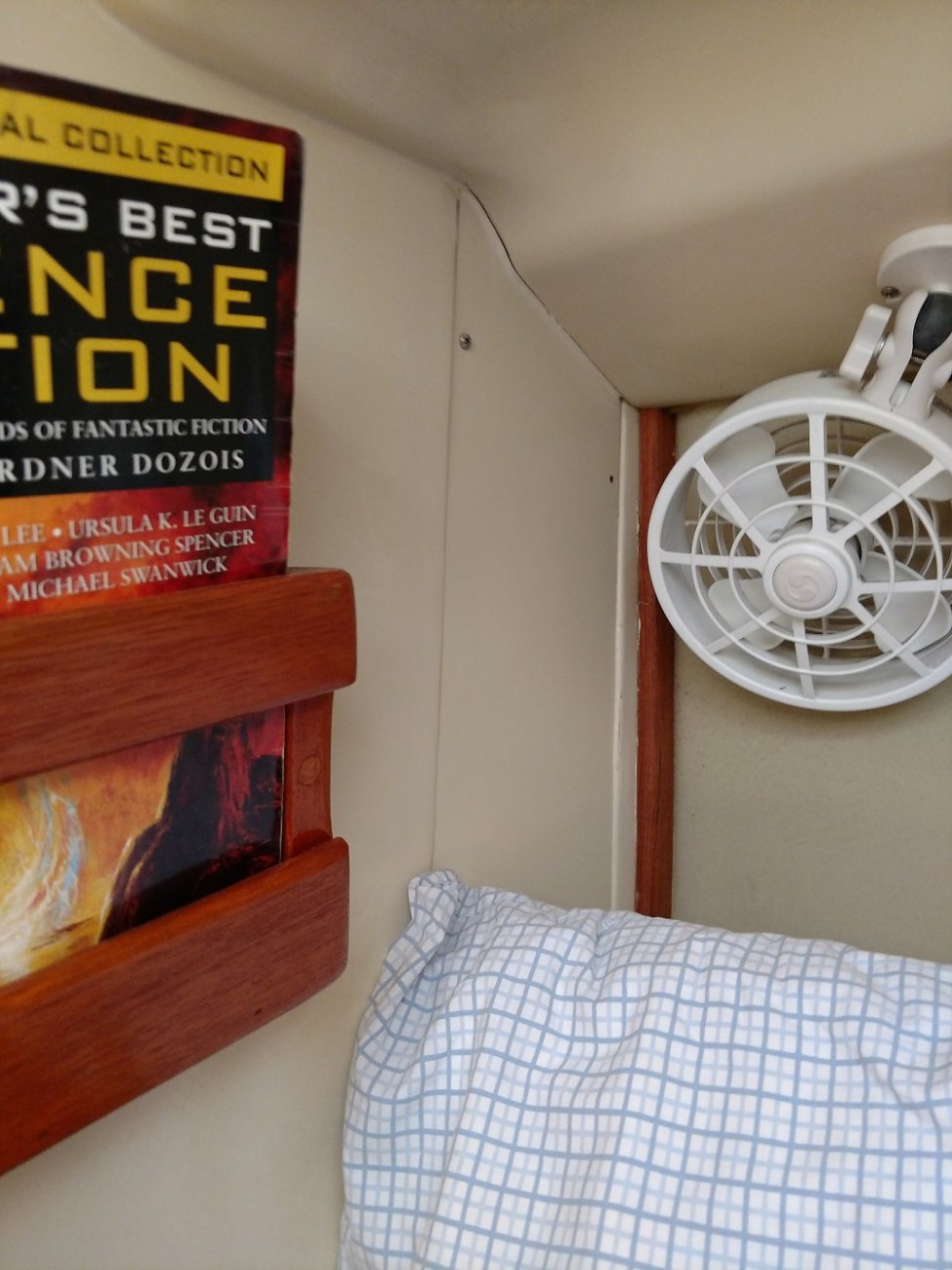

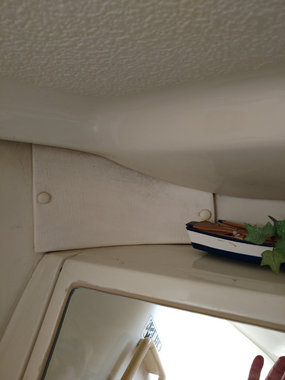

See these photos of the aft head access panel in the V berth and the soft removable panel in the aft head.

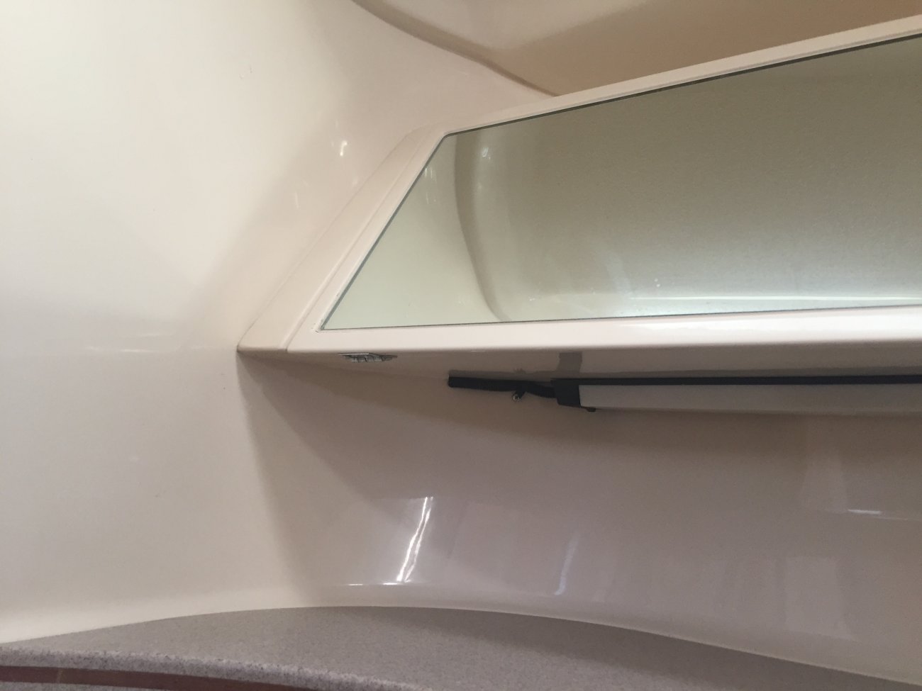

fero
Jan 15, 2010
133
Hunter Legend 40.5 Victoria

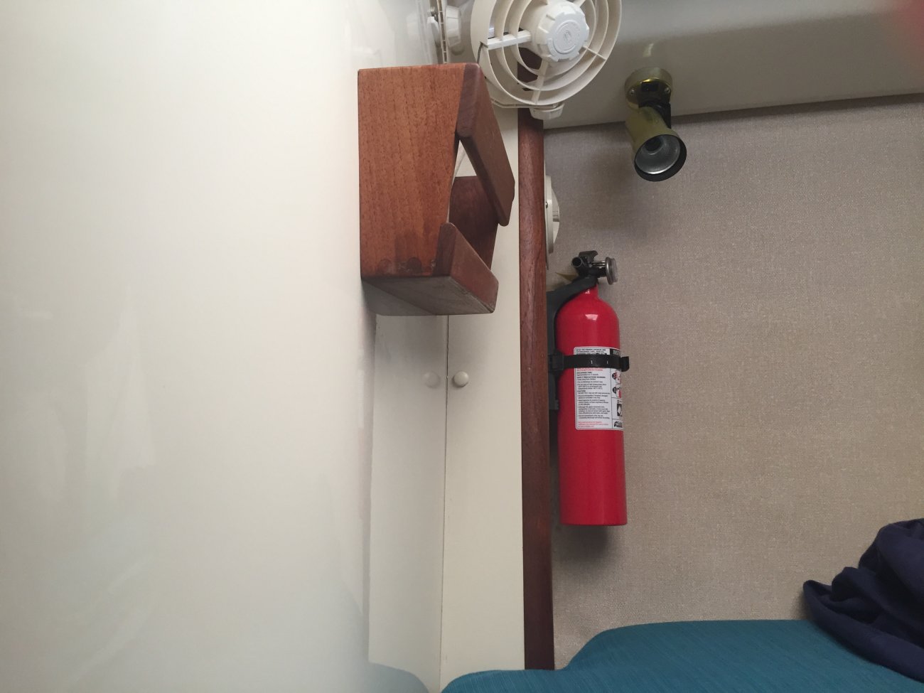

Thanks Rick,
No such panel in our aft head, in V-berth there is a panel (I didn’t open it yet). See the pix

My 2 cents is everyone should access the space beind every panel in their boat. On my B323 I took down the panel in the aft cabin above the hanging locker to get to the wiring. I found a chamber that is the inside of the cockpit coaming. Long enough to store boat hooks and whatever you needn't access, but just might need.

Sure enough, a running change. I did see where an owner had cut into the bath vanity forward wall to access his anti-siphon valve FWIW. Good luck!
Really surprised by the "running change" thing. I have a 1994 40.5 and FE says the one he has purchased is a 1995. My 1994 has the panel in the aft head that Rick posted in his picture. Guess the change is to drop the removable panel? Rick, what year is your 40.5?

I wonder nobody commented on the issue of wetness under the fridge. Is there any way to get to the connection of the drains below fridge and freezer which I suspect causing the wetness. Here is an other photo. Thanks for any input.
Rick D
Jun 14, 2008
7,207
Yes, I did a repair of the water saturated area under the frig. It's a bit complicated. Give me a few days.
