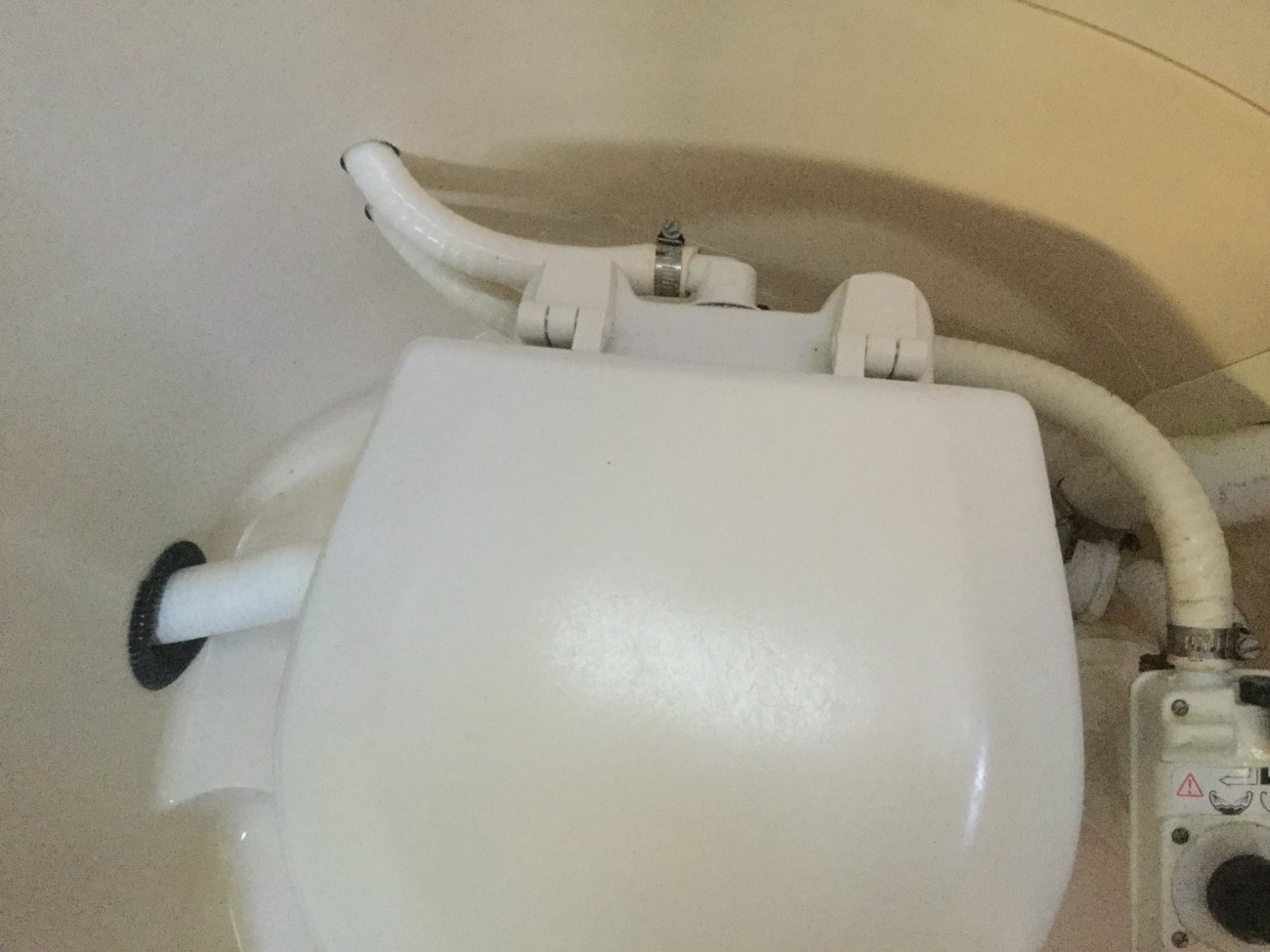

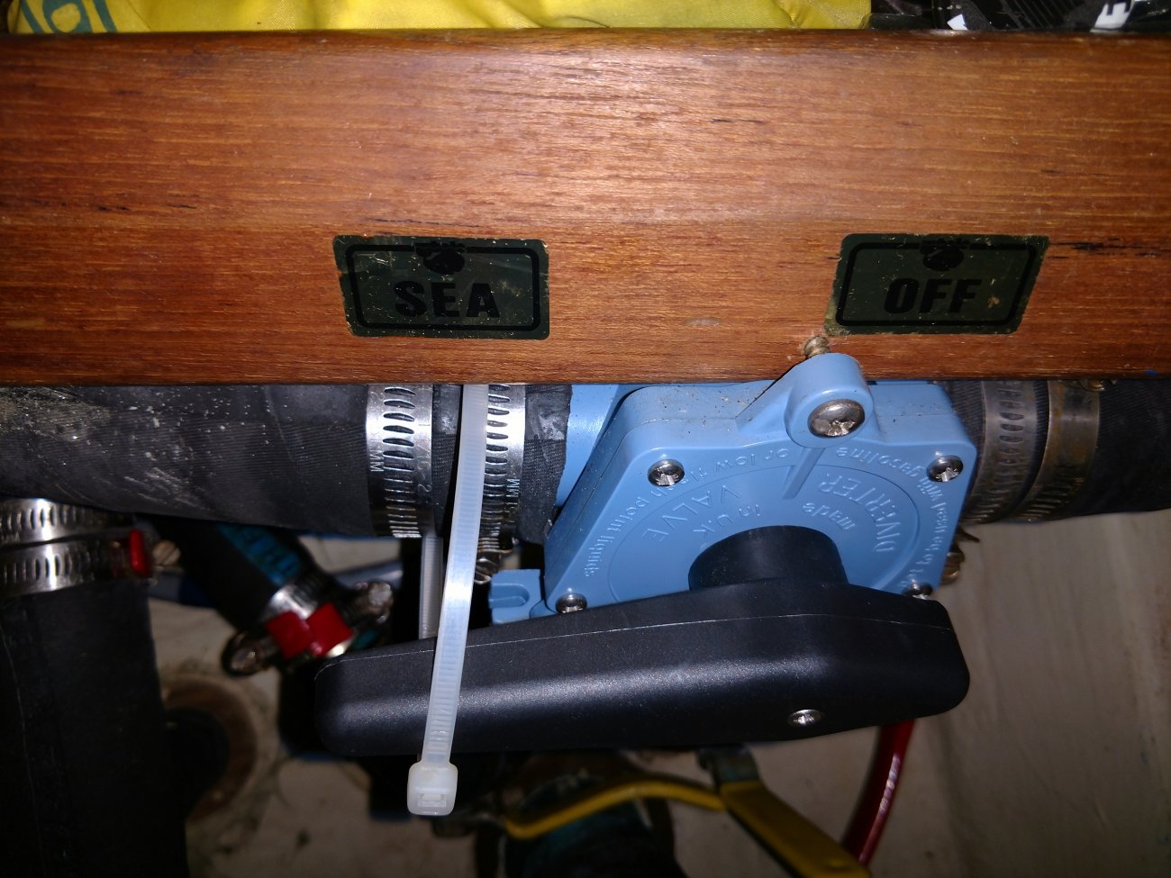

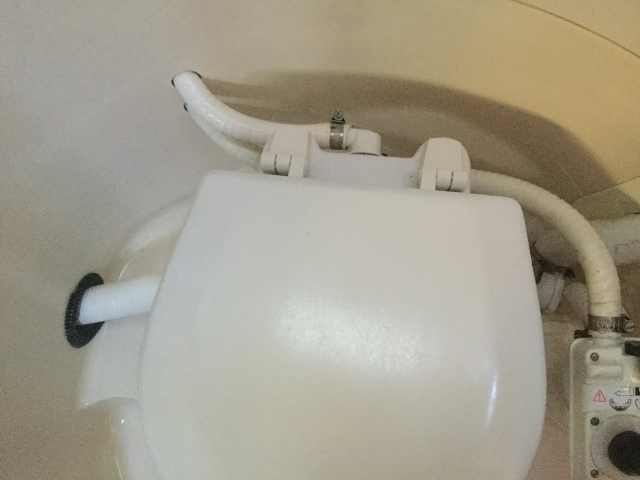

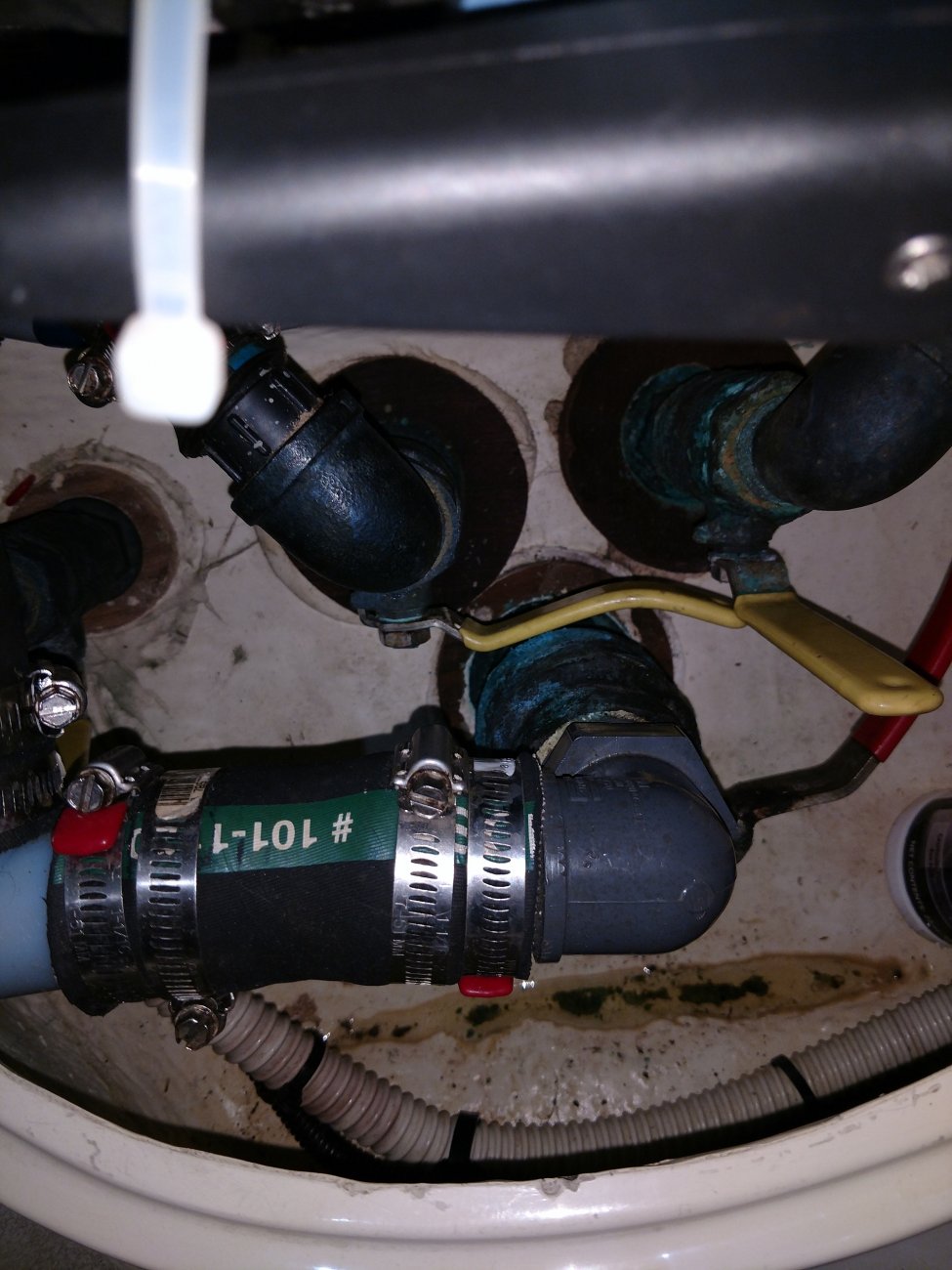

Here are some photos of the direct discharge Y valve installation for our aft head:
The first photo shows how the head discharge was routed under the sink and then, when on the holding tank, back to the tank. The discharge and holding tank hoses are stacked on one another. The second photo shows the overboard through hull valve, the one with the red handle. Note that the handles of the others have been bent to clear. The third photo shows the direct-discharge anti-siphon valve to the right of the sink basin. The fourth photo shows the Y valve located under the shelf.
IMG_20180928_205706384.jpg IMG_20180928_205758568.jpg IMG_20180928_205824752.jpg IMG_20180928_205905245.jpg
