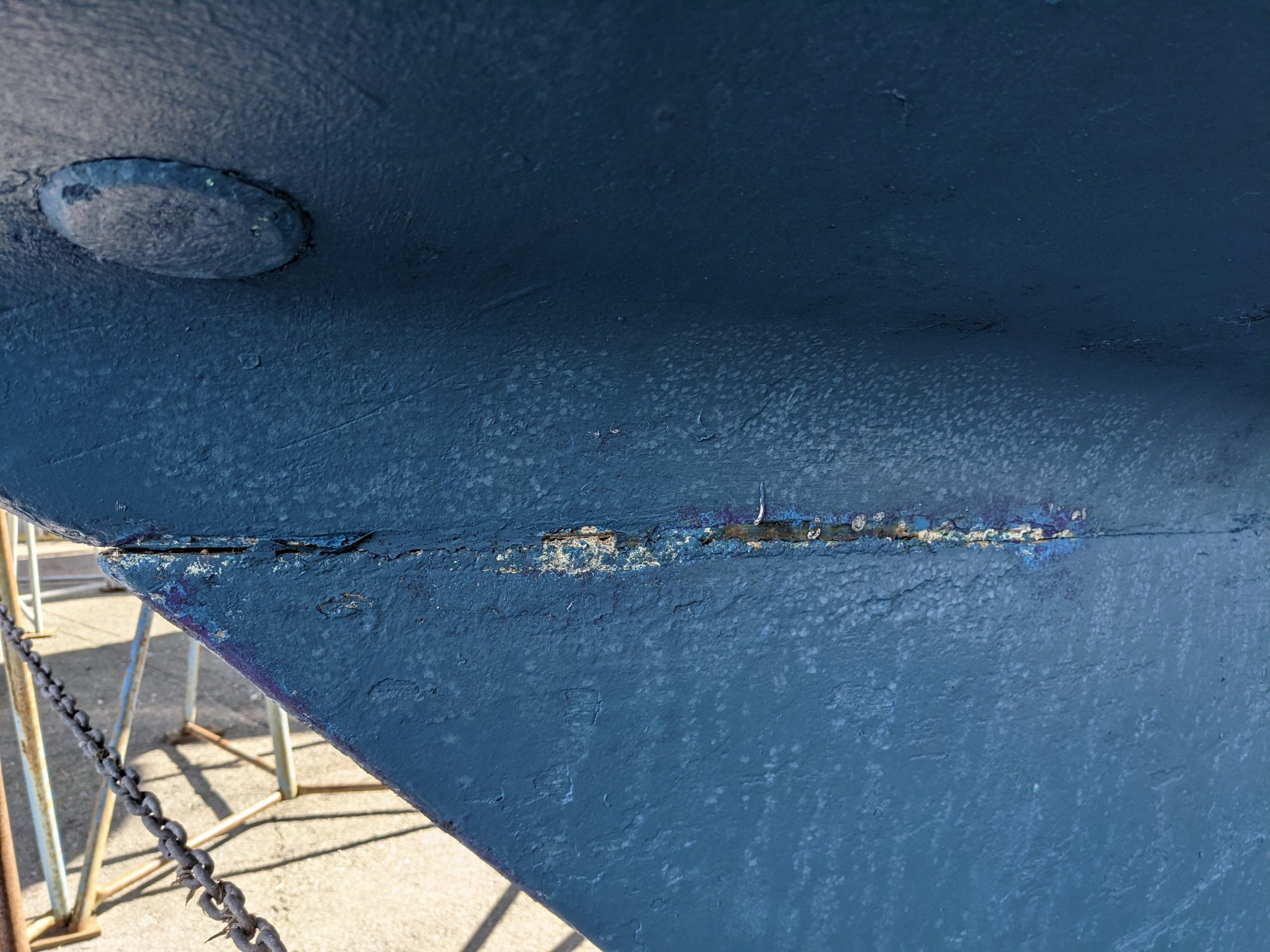

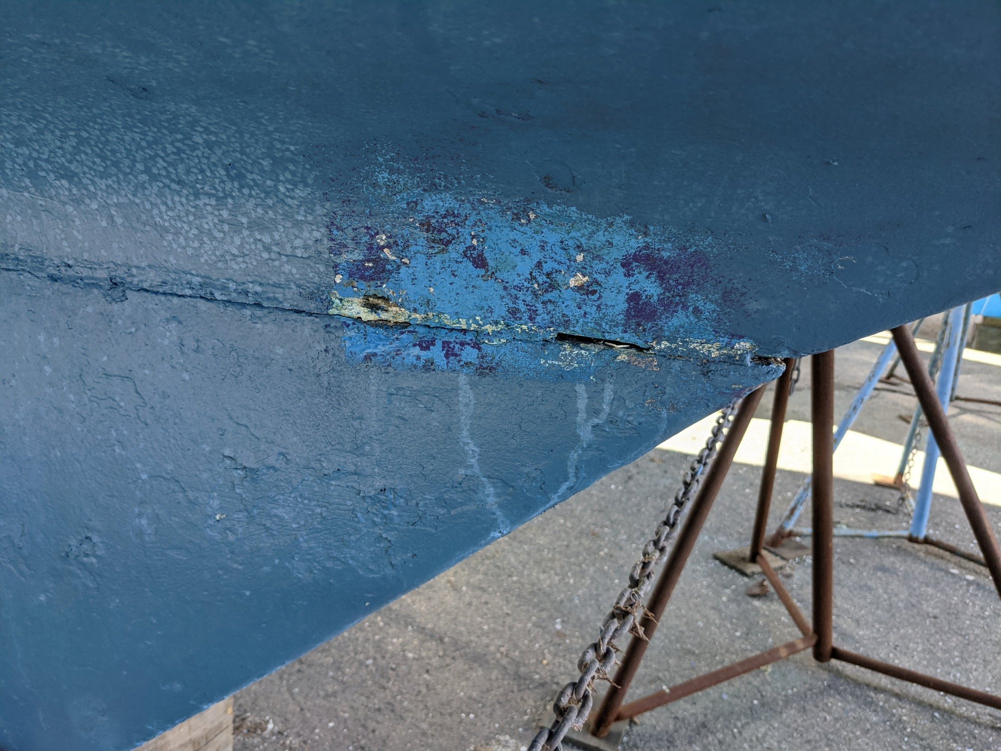

Hi, I just bought an 37c and wanted to find out what I need to do with a void between the hull and keel. Pics attached

Welcome to forum and congratulations on your new sailboat!!
This issue has come up an frequently and there are threads and articles like the ones below. You can do a search "keel separation repair" on this site and the internet to read them and the repair strategy. Discuss the repair fix. i.e., inspect the keel bots for adquacy and replace if required, rebed the keel and tighten the keel bots to the correct torque, with a qualified boatg contractor or boatyard. Good luck and let us know how the repair worked out.

the proper "FIX" is to remove the keel, repair all that has deteriorated, fiberglass, keel bolts, keel nuts. rebed keel to hull and tighten nuts to specs.
OR ........................... do what the last guy did and smear in some putty type stuff and go sailing.
39 year old boat ...........
what did the surveyor say?

It is an old boat.. Think I'll make sure it's secure with no leaks and go sailing. Bought the boat from a buddy and I didn't get a survey other than for insurance purposes.

Even if you don’t have the rig to torque the keel bolts I would at least get a wrench on each nut and make sure it is not totally loose before going back in the water

I'm noticing a few more things about this keel that makes nervous.. What is the construction of this keel in the 37c. Does anyone have a cross section drawing?
8,129
It makes sense that the keel/hull stub joint opened on the ends. The boat flexes and the keel doesn't. But the real question is about the condition of the keel bolts - for any 37 year old boat whatever the keel material. At some point that keel has to come off (Actually the boat comes off the keel), the bolts assessed and the keel re-mounted as per Jon's post. Why not now? When it's windy you want to have confidence in the keel and the rig.
