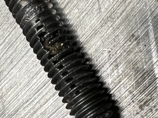

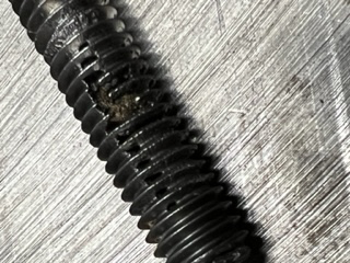

@Alan2210- Thanks for that info. My original bolts on the strut were Phillip's head flat head bolts. When I pulled them out, one of them was seriously corroded, not enough to fall apart, but enough to make me concerned, that perhaps the stainless quality was not 316. So I have purchased new 316 with Allen flat hex heads. I think this is the correct terminology. Below is the damage clearly visible
