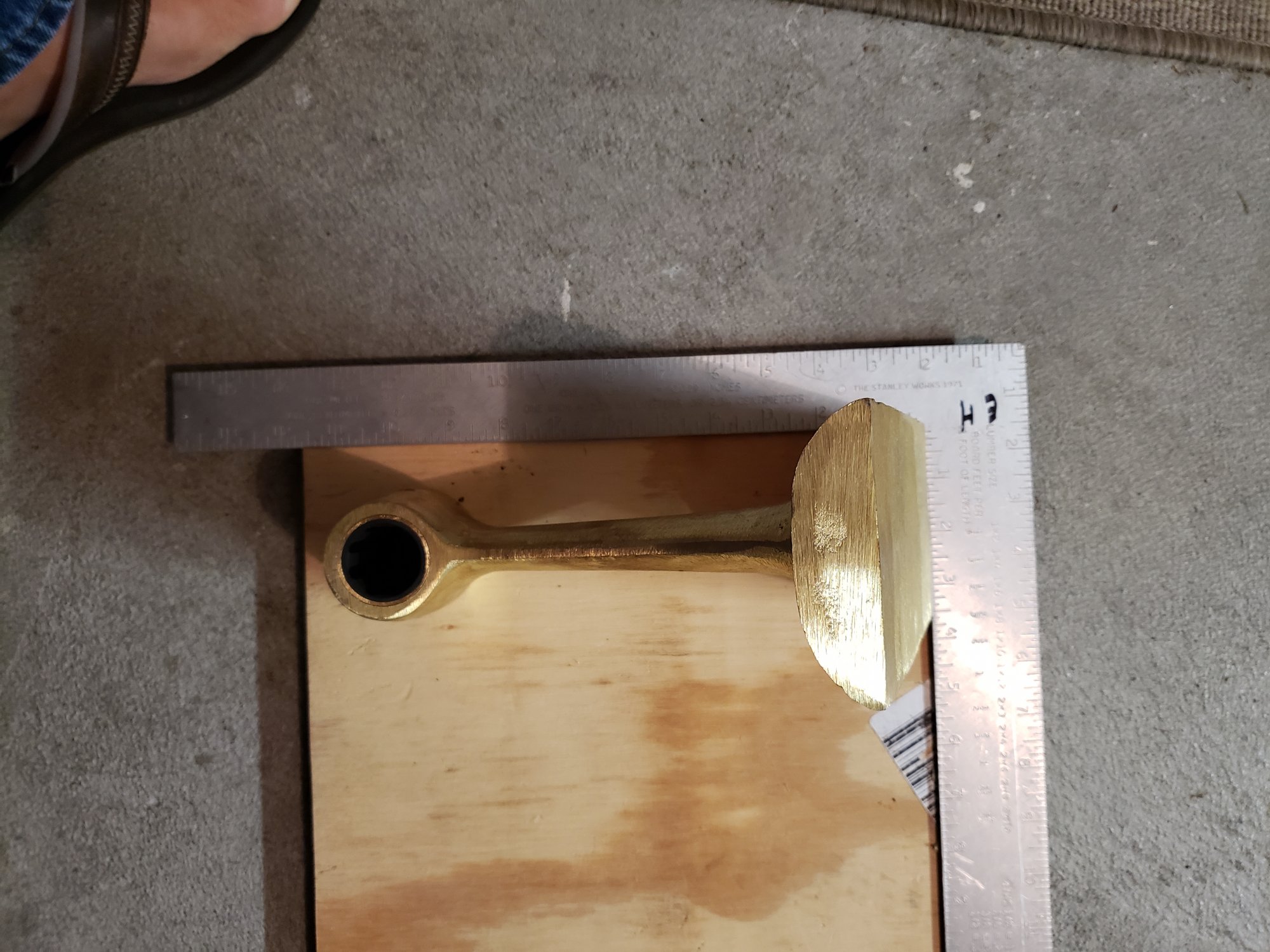

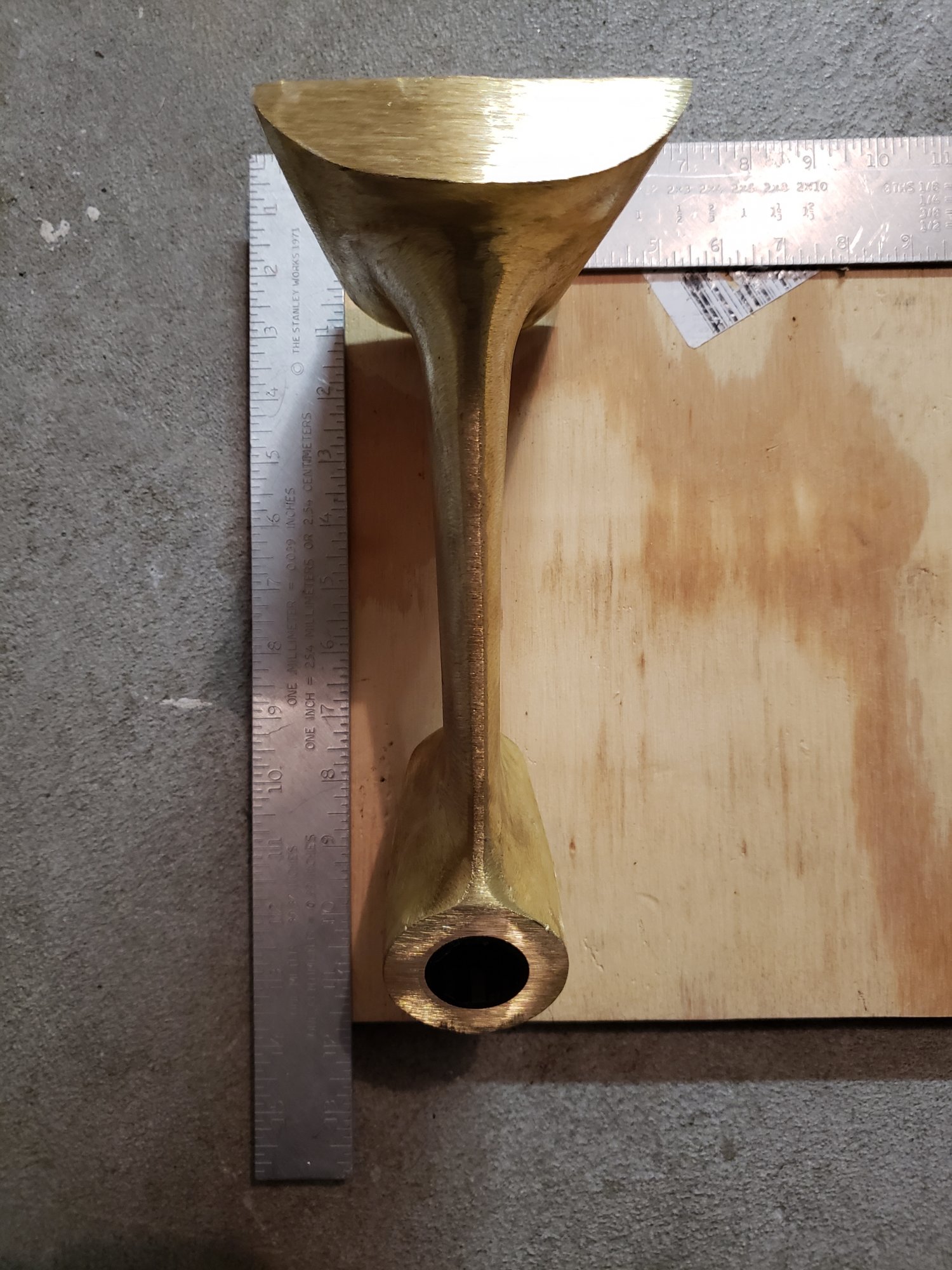

I picked up the new strut TODAY!!!
I would post more pictures (profiles) with the framing square in the background, but "the files are too large for the server to process."

Specs in inches:
Parallel Font Auto part Diagram Drawing
A: 1.375
B: 25º
C: 7.5
D: 9
E: 3.5
F: 8.5 - note that this is beveled by 0.5" on either end. The lower foot (8.5) is wider than the top (7.5). The palm looks like this \____/
G: 3.875
H: 1.5
I will state again that I am only trying to assist anyone following in my wake.
DISCLAIMER: ALL of these specs were measured by me, with uncalibrated tools and my old-out-of-spec eyes, from the new strut that I have received. Also, I may have made errors. There is the possibility that the strut that I received may not be the correct design. Your mileage may vary.. so use these specs for YOUR boat at YOUR peril.
