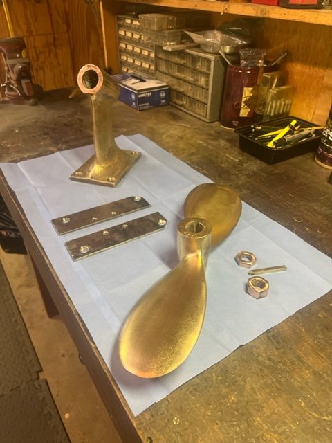

I could not remove the cutlass bearing on my 30 CB. The collets for the removal tool where either too small and seemed to push the rubber and not the brass sleeve or too big and would not push the sleeve thru. Using a tool that one doesn't need to remove the shaft. So I did the next best thing. I just removed the screws from the strut and cut away the 4200 sealant. It came away and I just slid it off. Now to cut the bearing out, order a new sleeve and re install.
24,707
Those clean up nicely.
Not sure you needed to gold coat them for Christmas.

Beautiful. How hard was it to remove the backing plates inside the hull - I assume that's what they are, mine has a lump of resin/filler over them. I replaced my cutless a couple of years ago with this:
Aug 11, 2011
1,020
O'day 30 313 Georgetown MD
@ dmax. Not hard at all. I started with a large Philip's head on a ratchet tool. That loosened two of the four machine screws. The other two needed some talking to with a impact tool. Once loosened I backed them out with a large screw driver. I them pulled a little and with a Stanley knife I removed some or most of the 4200. I came away nicely. Turned it upside down on the shaft and slid it off. The nuts are captured inside. Of course I had already removed the keyway for the prop. I course brushed the strut and then had sanded. My intent was to get the blue ablative paint off. Not bad for a first once over. Now the question........Prop Speed or not? How much will this really help or should I use the $300 elsewhere.

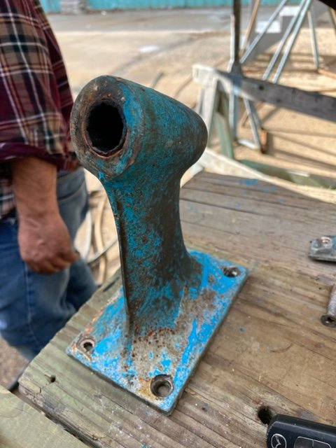

@ Alan 2210. Thanks for the great picture of your finished shaft/strutt/anode set up. My question to you is: Having replaced the cutlass bearing, did you need to realign the shaft, or was the replacement as simple as just replacing and ready for immediate use?
Likes: Allan12210
1,715
Hunter 34 Alameda CA
Sorry I missed your post. This was a rather large project. I had to replace the strut, shaft, coupling, and stern tube with all new. A complete realignment was needed. The new strut was just enough different from the old one that the shaft and new coupling did not match up to the transmission flange. Normally just replacing the cutless bearing in an existing strut does not require realignment.
