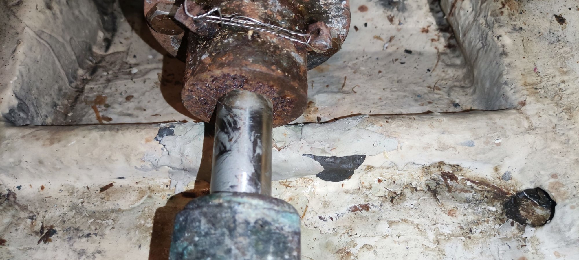

Do you figure the wooden structure which built the dam has dried out yet. Looks pretty miserable from here. Don't be afraid to dig out every last piece of wet wood and then use thickened epoxy or even just cotton batten to form epoxy plugs to stop the thinned epoxy resin from disappearing into the interior of the dam.
Likes: Ken13559
Oct 29, 2005
2,362
Yah I think its has not dried out. Ok I'll trying digging it out. I was thinking, perhaps I could use Seal Stic SS106 epoxy to fill up the void after digging out the moist wood. This epoxy did good for my Water-lock cracks. So I suppose it should be good for this repair. Anyway the West System is taking too long to arrive.
Jan 4, 2006
7,262
IMHO which is often not worth the powder to blow it to hell, anywhere there's exposed wood, I like to ensure that wood is soaked with thinned epoxy before packing anything else over top for shape. I like to plan ahead for about 25-30 years into the future so that when I'm getting on to 105 to 110 years old, I'm not faced with a bunch of failures which I could have been prevented 25 - 30 years ago if I'd just taken the time to do it right.

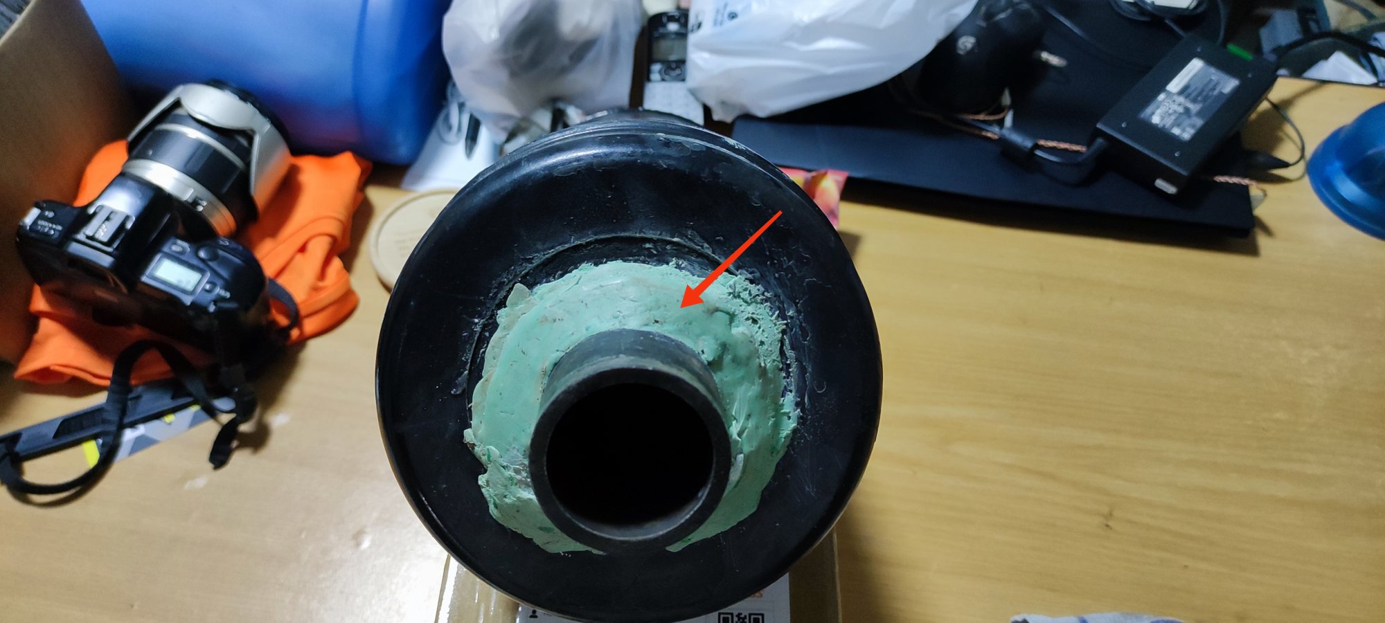

This probably why my engine overheated after sailing. SCW pump needs priming each time when engine starts. Thought was Anti-siphon valve issue but it tested good. Then removed all beddings from rear berth for work on engine and finally saw sea cooling water spraying out of the Primex Silencer.
Red arrow points to where crack is.
Sealed with hand kneed epoxy.
The crack on Silencer nozzle was very likely due to the engine vibration and weight stress by the corrugated-wired Exhaust Hose (Trident 252). Hose was suspended between U Mixing Elbow and Silencer due years of shortening/cutting of damage ends during maintenance.
Outstanding repairs in coming weeks:
1. Replace with stock 2 blades prop
2. Do Compression Test

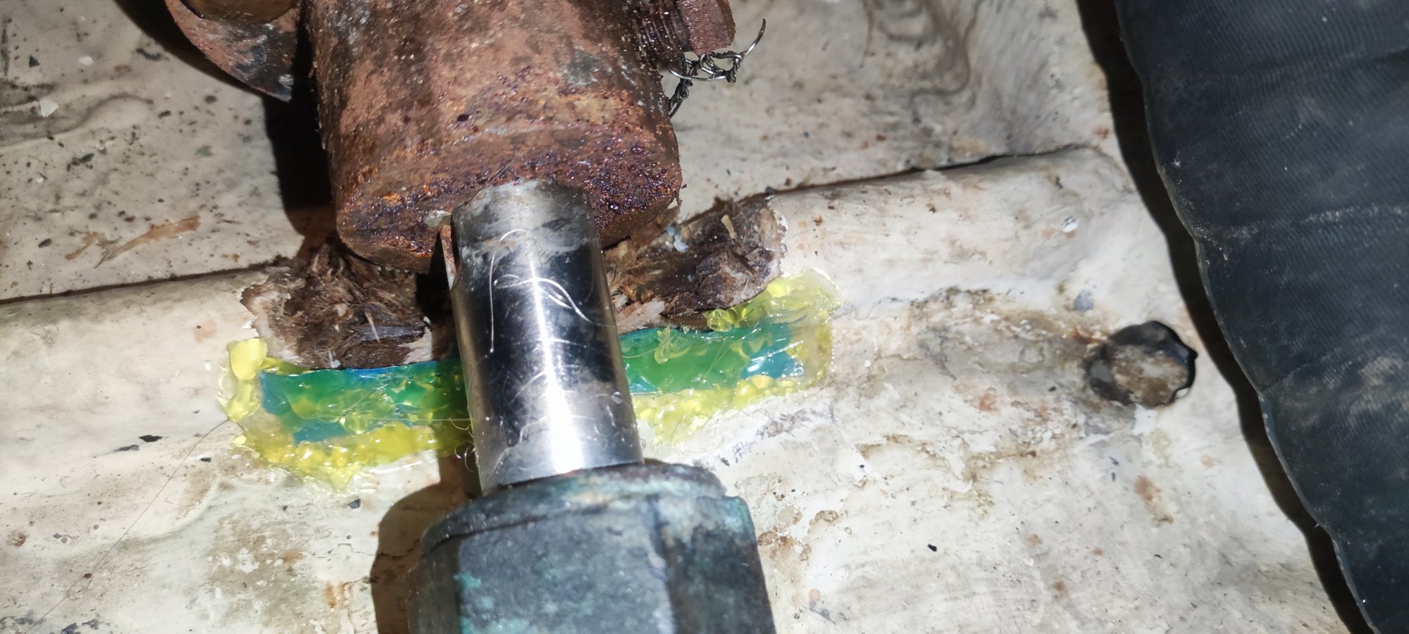

Dug out as much balsa wood i could from the ridge. Good thing is the base fibreglass. So apparently the balsa wood rings within the ridge line. I stuff the void with Seal Stic SS106 epoxy.
Next task is to change to stock 2 blades prop and do Compression Test of both cylinders. Tiring....tiring....
