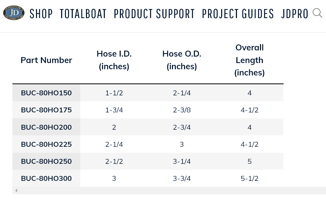

Would the 2"ID x4" length Buck Algonquin Shaft Log Hose fits my 1" shaft? I believe it's standardized across couple of Hunter range of sailboats with 1" shaft.
Please advise. Thank you.

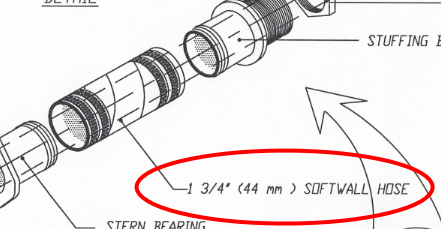

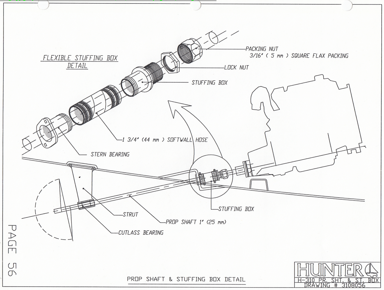

Use this Hunter drawing to determine what the labels refer to. Not the terms I would use but I didn't build the boat.

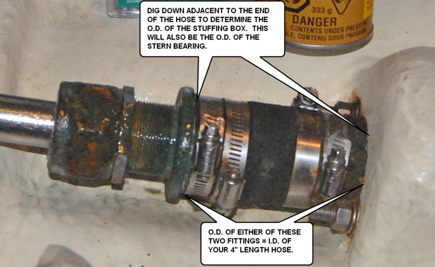

The hose fits on the outside of the shaft log and outside of the stuffing box, they should be the same size. If you have hauled out, loosen the straps on the stuffing box and pull out the stuffing box by about 1/4", use caliper to measure the outside diameter. Order the hose that size. The propeller shaft goes through the stuffing box and has nothing to do with the hose diameter.

I think @Ken13559 is still in the water and he's trying to get all his ducks (dead and otherwise) in a line before hauling. That's the reason for the in&out&roundabout way I suggested for measuring the fittings OD and hose ID in post #23. Also, all his boat parts are all shipped on a slow boat from China (or worse) which is another reason for not hauling before having the parts in hand and ready to go. The Hunter stuffing box drawing I supplied is for my 1999 H-310 which is almost identical to his 2002 Hunter 326.
It was only as I posted my first post that I realized the required hose for his gland assembly was "probably, maybe, and quite likely " an 1-3/4" ID hose and not the 2" ID Buck Algonquin Shaft Log Hose he was looking at purchasing.

I measured the Packing Gland OD and got 1.88" 48mm. Now that falls between 1_3/4" and 2".

Guess that cinches it.
1-3/4" ID hose = 44.5 mm.
2" ID hose = 50.8 mm.
Your packing gland OD = 48 mm.
2" ID Buck Algonquin hose it is.
