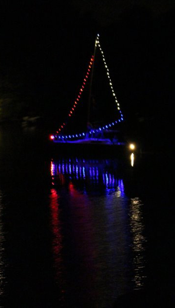

Dang. Stinkbug is lucky. I can't get anyone to go to our fireworks display. Everyone is afraid of the drunken boaters that won't be able to see us. I'll be lighted like this. So I guess I'll only need one life jacket. *hrumph!*
