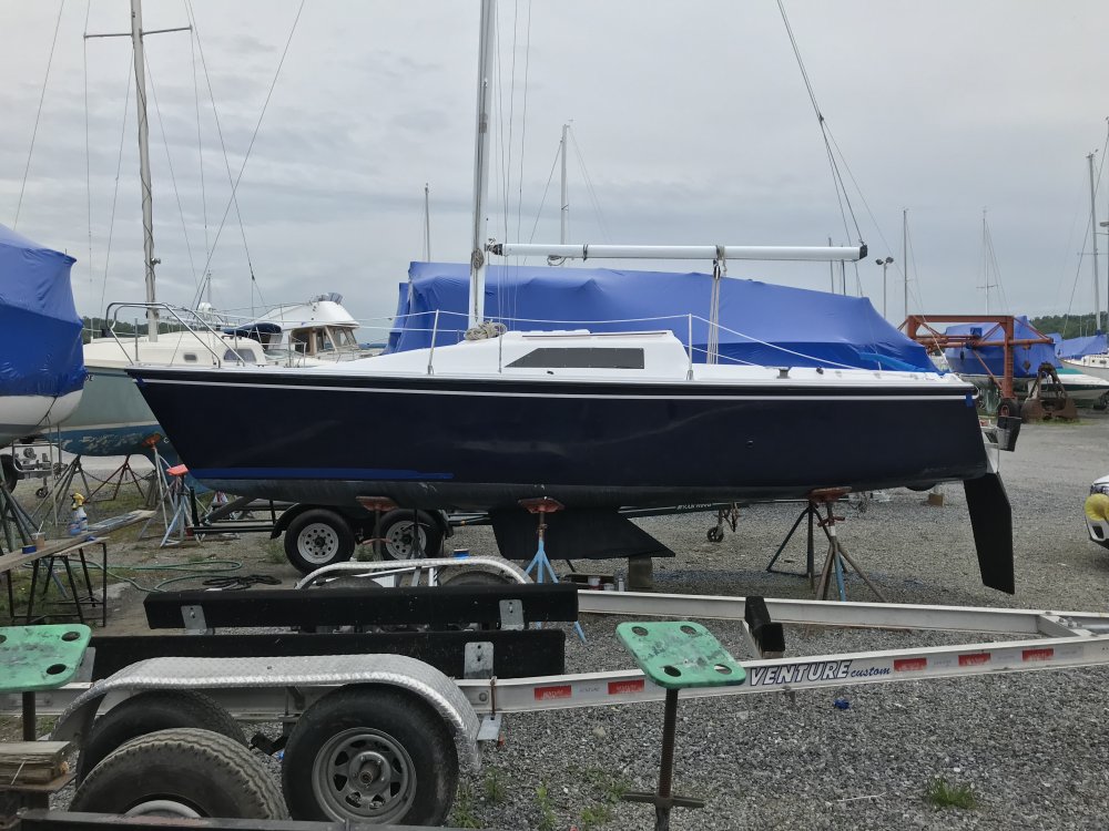

Finally ready for the water. It has been an excruciating long process which has encompass ed 2 cities and 3 moves, 4 schools... still this little Hunter is moving forward and getting ready to go back on the water with mast up to be used and continue its “sprucing up” inside cockpit. Here are the most recent pictures.
I plan to take it to Anclote river (wester Florida north of Tampa) to be docked and be able to use it.

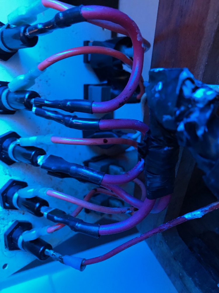

Hey Reefing

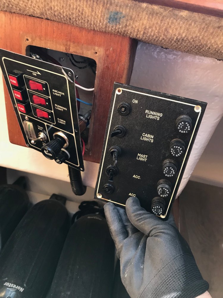

So I just restored my 86 H23 earlier this year - I've been off sailing all summer and missed all these posts. Pardon me if any of the below if redundant.

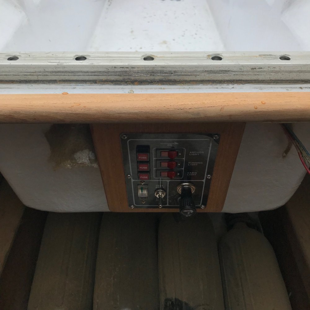

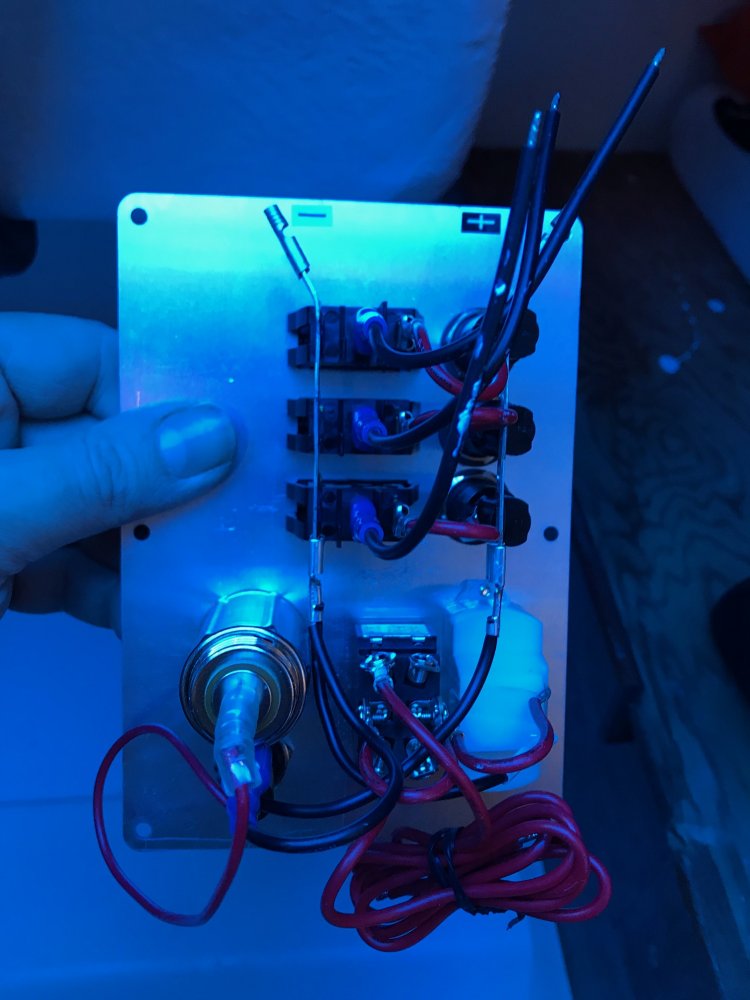

I redid the electrical panel, which when it comes down to it is pretty simple - and yes just connect lines to power to see if they light up. Let me know if you have any Q's. I purchased a sea Dog panel - which works perfectly and was so easy ( I was nervous after looking at the back of the stock) BUT it was a snap to install.
The deck connector to the mast prob - literally hard wire to see if it works. The mast/deck connector on mine was pretty beat up and I cleaned it with steel wool/sand paper and got a good connection.
If that's not the problem is either up top (bulb out) Replace it with LED by the way, or it is not getting power.
I did replace all the wires on mine by the way - except the one up the mast.

Wow, I really like thst pannel. Is the meter for battery charge indicator? I will look for one. I tested the mast light, which is new, and it did not work. I am pretty sure that the issue is the deck connector but the wires in the mast are rough too so it makes sense to replace as I am trying everithing I can to raise the mast for the last time.
If you have more info on that pannel I would appreciate if you could PM me with it. I had not concider that route and it surely seems a great replacement.
Thank you.

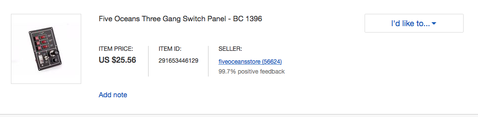

Yes that panel has a battery meter. Actually you can hook 2 batteries up to it as the meter has a switch for the batts/plus hook ups in the back. For 25$ pretty unbeatable - plus the plate is metal and it fits (my big requirement) into the existing hole from the stock panel.
My mistake - it is a five oceans 3 gang switch BC 1396 - I picked it up on ebay.

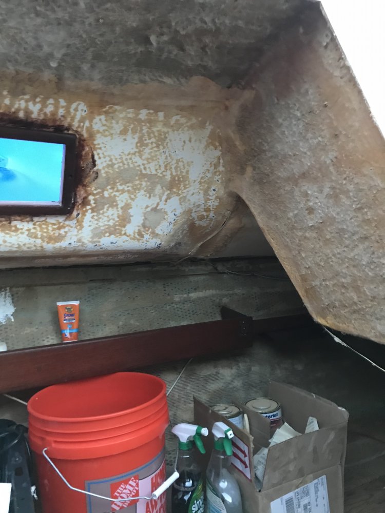

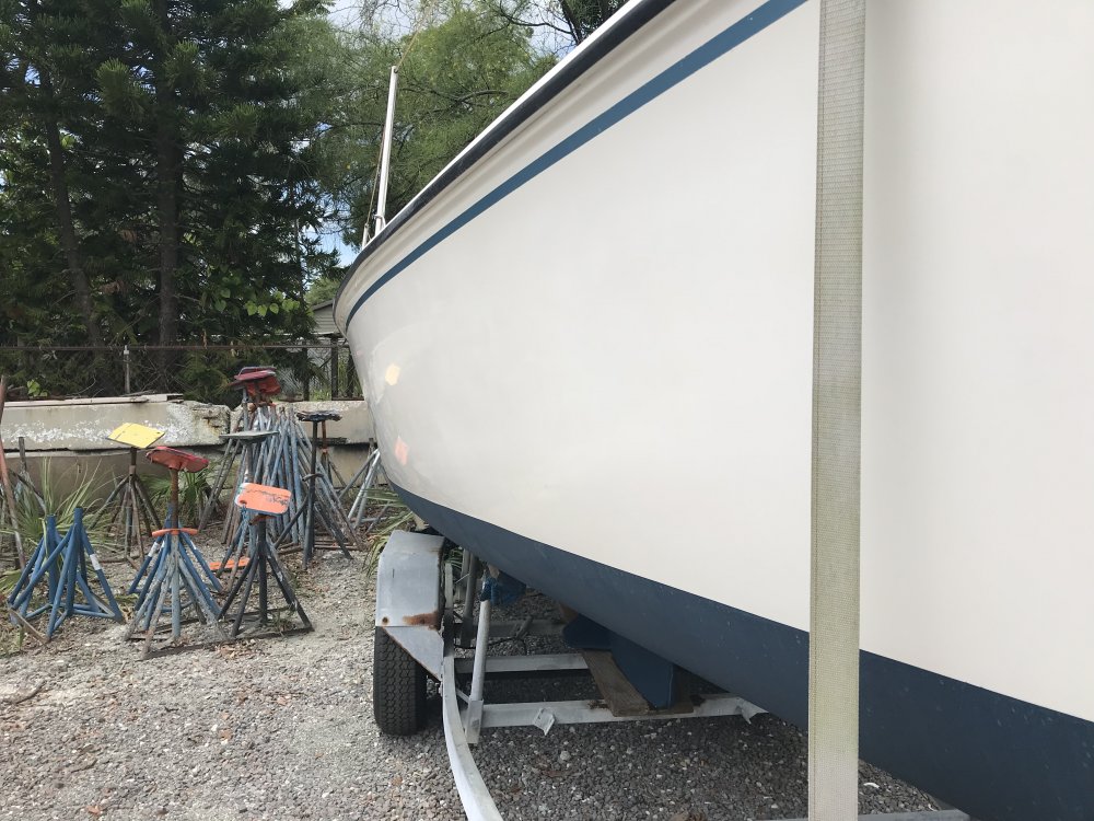

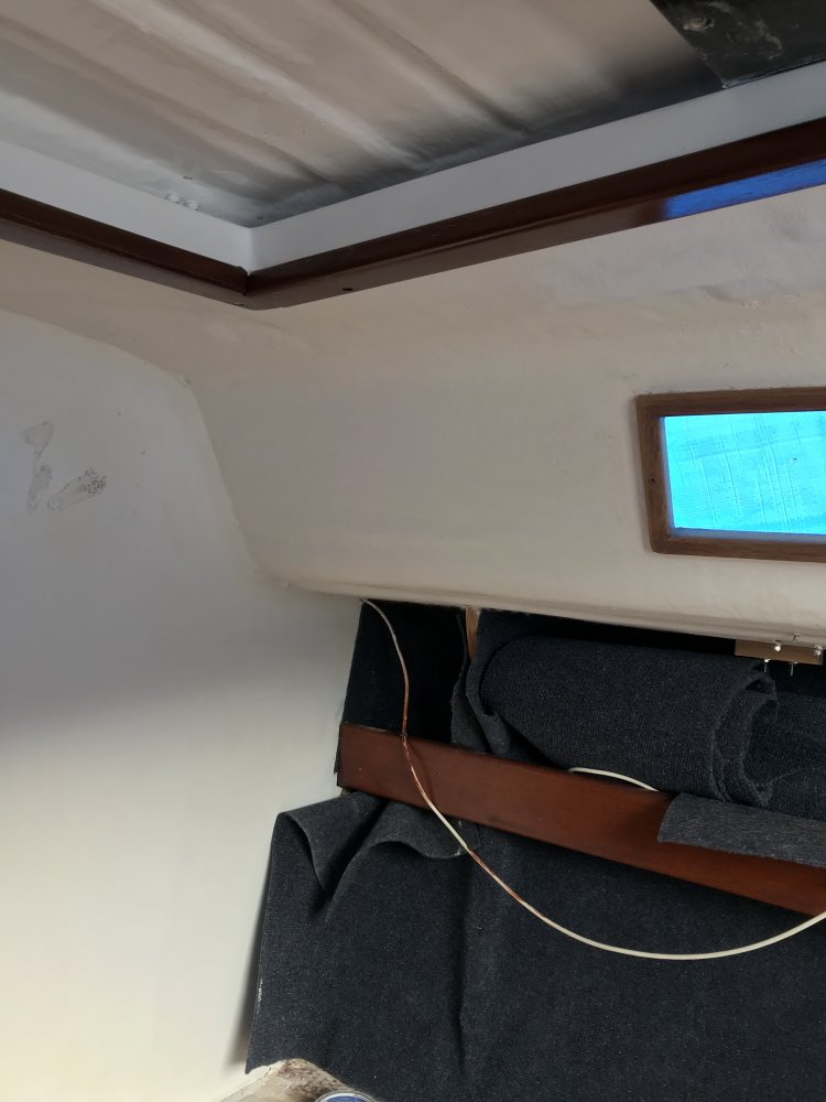

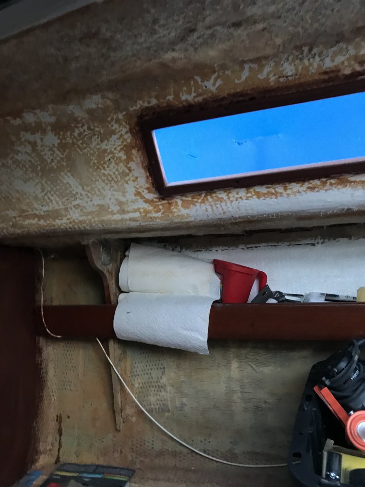

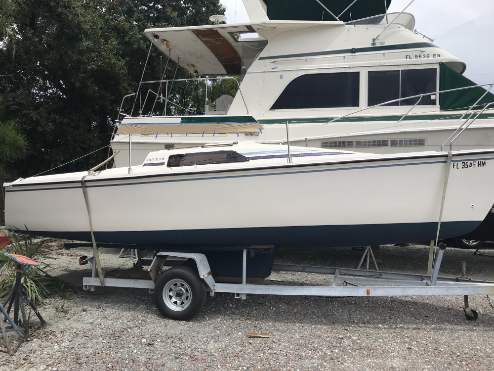

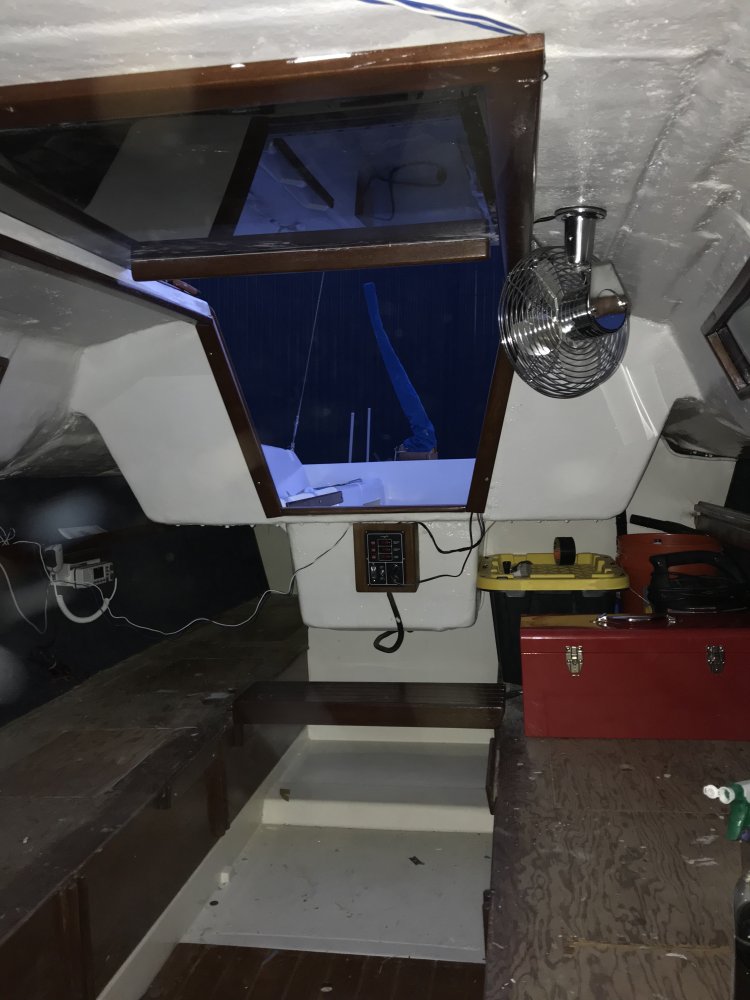

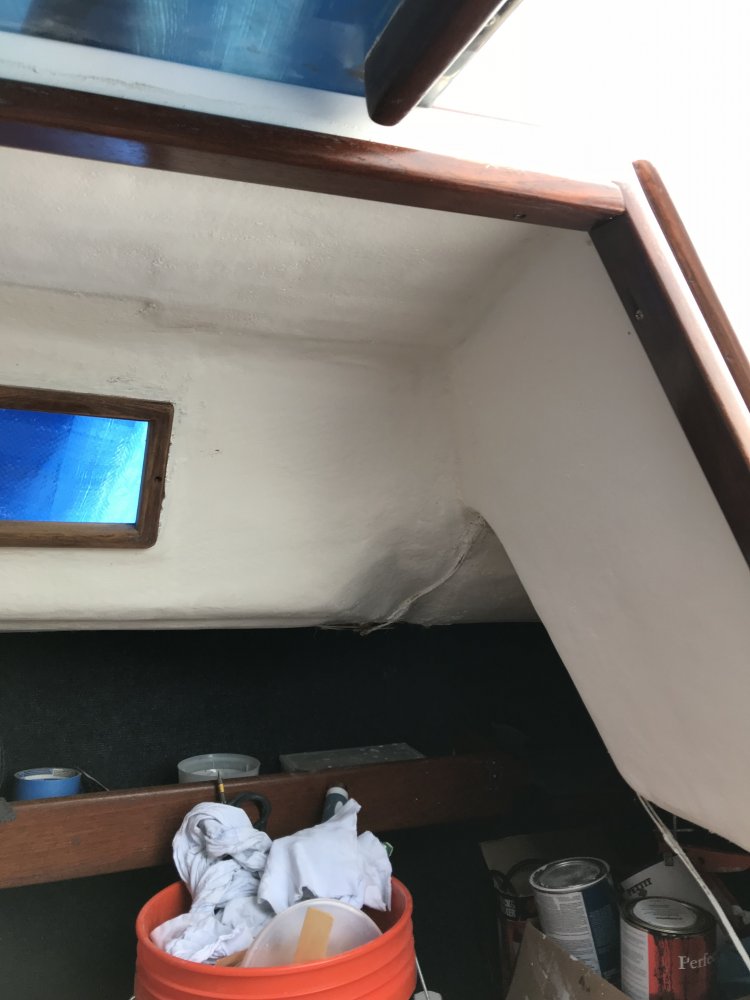

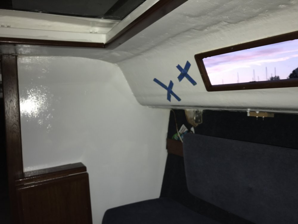

Posting a couple pics from when I repainted ours too -is that the original gel coat on yours? Plus I stripped that nasty inside carpet out of the headliners (but it was a nightmare to do) and eventually glossed the interior in white.
Nice job on your bottom paint too.

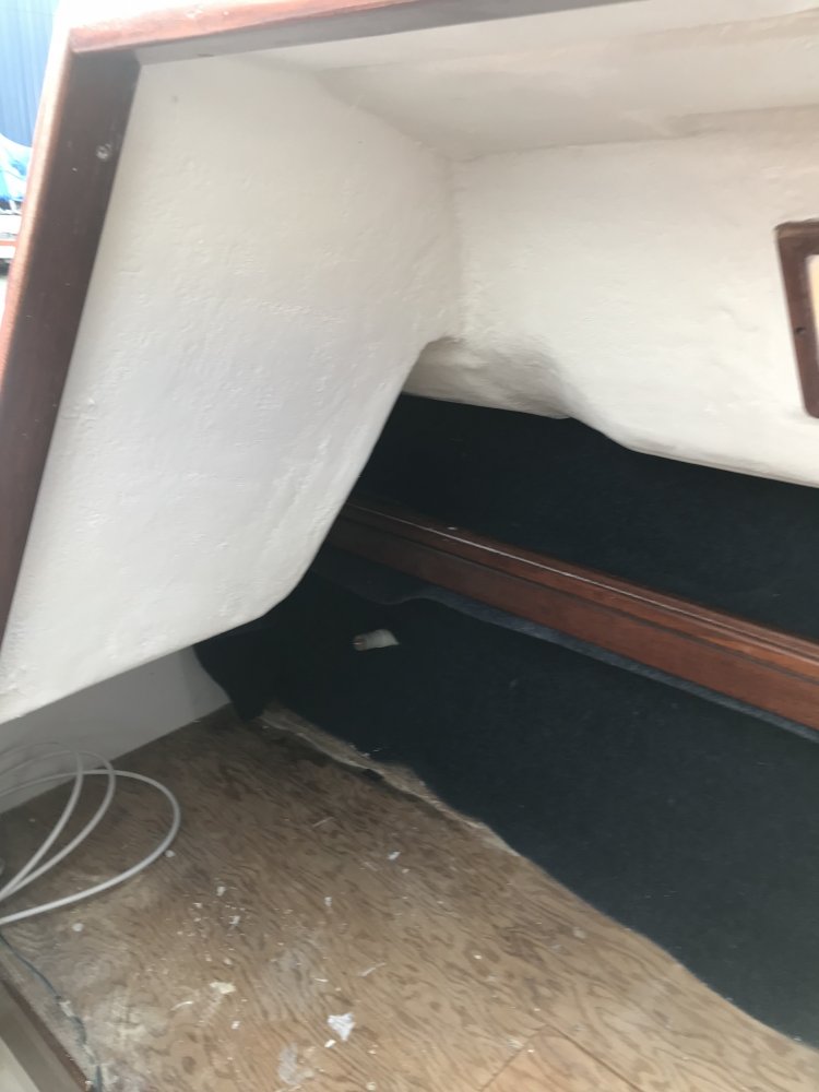

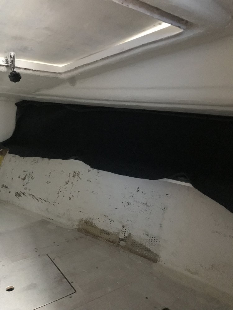

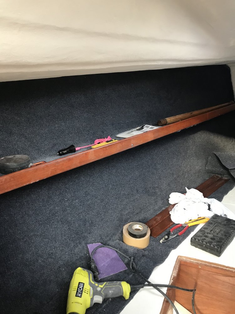

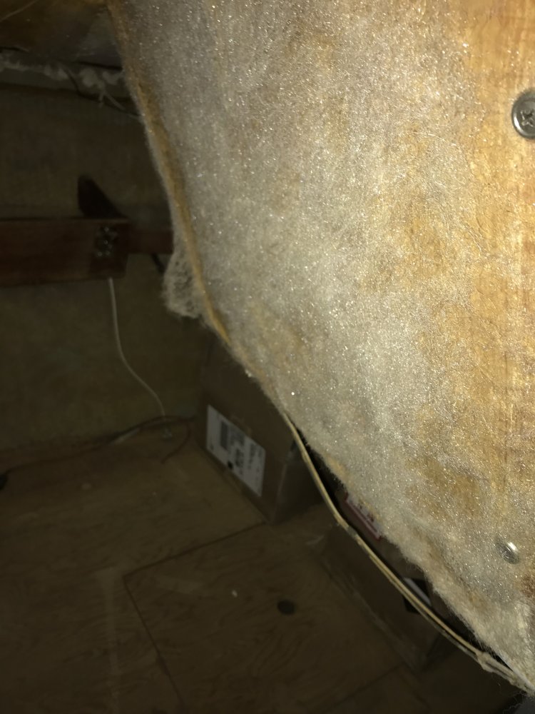

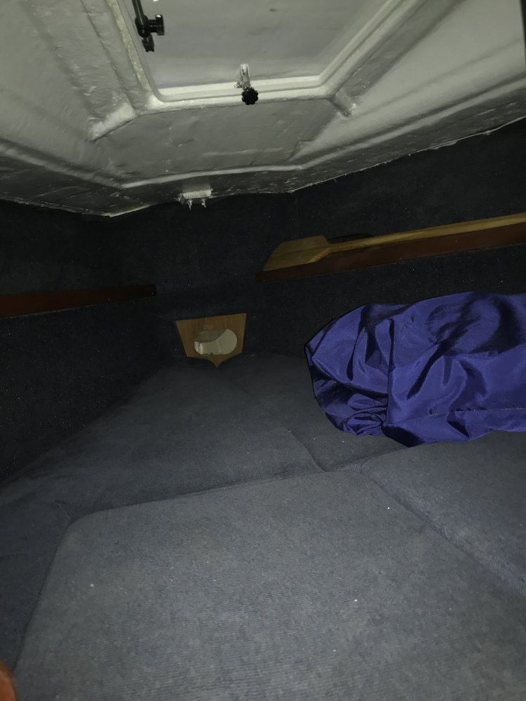

So to take out the carpet is a nightmare - the glue is almost impossible to remove - plan had been to do the WHOLE interior in white - but we just did not have the time to sand every bit off the sides - and I re carpeted the sides. The glue they used in the 80's is rock hard - then when you pull off the carpet it leaves fur - gross job.
pics attached
Blue is a 2 part Interlux Maurits Blue - original gel coat is under that. We rolled and tipped it - my first time and it was nerve racking but turned out well (after a-lot of wet sanding).
