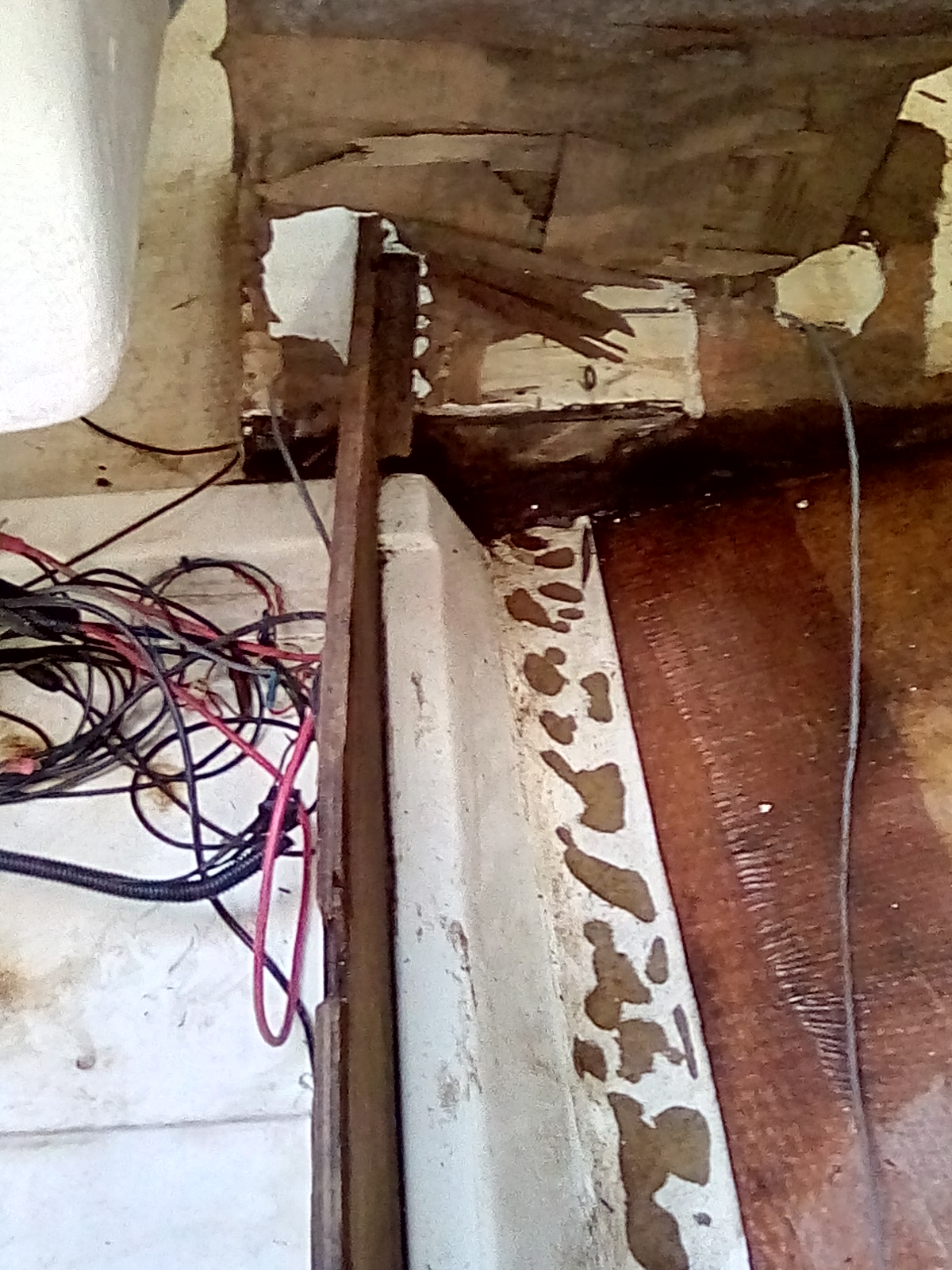

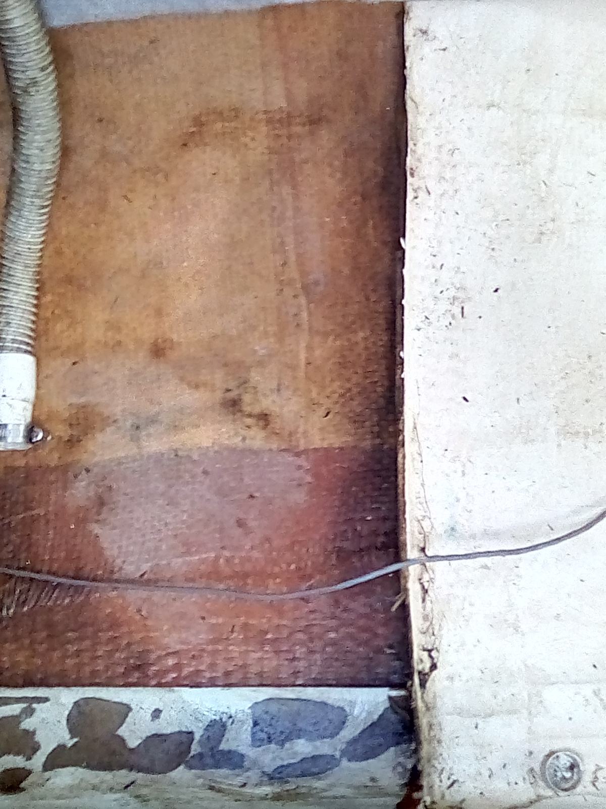

Thank You so much ! I guess the million dollar question is: What is the interior construction of the raised floor and raised sections that hold the wood for the settees [couches/beds], bulkhead walls, etc. ? All the visible areas under the settees, etc. are glassed in except the port/rear section. It was removed previously and reveals a pretty major void along the inside edge. Are the stringers, etc. glassed in before this finished prefab floor is installed at the factory ? If not, water intrusion is an issue [other than typical stress cracks, age, etc. that all boats face]. I will eventually begin a new thread for subjects, but thought this one structural question would fit nicely here, as it will surely affect integrity if that 800lb keel and it's connection.]

Cray Dave will be able to give clear answers but below is my take on your questions.
1. What is the interior construction of the raised floor and raised sections that hold the wood for the settees [couches/beds], bulkhead walls, etc. ? fiberglass mold with gelcoat.
All the visible areas under the settees, etc. are glassed in except the port/rear section. It was removed previously and reveals a pretty major void along the inside edge. Mine had the same gap and I sealed it with a marine resin. Thst area you speak of is where the galley slide goes an for food storage. Are the stringers, etc. glassed in before this finished prefab floor is installed at the factory ? do not know. Mine is not visible. Mine was filled with water and although I have soft spots the area where the keel bolts go is rock solid.

Thank You for the heads up on your answers to my concerns. Luckily, my keel bolts all look clean and solid. There's a few very minor cracks in the cabin sole and will be addressing that after I let her rest and totally dry out. The keel will be tackled as well. It looked good at first, but has the typical rust looming under the fairing/bottom coats, but still plenty of material left in my keel, thankfully. This will be DIY solutions at keeping rust to the bare minimum.
