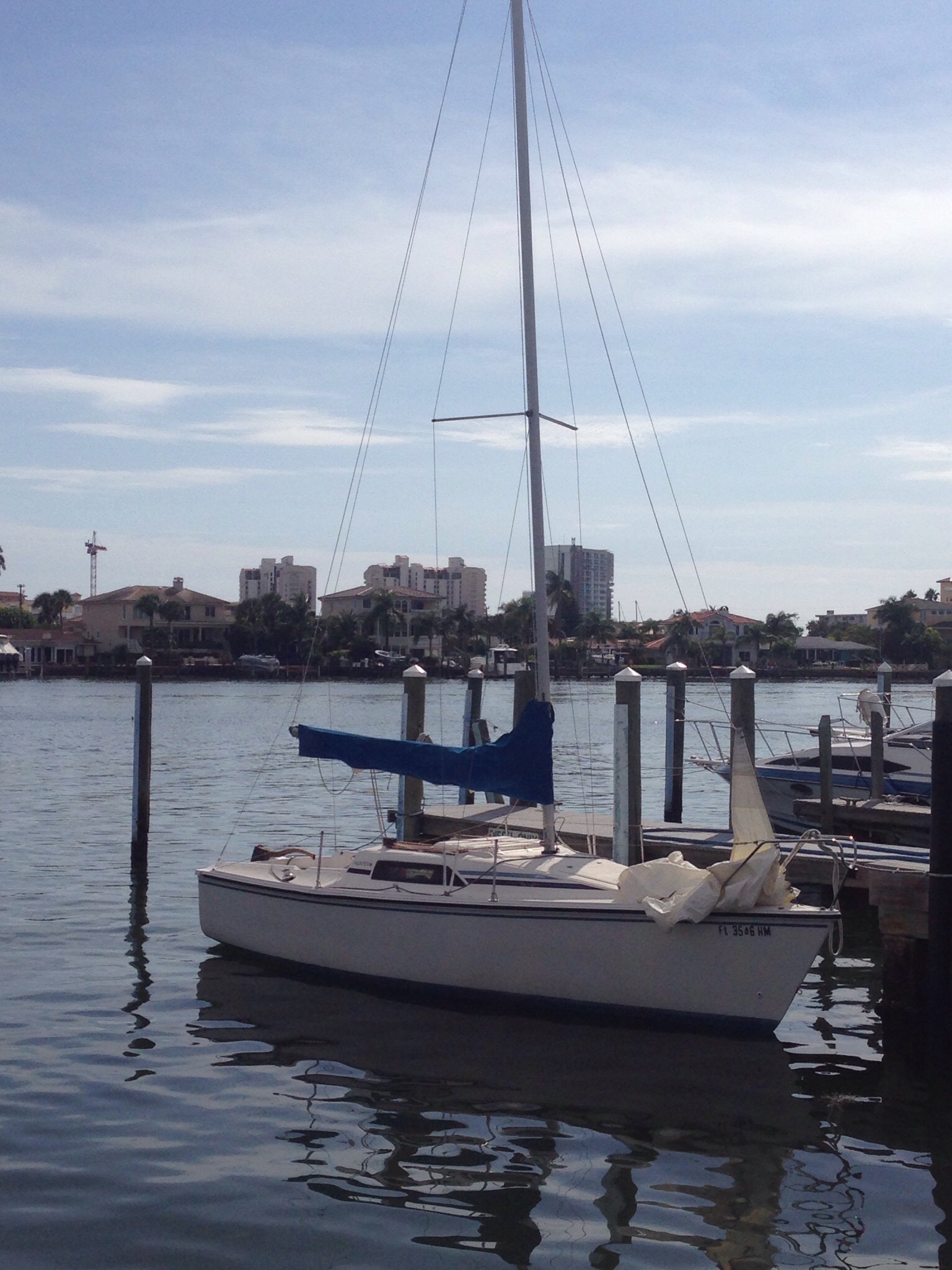

On a positive note today i reinstalled the mast and connected most of the rigging in preparation for the maiden voyage. Here is a picture of the boat almost ready to go in the water. I will update again when the boom is ready for the water. In the meantime i think i will attempt to make a gin pole so that it is convenient to use the boat often while i finish working on it to leave it in the water.

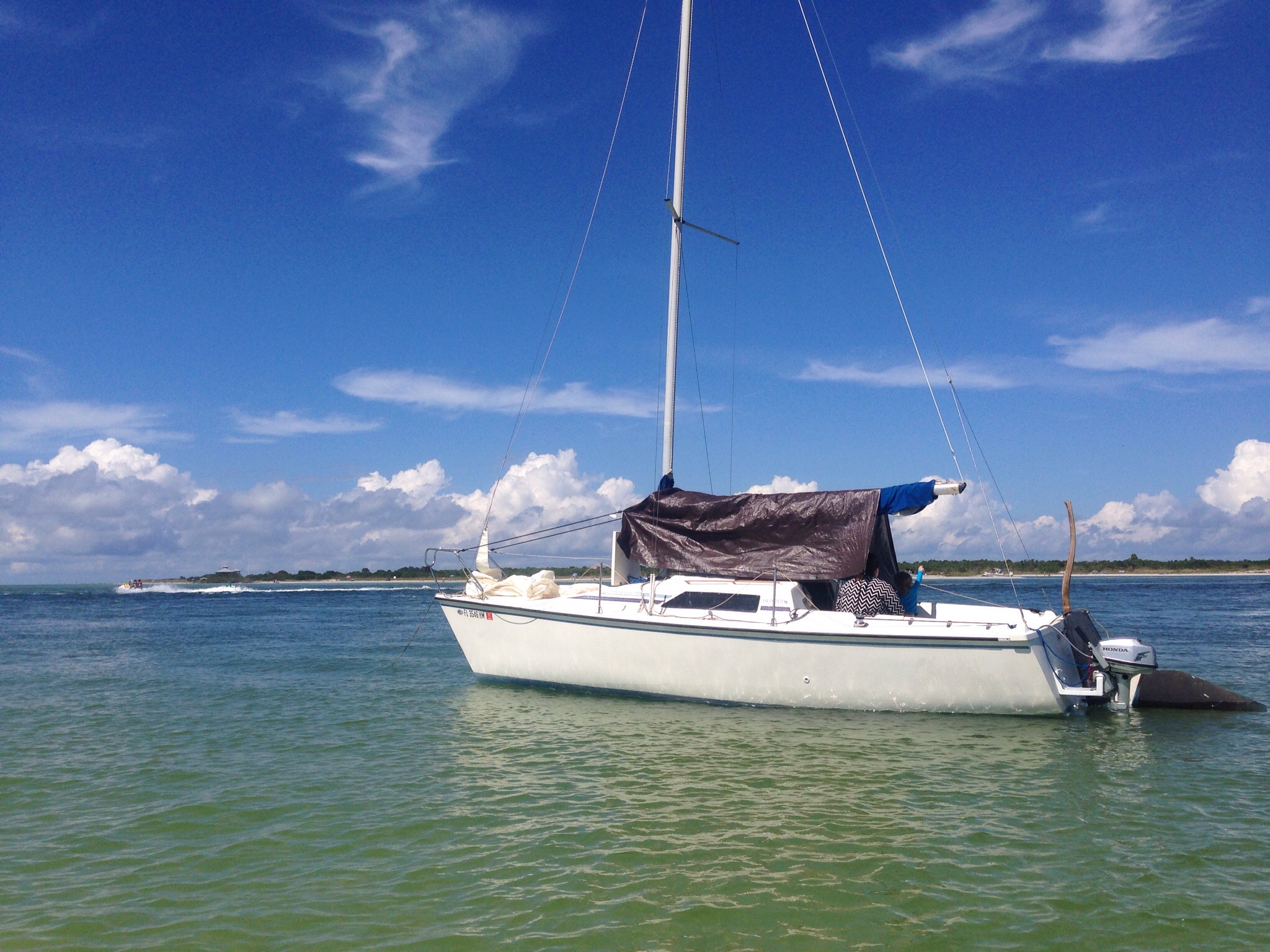

Ok friends this is an update on the project. I was able to put it on the water last weekend and sailed it 3 days. Wind was about 10mph and the boat was moving very comfortably for my family and I. During one of the outings the tied was moving out quicker than expected so i had to hop out and push the boat out of the sand, close call and a bit of struggling to get it out and raise the main at the same time.
The sails appear to be fine, not good but good enough, although i had to take them both for maintenace as they are 26 years old and showing.
My family and I had a great time although admitedly with 2 novices and 3 year old and a 4 month o,d there is a lot of juggling back and forth and i am starting to wondering if a sailboat is the right option now, instead of a few years from now.
