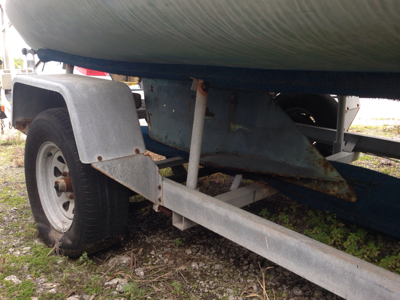

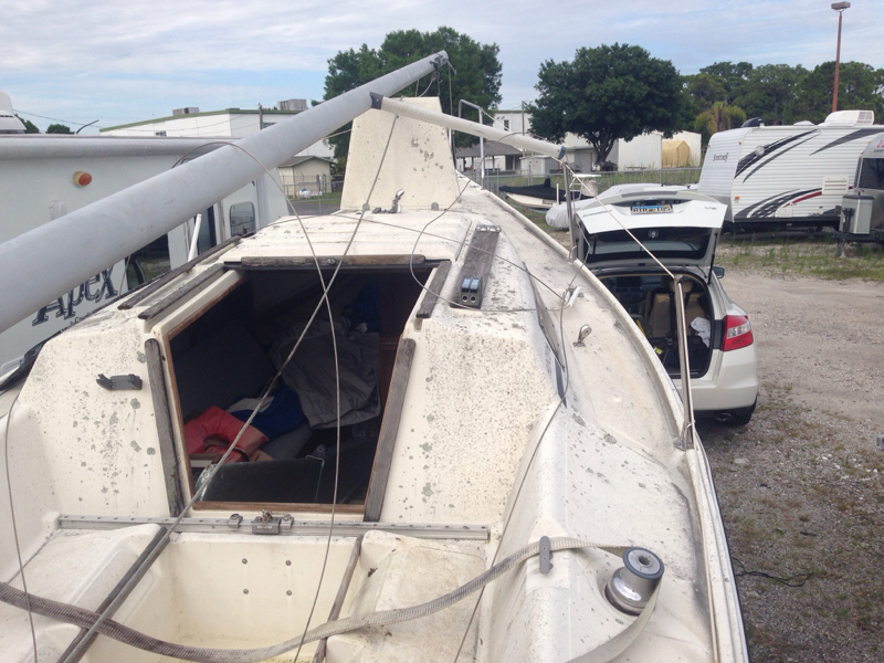

Hi Hunter Forum, after 2 years of waiting i finally got my H23 still parked in the same boat yard. At that time i was able to take some measures (raising the bow, emptying the bilge, etc) and from what i was able to check it made a difference and the boat in still relatively dry inside and the keel bolts are still clean and shiny. Although i foresee it being a big (first for me) project i think the vessel is still in good shape and the repairs will hopefully be mostly cosmetic, the trailer, and of course the rigging. With that said i will greatly appreciate any lessons learned, guidance, recommendations, order to start this project.

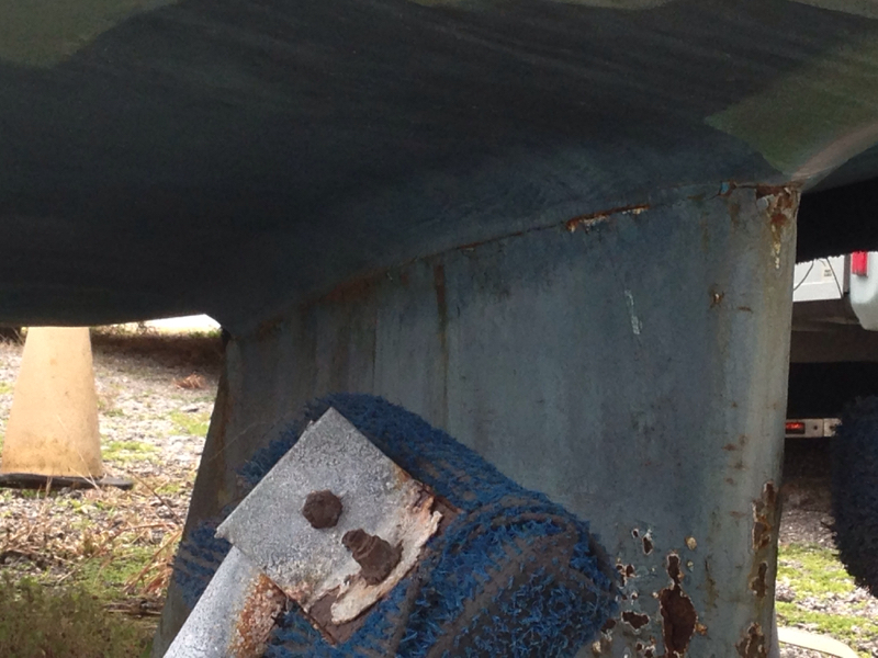

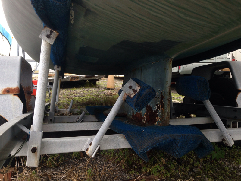

Attached are some of the pictures including one of the keel that i will like the groups opinion. There appears to be a small gap between the keel and hull but IMO should be able to be sealed with not complications.

The keel is a cast iron keel bolted to the bottom of the hull. In between is 5200 marine sealant which is not only a sealant but holds fast the keel to the hull. If the boat is in the water and you do not see any water coming thru around the keel bolts inside, the seal is holding fast. You can clean out a little and reinstall new 5200 on the outside and when dry in 5-7 days, paint over it.

Thank you Crazy Dave, that was my plan after following your recommendation of brushing the keel, acetone and some acrylic then sand it, paint it... That i saw on another post. Do you have the name of the anti rust paint i should use. What comes to mind is this thick brick red color paint but i do not know its name.

Your boat actually looks pretty good, too bad about the water damage inside, but some sanding, or perhaps cutting the table shorter may do the trick. For the outside wood I've recently started using Sikkens SRD Natural (siding rails deck). Its a one step, quite different from the regular Sikkens. It doesn't last really long (2 seasons here up north), but is really easy to brush or light sand for a recoat. I like the golden tint it gives the wood, YMMV.

Like mine, yours had filled with water up to the line on the table. Check all the bulkheads in the storage areas inside, and make sure you crawl back into the storage under the cockpit to check the wood bulkheads in there. Some may have delaminated. Also look at the bulkheads that the side chainplates are attached to - mine had some rot, and one actually cracked under load. Make sure the chainplate covers are well sealed and rebed if needed (I used butyl rubber strips). I was never able to get the darkened color fully out of the teak, despite some light sanding and use of teak cleaner and oil. Check the hose in the anchor locker and also the one from the cockpit drain to the through-hull on the transom - cracks or leaks or looseness there could sink you.
