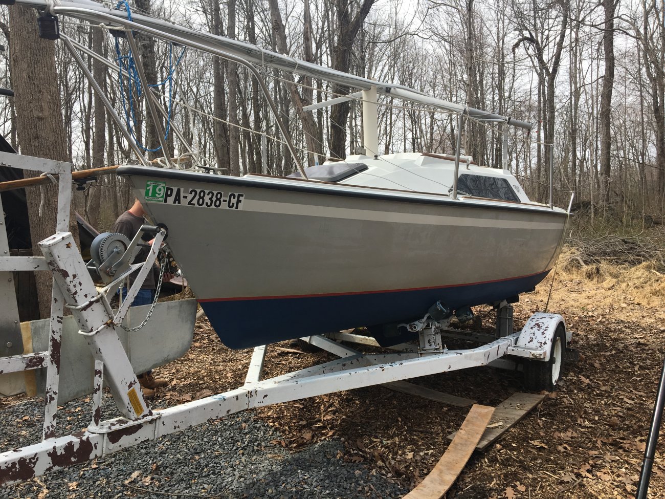

I figure I should put everything I’m doing to fix up my 1988 O’Day 192 in one place so here I go.
So here’s the boat when it arrived to me and some shots from before.

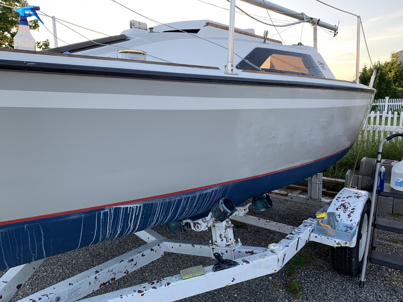

Oxidized Hull

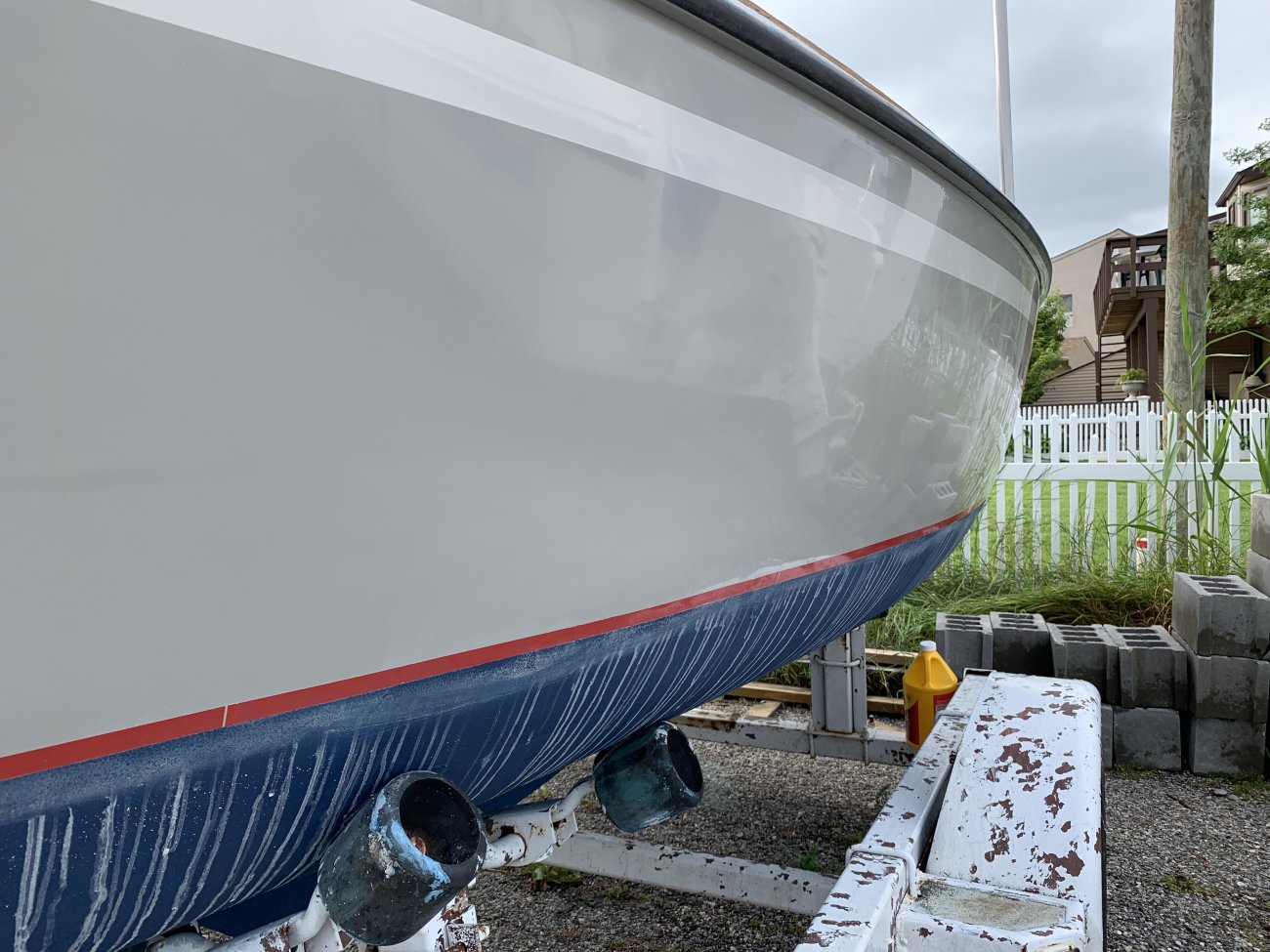

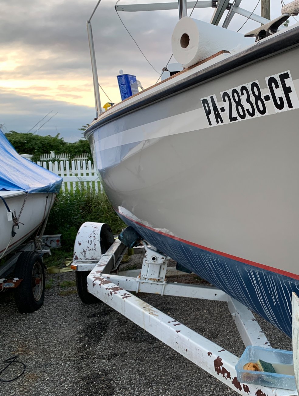

The hull was oxidized all over the place. After some research and checking the boat I figured out it was a failed coating of Poliglow. Took a bit of experimenting to find the best way to remove it but here’s what worked best:
Zep Heavy Duty Floor Stripper
1000 grit wet sand
3M Heavy Duty Rubbing Compound
Presta Polish
Colonite Fleet Wax

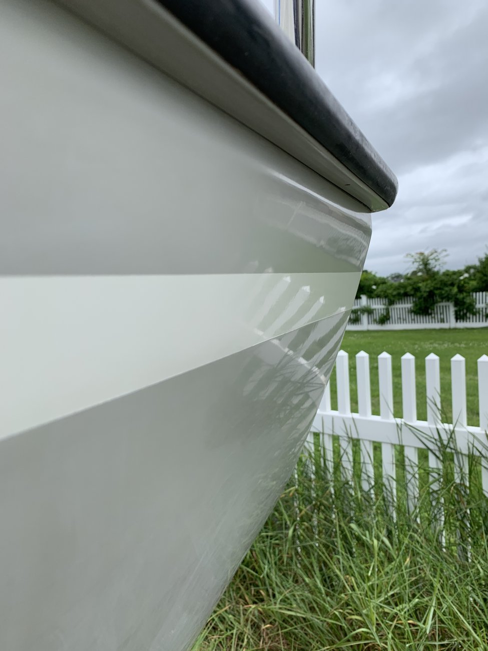

Test area, you can already see the difference.
And here’s some of the progress.
After finishing the hull I had a week of hard rain every day. Killed any chance I had to work but also revealed that there were multiple leaks. So I spent the next week finding and repairing everything I could find. Here’s the spots I found leaking:

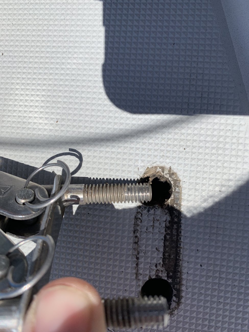

So I cleaned them out, chipped away at some of the core that was exposed, and filled them with thickened epoxy. Since I was already mixing epoxy I figured I might as well just do both sides (port and starboard).
The plan is to drill those holes to the proper size then re bed the chainplates with butyl tape.

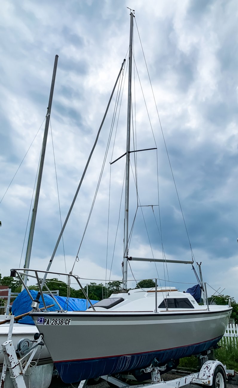

Here’s a shot from when I finally got to put up the mast to see what was going on. Unfortunately, in the process I bent the home made hinge step that the previous owner made. It’s super heavy duty but has very tight tolerances and I was just off enough that I bent it. Going to take the bent step to a machine shop to get repaired hopefully.
With the rig I found that one of the spreaders was bent. RigRite wanted about $200 for a single spreader so I broke out the heat and got the spreader straight again. Just need to replace the sheaves for the internal boom lines.

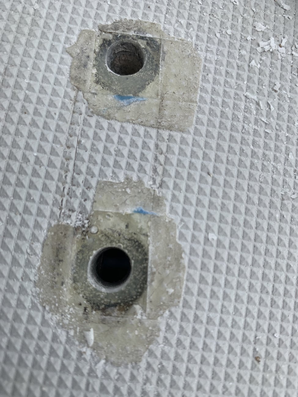

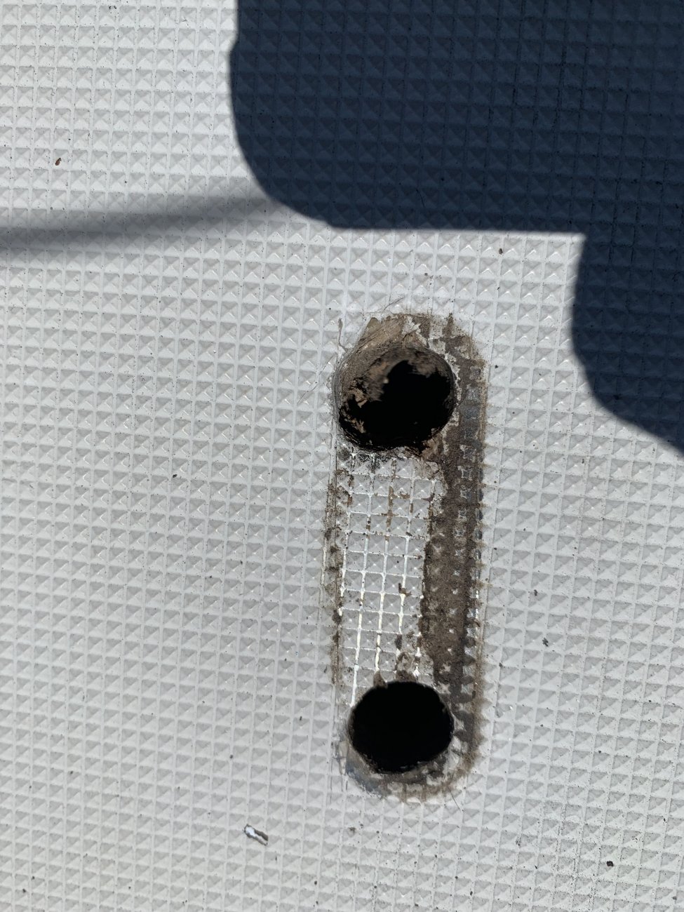

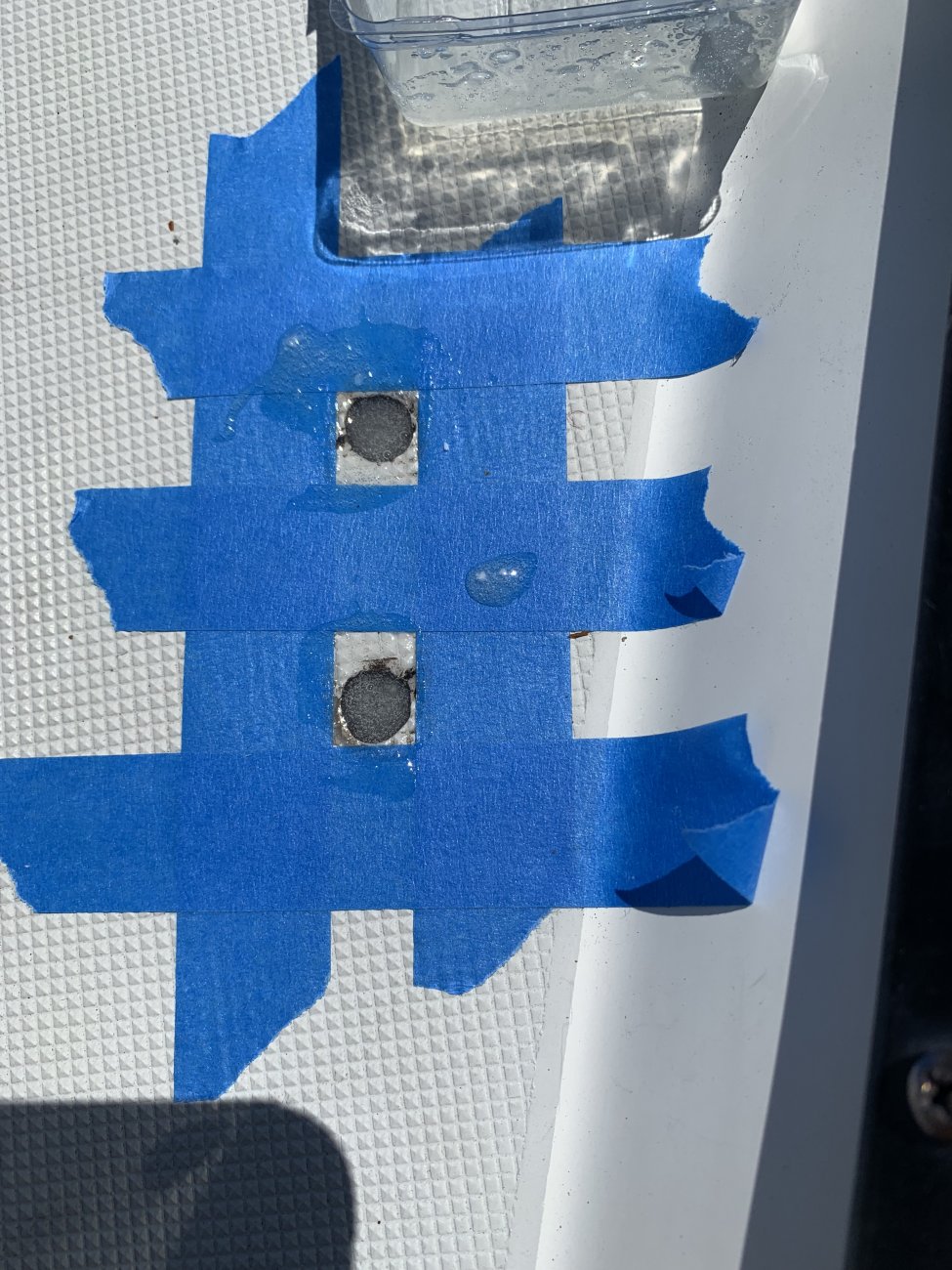

Got the chainplates reinstalled today. In the rush of the yesterday I missed that the masking tape was not fully pressed into the nonskid, so I have a tiny mess. Already cleaned it up mostly today.
But, the chainplates are solid and sealed with fresh Bed It butyl tape.
Before:
After:
Big difference between the size of the bolt and the size of the holes prior to this. Without any sealant around the bolts, water just went straight to the cabin.

For some reason, the bolt holes in the mast step and the mast are too tight, from then factory. The real problem is that when the mast moves, everything moves. I mean the step. So after a while water gets in. I re-drilled the bolt holes in the step and mast. I noticed it after I installed roller furling. Some folks use only the back pin. So if you're bending the mast with the back stay, I'd look at that. Nice boat, nice job.

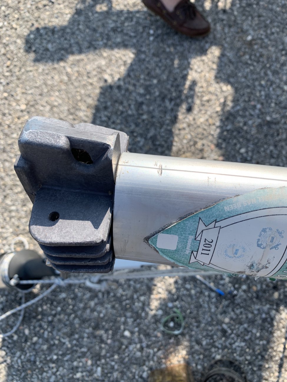

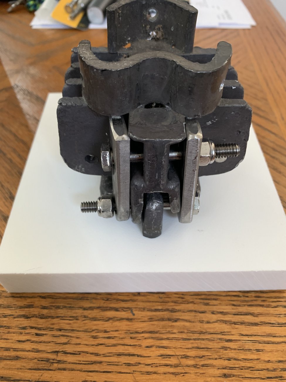

I’m going to rebuild the mast hinge which will mean the next thing I do it to check out the step bolt holes. Depending on how they look I may need to fill and re drill those too.

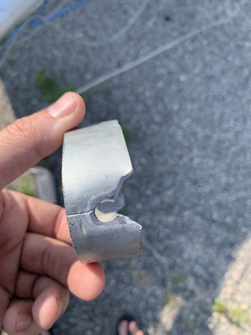

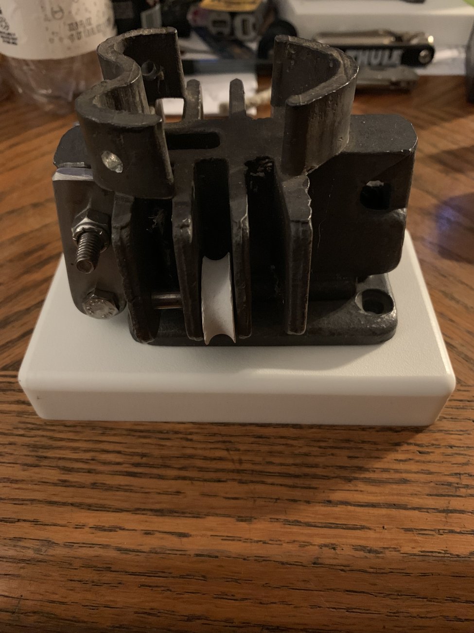

Speaking of mast hinges. After taking the stainless one to a machine shop, I’ve realized there’s no way to get this back into shape enough to work again. So I’m back to square one.
The original Z Spar hinge has a broken tab but it’s being held together quite well with 2 through bolted stainless tabs. I just need to grind down a few spots to get the plates to sit flush. I’m only raising and lowering the mast 2 times all year so I don’t need the best hinge action in the planet.

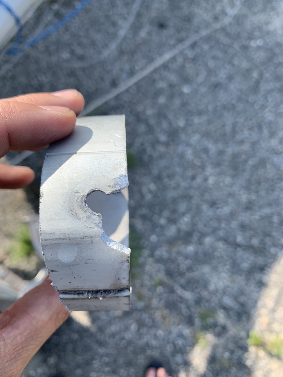

Next problem is that base attachment holes on the mast are shot. Each of the 3 holes that had rivets into the base are cracked. So, I need to get fresh material to rivet the Z Spar base to. To do that, I’m going to cut 1” off the mast and put a 1” spacer below the step to get the original specs back. That’s what the 1” King Starboard is for. This plate will be sandwiched between the hinge and the deck so I’ll have to get new bolts to make up for the extra length. I just need to cut it to size next.

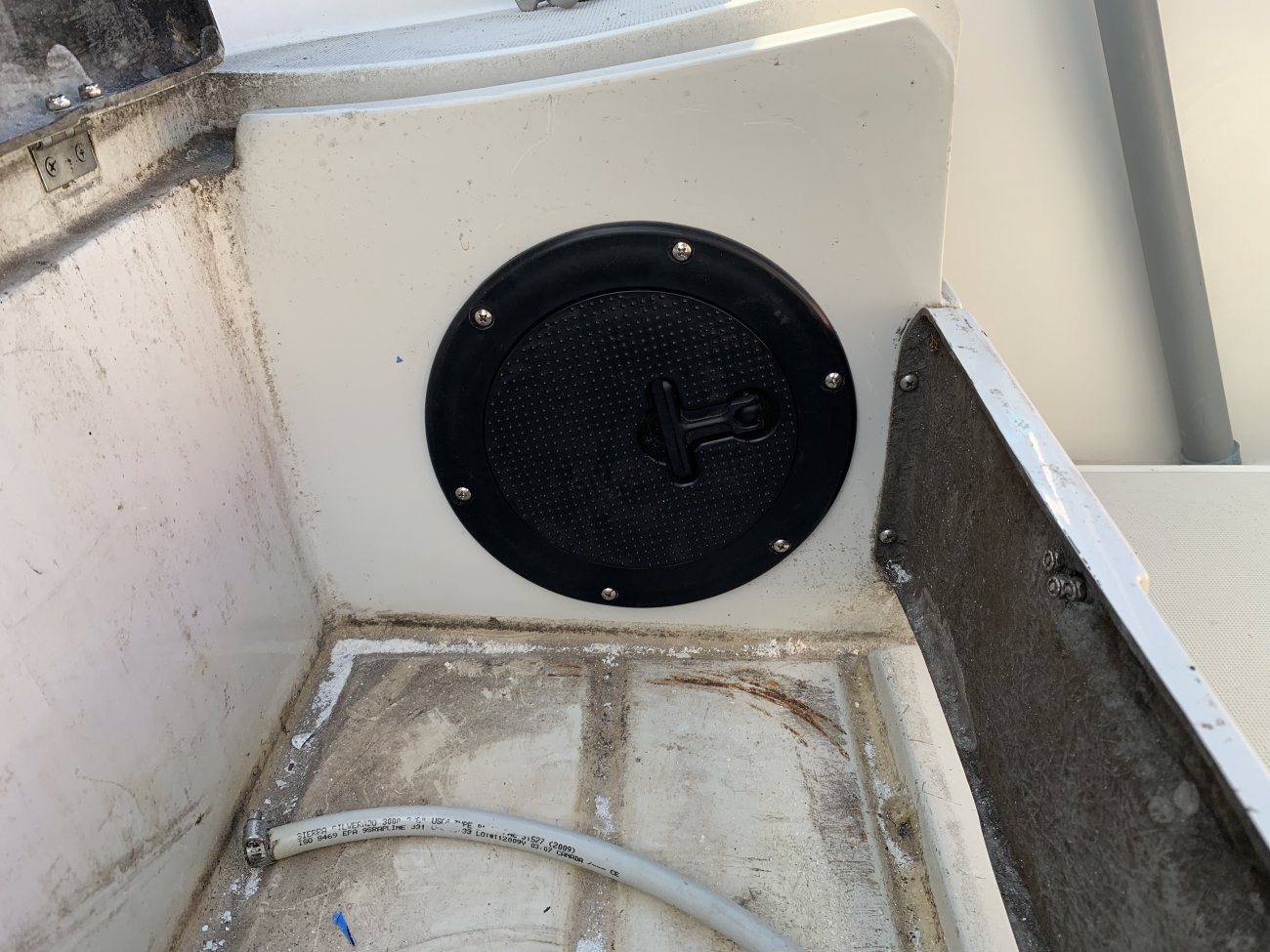

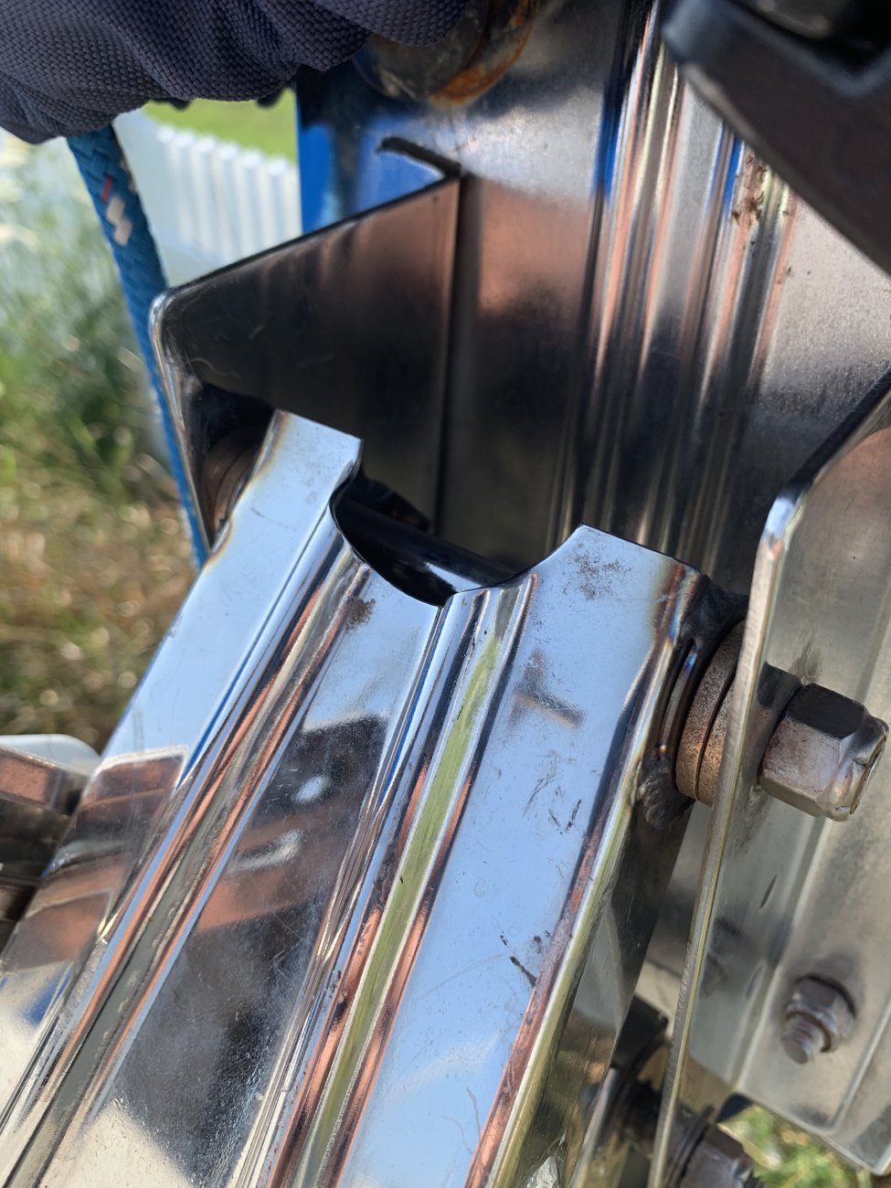

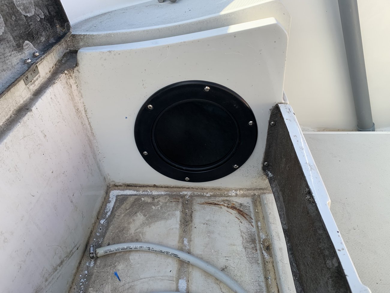

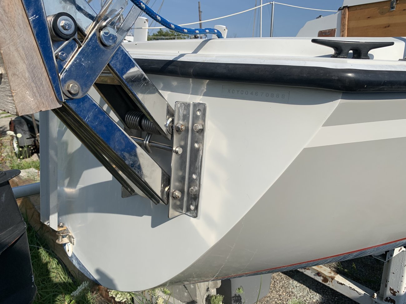

Ok for my next project while I figure other things out, I needed to remove the motor mount. Unfortunately, it was installed on the boat before the deck was joined so there was no access to the nuts holding it. Fortunately, the sealed gas storage locker is right in front of the motor mount so I had a perfect spot to install a 6” deck plate and keep it hidden and protected.
Cut the hole with a skill saw that can scroll and popped the 6” Viking port in. Now that the work is done I can clean it all up.
I’m glad I decided to install the port because even if the motor mount was perfect, one of the 4 nuts holding it to the boat was only on the bolt by about 2 threads. I was able to back it off by hand. Yikes.
I think someone trailered the boat with the motor on the bracket because a few of the pivots are torn up. Tomorrow morning I’ll take it to a welder to see if they can reinforce it and get it back on the boat.
If I had my 'druthers, and needed to change my mount, I'd replace the stock old skool aluminum Garelick with a swanky new Garhauer available from Catalina Direct: https://www.catalinadirect.com/shop...board-motor-mount-two-spring/?SearchResults=1 Well, actually, I might call Garhauer up, and see if they might sell me one direct for a bit lower cost. This Garhauer is pricy, but it is made of stainless steel, and has a very nice handle and action. It is spec'd as standard equipment on the Sage 17 from Sage Marine.
This would require fabricating a new wedge pad to accommodate the wider mount points of the new Garhauer.
As it is, my original aluminum 2 stroke Garelick mount, as much as I don't like it, is still very serviceable and seems to hold my 5 hp 4 stroke motor just fine. And I'm trying to remove items from my project list. One of these days I'll have the boat to the point where spring commissioning is only a matter of polish, wax, and splash!

Whatever mount is on my boat is stainless stainless steel. Not sure who made it but it’s survived 30 years so far. I took it to a local welder today and had them fix the broken parts and reinforce it a bit. Plus I added some brass washers to smooth the action out and take up any play in it. Works like new again.
Before I put the mount back on the transom I wet sanded, compounded, polished, and waxed.
Total repair cost was $40 for the welding and $5 for some new hardware. Forgot to get a before picture but here’s everything buttoned back up on the boat.

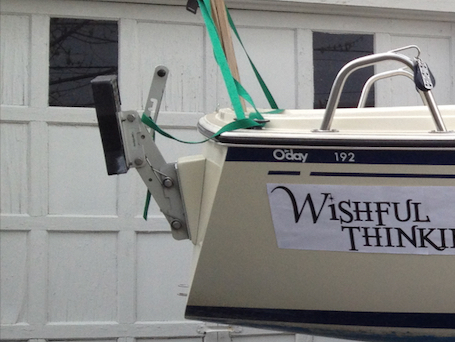

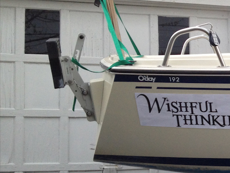

That mount is not the stock one typically sold with a 192. The stock mount included an angled fiberglass pad between the mount and the transom, to accommodate the angle caused by the curved transom, and by the reverse counter of the transom. From the little bit I can see of it in your picture, it looks as if the wood motor mount pad has been shaped to accomplish some of this angle correction.
Just for fun, here's a pic I found when I was mocking up the name for my boat. It shows the original aluminum Garelick 2 stroke mount and block. I've seen other guys here make a new spacer block for a wider 4 stroke style mount.
That setup makes more sense but if this isn’t the original motor mount from O’Day then I have 0 clue how they could have installed it. The nuts and backing plates are inside the hull but until I put the inspection port in, there was literally no way they could have been put in without the deck off the boat. I did try to wiggle myself down from the quarter berth but got stuck about half way there and I’m not a big person.

Oh, yes, you know, your boat being a grey hull is newer than my boat. It's likely they used a different mount, given that it was closer to the end of the production run.
In all the discussion of replacement mounts, the only way I know to do it is to add an inspection port into the back of the fuel locker as you have done to get access to the bolts. I think I removed the starboard quarter berth plywood panel once, and there's no way to get past the fuel locker molding.

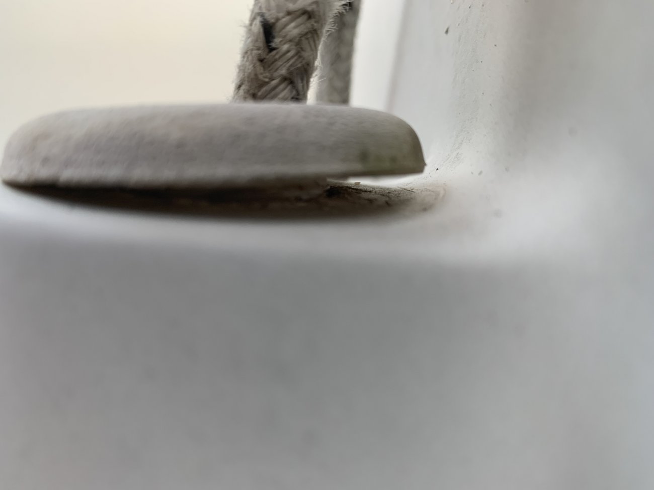

After weeks of tracking down leaks and fixing them I finally left the bilge cover on for a week. While working the other day I popped the cover off for fun and almost had a heart attack - it was full again.
So I dried it out and began the search for anything I could have missed. As I was going back into the cabin I looked down at my centerboard line and noticed the through hull fitting looked a little funny. So I laid down in the cockpit and looked closer to see this:
Today I went back with a gallon of water and had someone pour it on the fitting while I sat in the cabin and watched the bilge. Sure enough, I got a good trickle coming down the tube straight to the bilge.
So I backed the fitting out and snuck some butyl tape in there and tested it again. Passed the test perfectly, tomorrow it’s supposed to rain hard so that’ll be the true test.

Next up, time to cut the mast to get to some fresh material to rivet to. Getting so close to being ready to launch.
GSBNY
May 9, 2019
138
O’Day 192 New York
From this:
To this:
Since my 1” spacer arrived I could verify the thickness and cut the mast today. Got a good measurement on the mast and cut it with a hacksaw so I could go slow and keep an eye on it. Came out square and cleaned it up with a file to take the burrs off. The original step slipped right in.

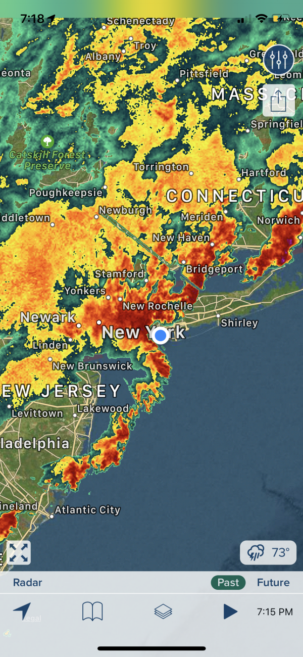

Before I could do anything else this ended up happening so I had to pack it in and head home.
At least it will be a good test for all the leaks I just fixed.

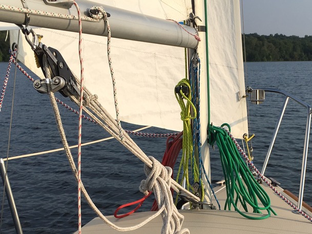

I would not terminate the vang at the deck. It should be free to pivot at the same point as the gooseneck, otherwise it will effectively prevent the boom swinging outboard, because as it moves outboard, it would tighten and pull the boom down. The Star uses a curved track on the deck so that the vang maintains the same downwards pull on all points of sail. My Force 5 has vang rigging slightly behind the gooseneck pivot, and I often need to release it some to let the boom out.
Vang on my 192 is rigged to a bail through bolted through the mast. The downhaul purchase is also rigged through this bail. It's not completely ideal as there needs to be some tension on the vang and the downhaul to hold that bail up.
Not the greatest picture, as I had to crop it down a lot, and the hatch is slid forward, but you probably get the idea. Yellow line is asym spin halyard.

Worded that wrong, the vang will be attached to the base of the mast like yours. I’m not sure if I want to install a bail like yours has or if I’m going to attach it with a spectra loop.
