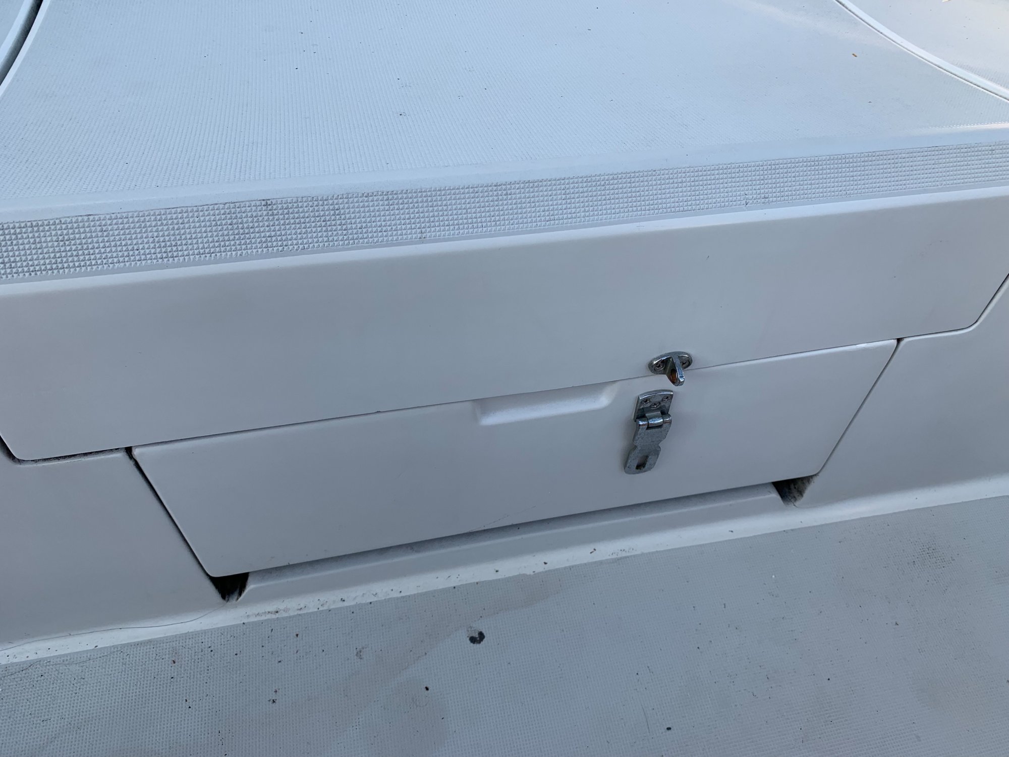

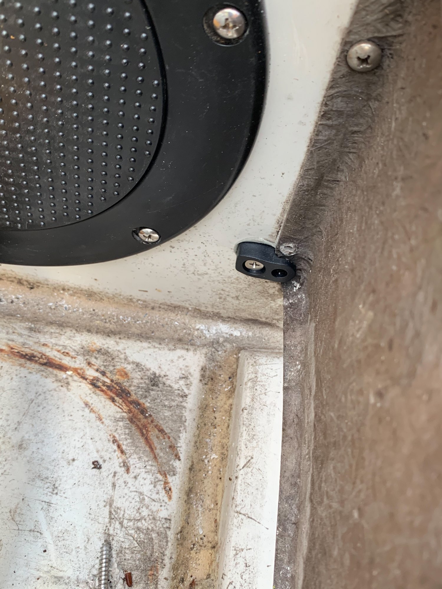

I keep my 5lb propane tank in the gas locker in the cockpit. It works great but there was a tiny problem - the propane tank line end didn’t fit through the opening in the locker. That would mean I would have to keep the top of the locker open to have the tank connected to the motor.
So, I took a peak at the locker wall and realized the outer wall was just screwed in with 4 screws. With the bottom 2 screws out the panel hinges outward and gives me plenty of space to pass the propane line through. Then I can just push it back into place and keep the locker hatch closed.
Now that it could swing out, it could also swing in and that was another issue. My concern would be trying to brace yourself and the panel giving way. So I made a backstop that’s bolted through the hull with some butyl tape and a big neoprene washer.
Now I just need to clean and detail that locker. Another perk of propane is no spills or leaks to clean up.

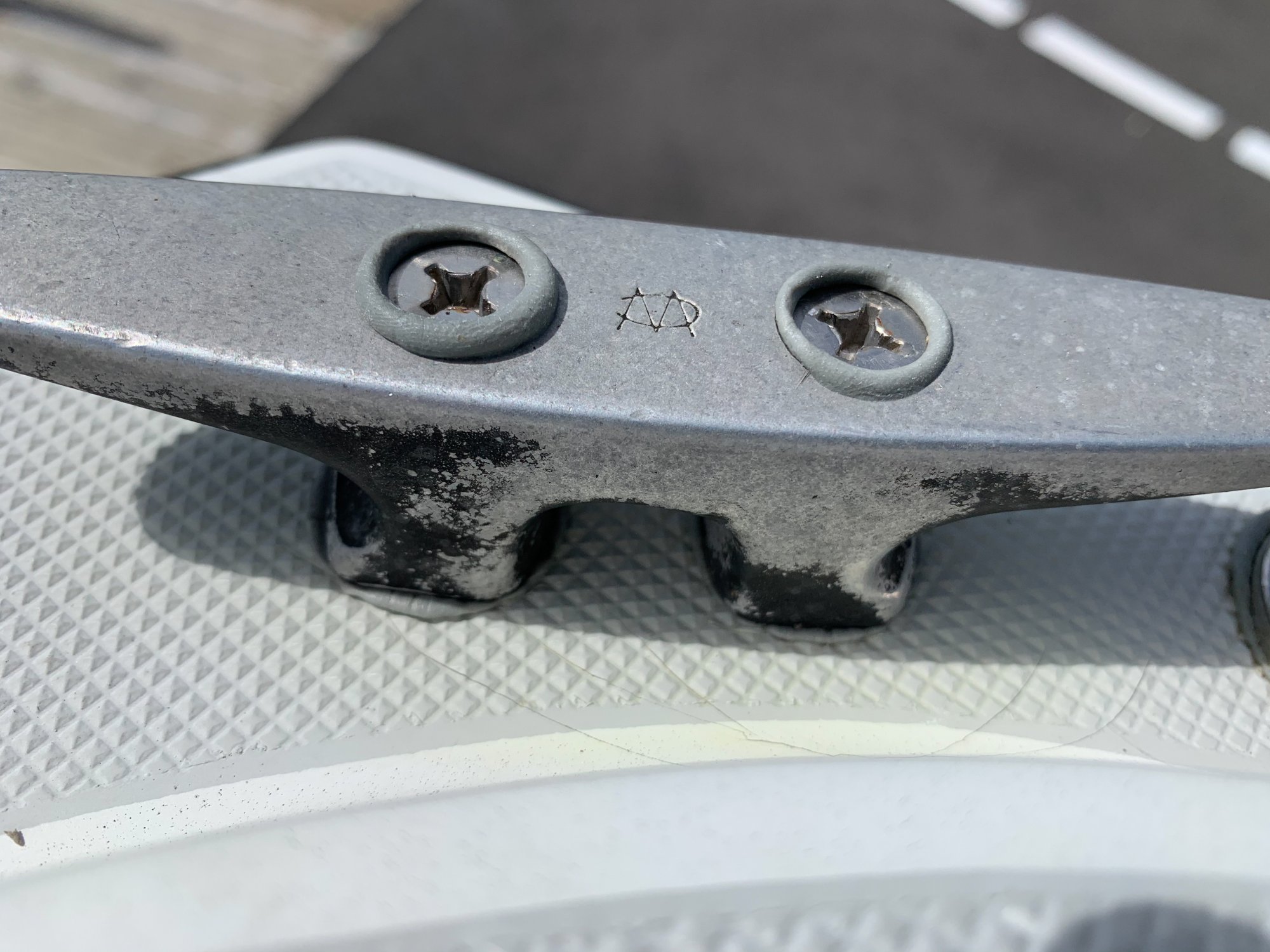

I had the Navionics running when I hit bottom and according to them I should have been in 3’ of water. I think I’m going to change out my knotmeter for a depth finder over winter.
This is the cleat you want for the rudder downhaul.
I’m also going to put a rudder uphaul on over winter as well.

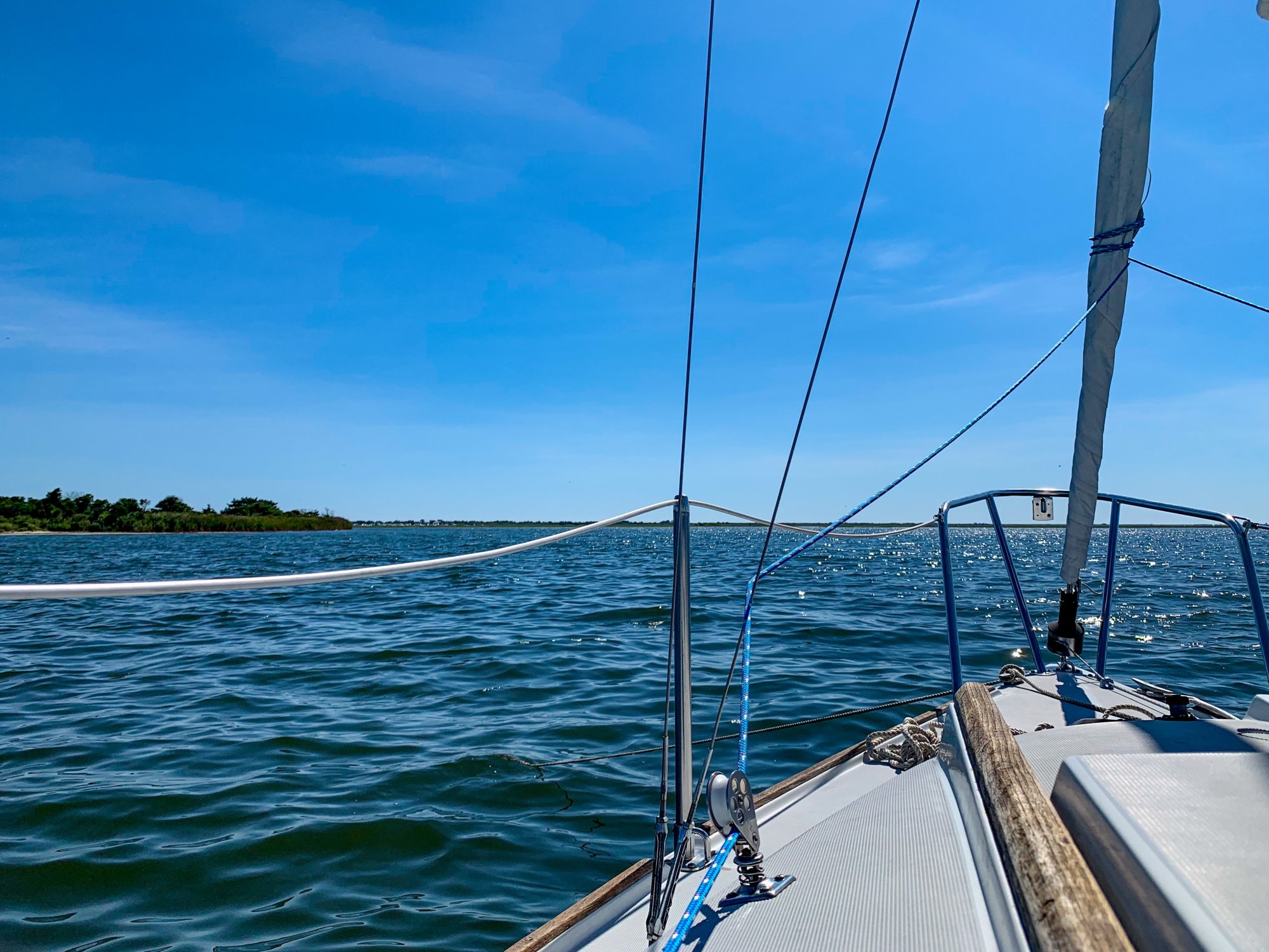

Still figuring out some work to do over winter. The furler line runs right over the corner of the starboard window and is rubbing a groove in it. I’m thinking I need to change out the horn cleat with a short spacer and cam cleat to clear the window.

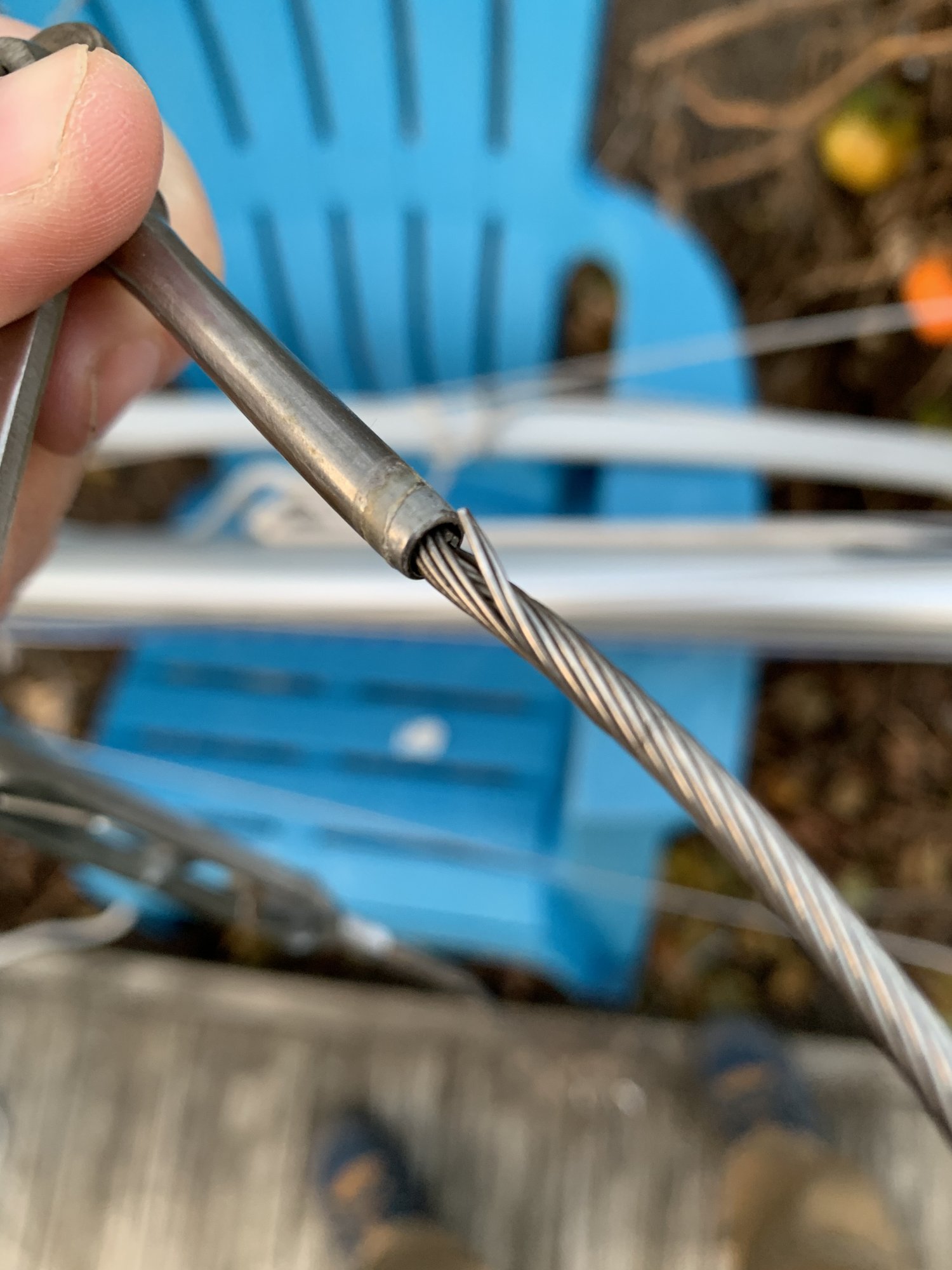

Earlier in the season I discovered my lower shroud, which was wrapped in tape, had a bunch of broken strands. The other lower and the short pigtail on the back stay had tape on them as well but I decided to leave it since there was no other signs of a problem. With the rig down, it was time to remove the tape. The other lower was good and surprise surprise, the backstay pigtail has busted strands in it.
My winter projects will definitely include making all new standing rigging. Fortunately I have all the wire and turnbuckles and a swage machine at work. I just need to track down the weird hook terminals that Z Spar used on this rig.

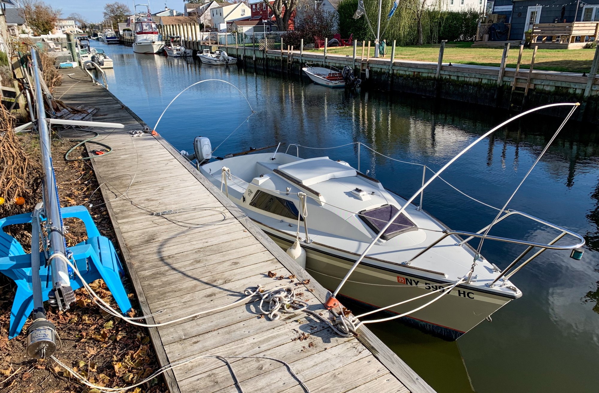

So I made a small mistake and left the mast at my house when I brought the boat to the storage yard. I need the mast to tent the boat cover so i had to get it there and on the fly this was my solution for the 5 minute drive through town. Luckily I somehow made the drive and didn’t pass any other cars on the way which was very lucky because the mast was maybe a bit longer than my car....

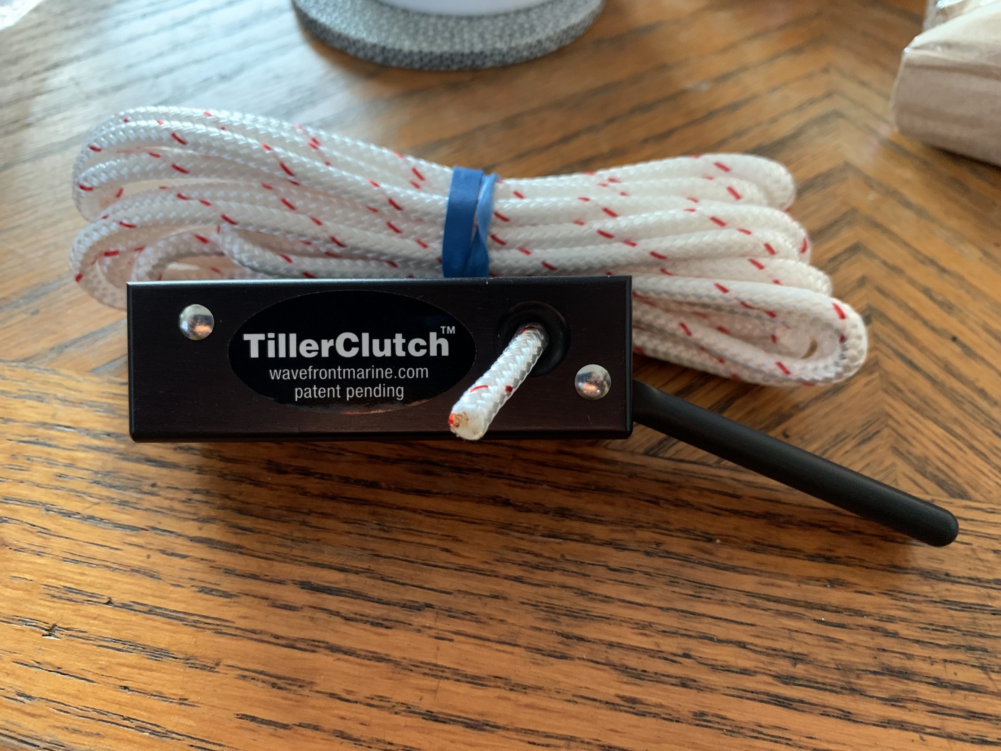

For Christmas I picked up a Tillerclutch. The Davis tiller lock was already on the tiller but it was showing it’s age and falling apart so time for an upgrade. The clutch is a quick on / off flick and should help with single handling next season.

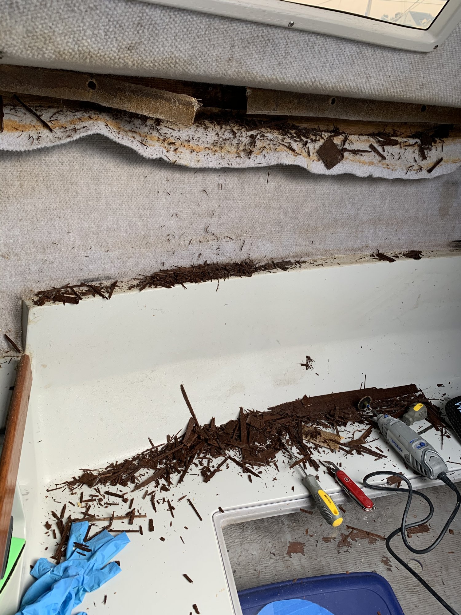

Well, NY has allowed marinas and boatyards to reopen so back to working on the boat I go.

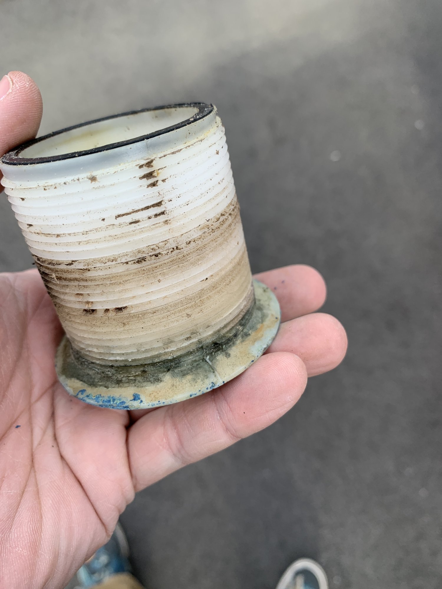

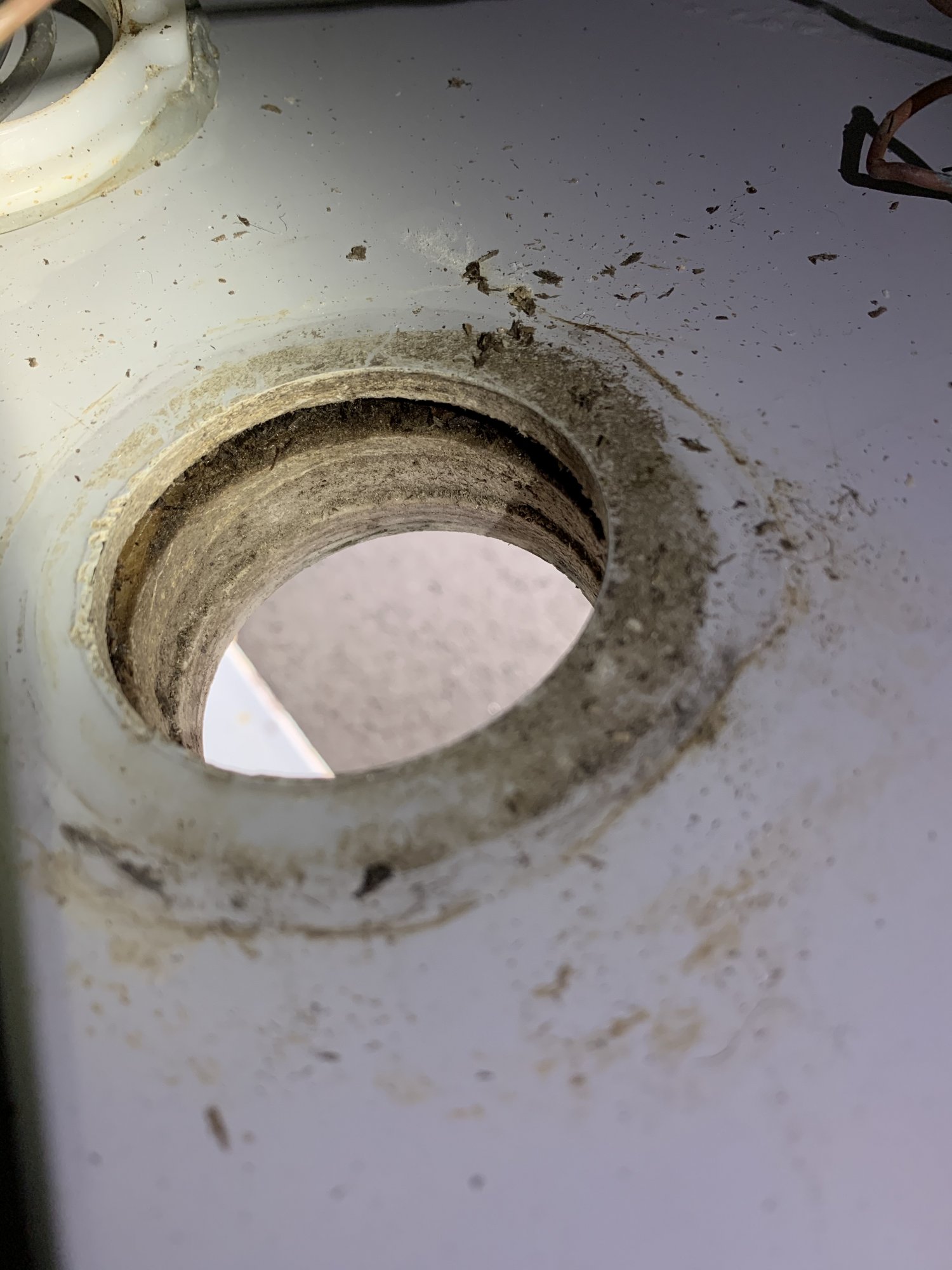

Last season I had a slow but constant leak coming from the paddle wheel for the knot meter. I couldn’t fix it with the boat in the water so I had to wait until now to make the repair.
I grabbed the channel locks to take things apart and after about 1/8th of a turn it all came apart by hand. The thru hull literally fell out of the boat once it was loosened. Why did it do that? There was 0 sealant on it.
Because of the lack of sealant, water came in and soaked the thin wood layer in the liner core. That wood became spongy and no matter how tight I tried to make the fitting last year, I was just compressing the wood more and essentially doing nothing.
Here’s what it looked like after I removed some of the wood core. You can see the void where it was.
Fortunately, the core for the hull is foam and it’s dry and solid. Now I just need to decide what to next:
1) Close up that thru hull hole for good. The knotmeter is broken anyway.
2) Rebuild, reseal, and properly reinstall the paddle wheel thru hull and leave it there as an option for future knotmeter or depth finder.
3) Make it a thruhull with a seacock that I can hook up to some sort of emergency bilge pump if need be. Really just thinking out loud with this one, I don’t have a hull drain anywhere or a bilge pump so it could be an opportunity to add one.

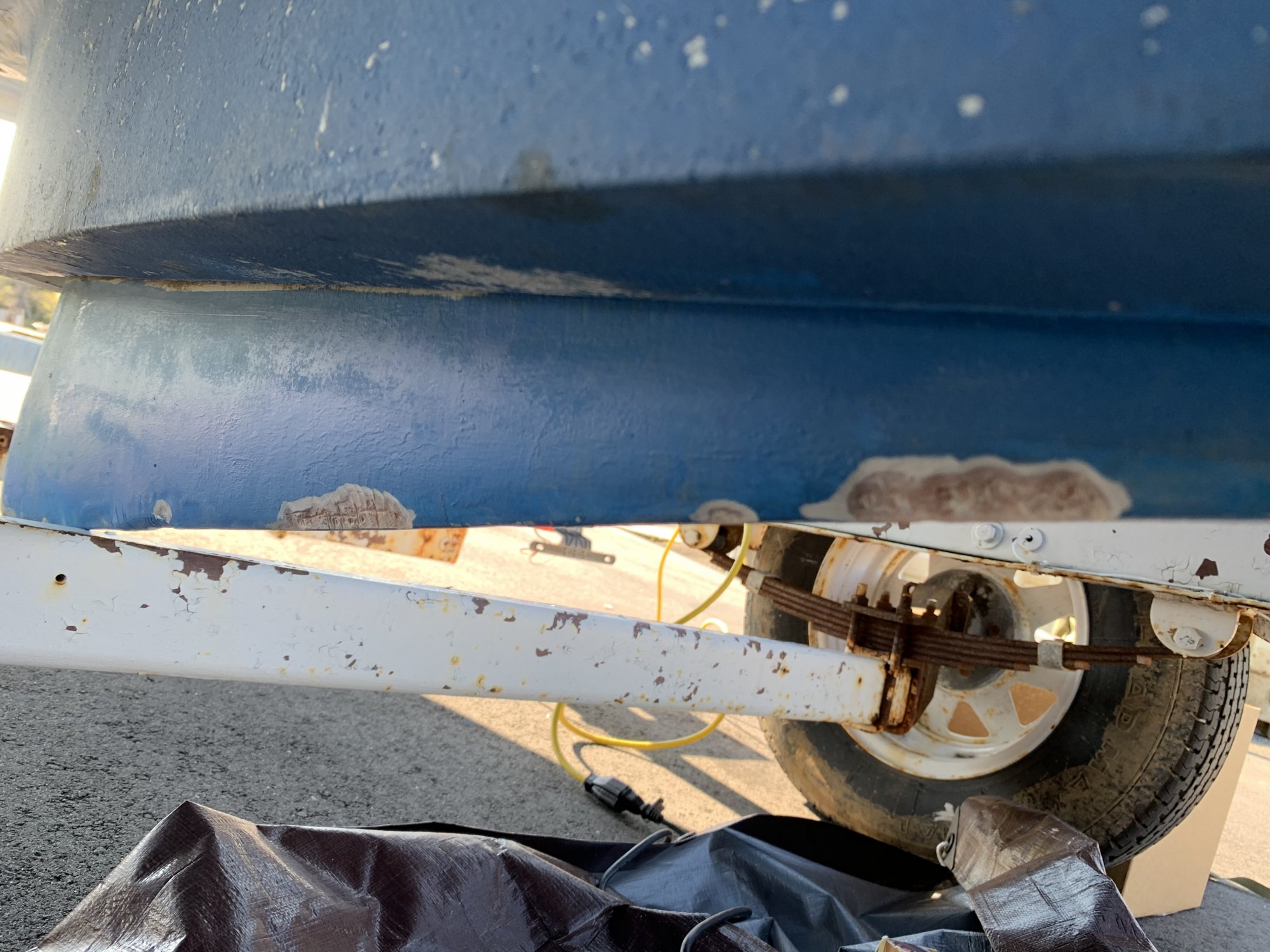

The centerboard ended up looking like swiss cheese, most of the leading edge was gelcoat blisters (voids) that popped open, there were big 1” x 3” voids in the front and rear ends of the trunk as well so I spent a few days grinding and filling them all.
During this repair, I found about 10 blisters on the hull along the waterline as well so those got ground out and filled as well.
I forgot to take an after picture but all I need to do is bottom paint and that’s all done.

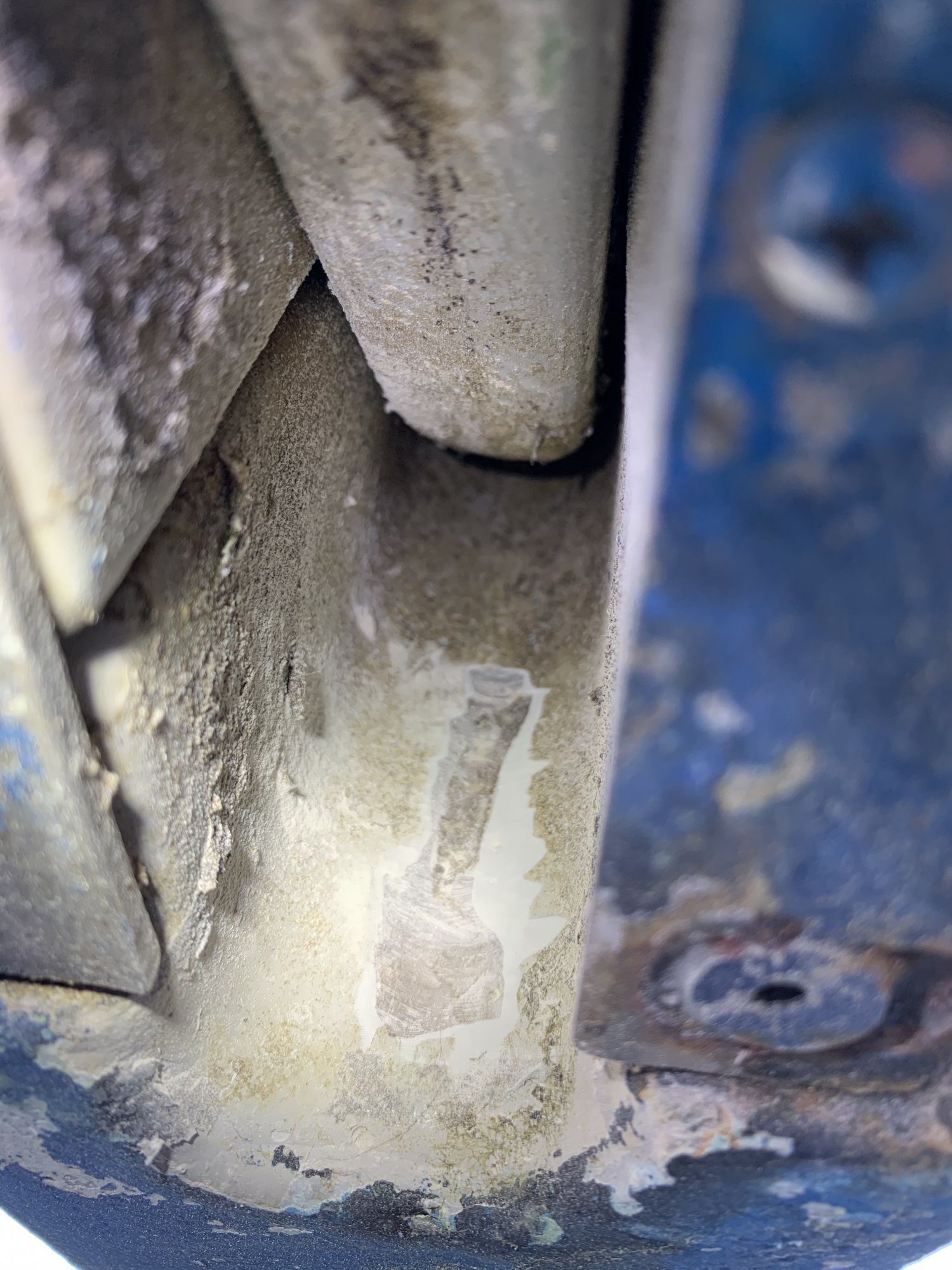

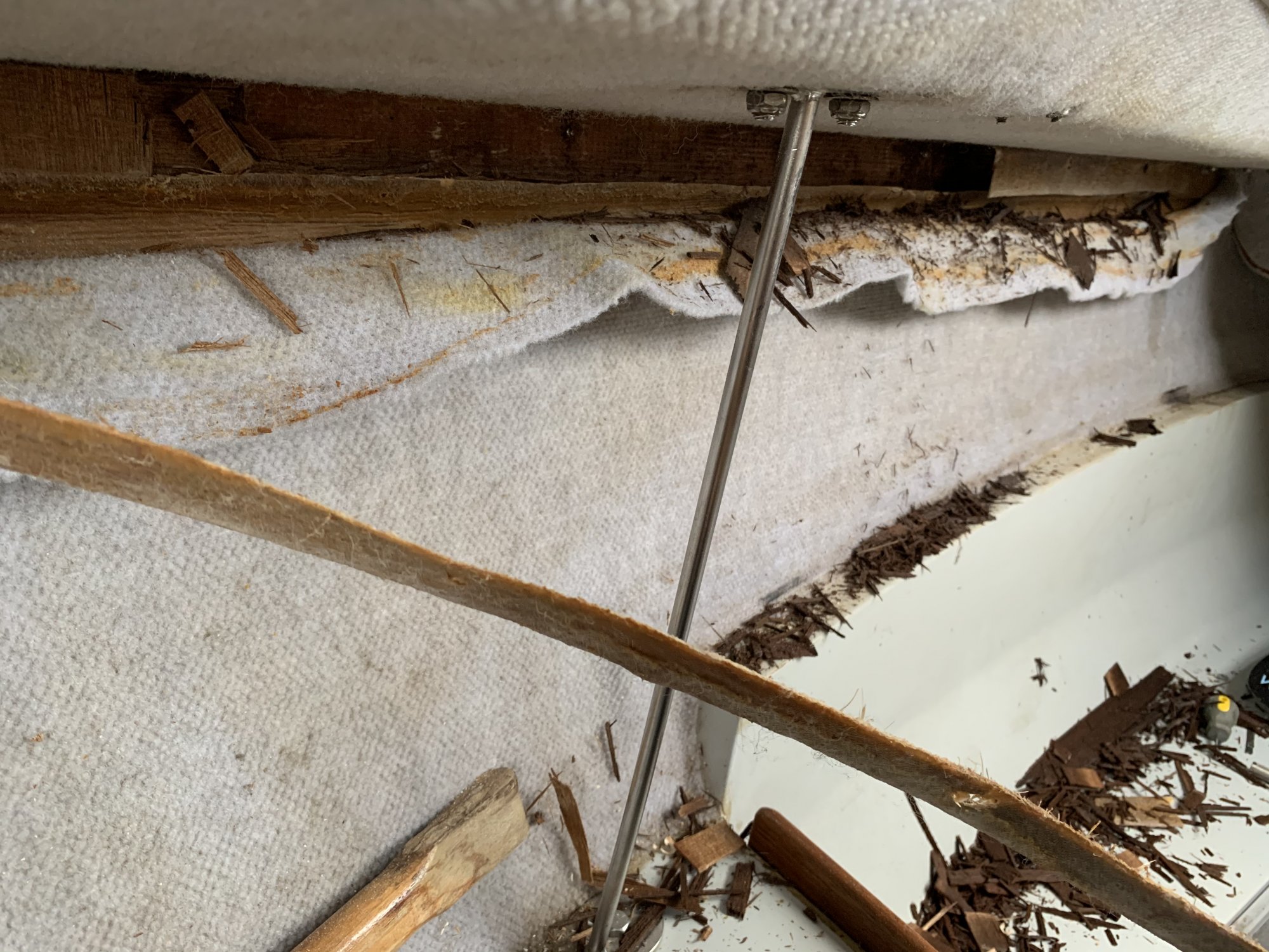

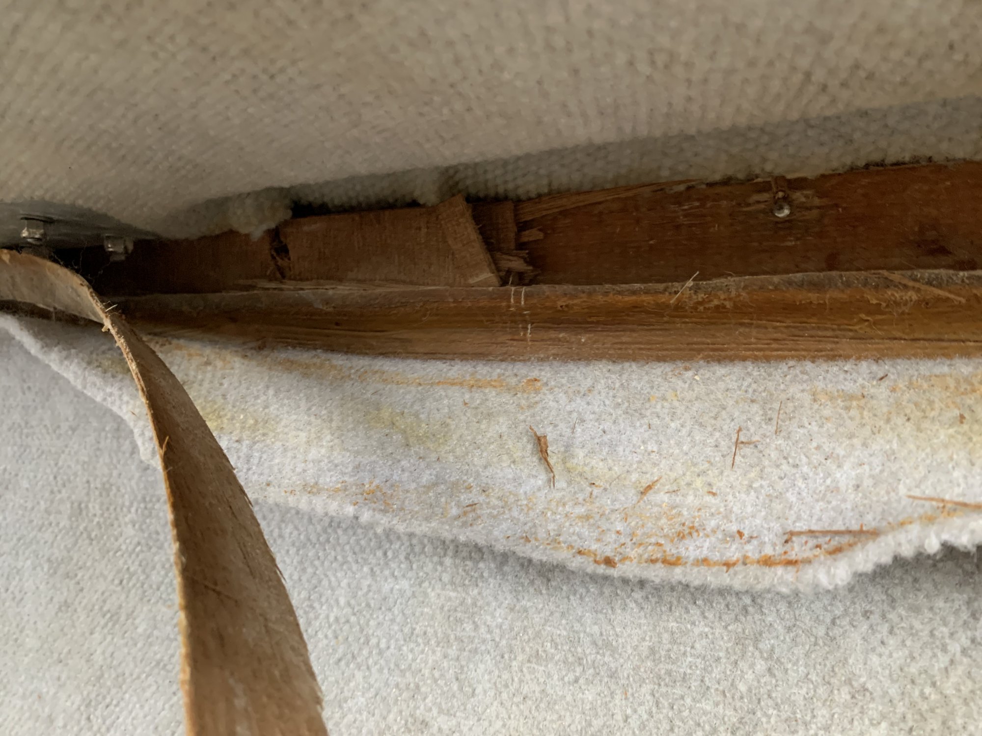

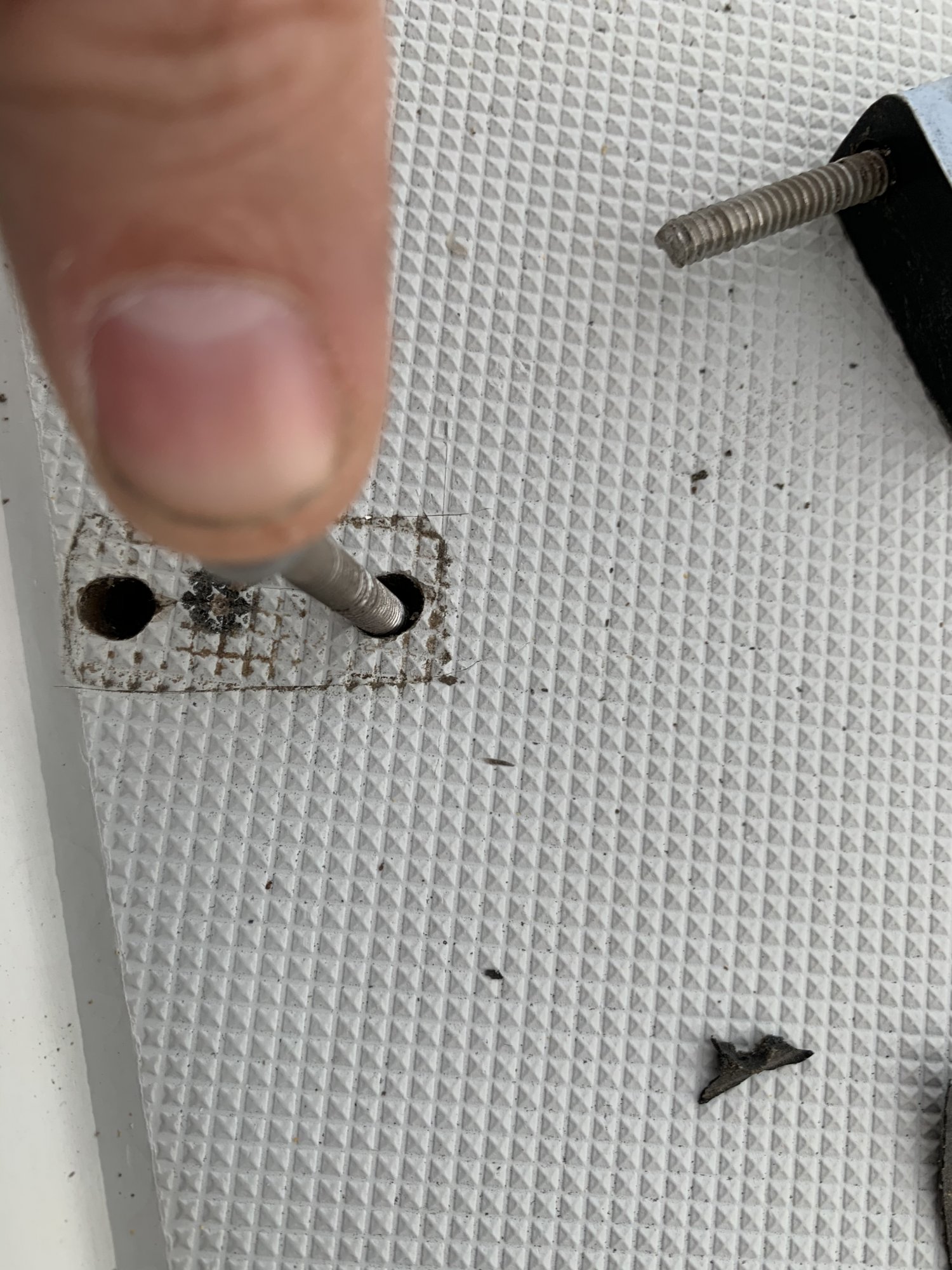

In my never ending hunt to track down the leaks, I’ve found another. Here’s a peak

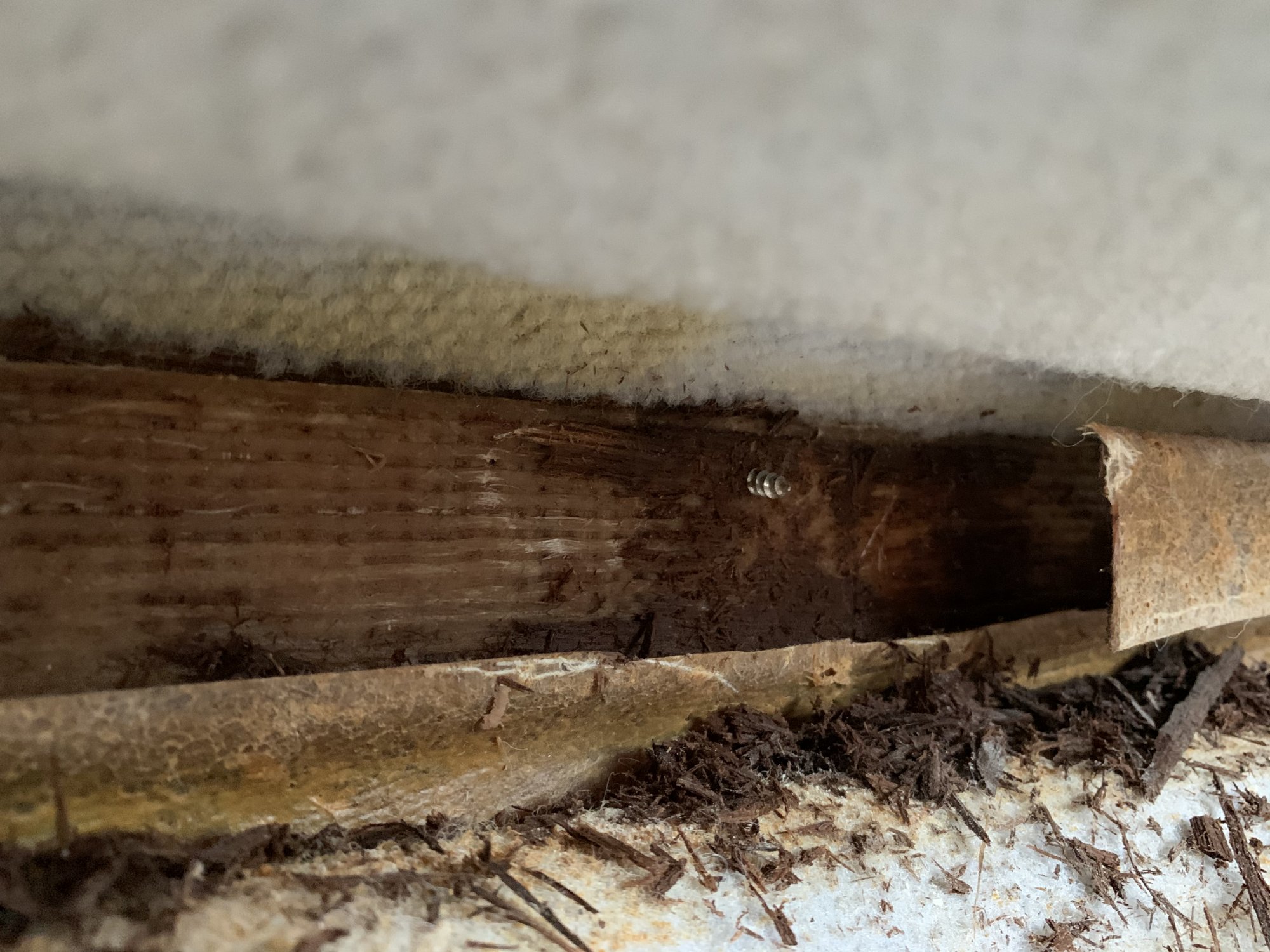

I recently discovered that water was getting into the cabin along the hull deck joint, so I went exploring. Behind the starboard fuel locker I could see the end of a wood strip in the hull deck joint. That wood was soaked and delaminated badly so I figured it must be that bad for a while. Well it’s rotted from the chainplate all the way to the stern.
I really didn’t want to mess with the rub rail due to the high chance of breaking 30 year old brittle vinyl so I went from the inside. I cut the fiberglass over the wood into a strip with a dremel and dug the wet wood out, stopping at some decent wood
During the process, I made 2 other discoveries.
#1) The furler deck fairlead bolt holes were a few sizes too big.

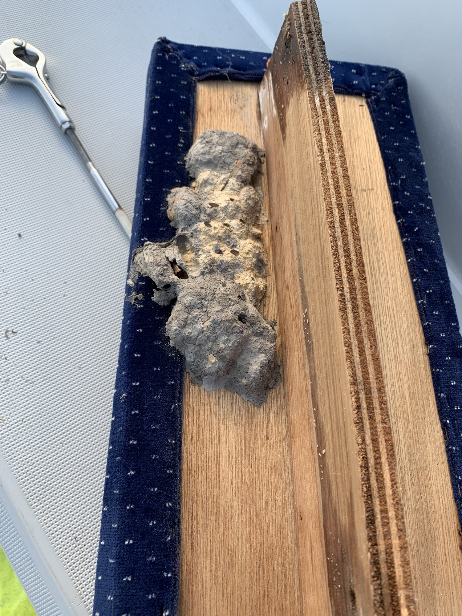

#2) My boat was previously owned by mud daubers. (Notice the wet corner of the back rest that was under the leak)
